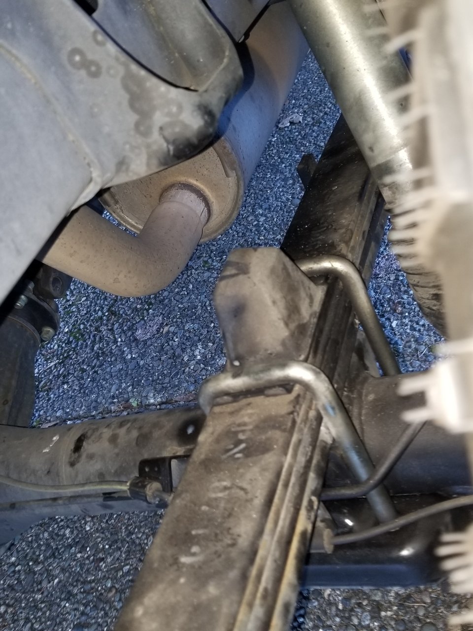

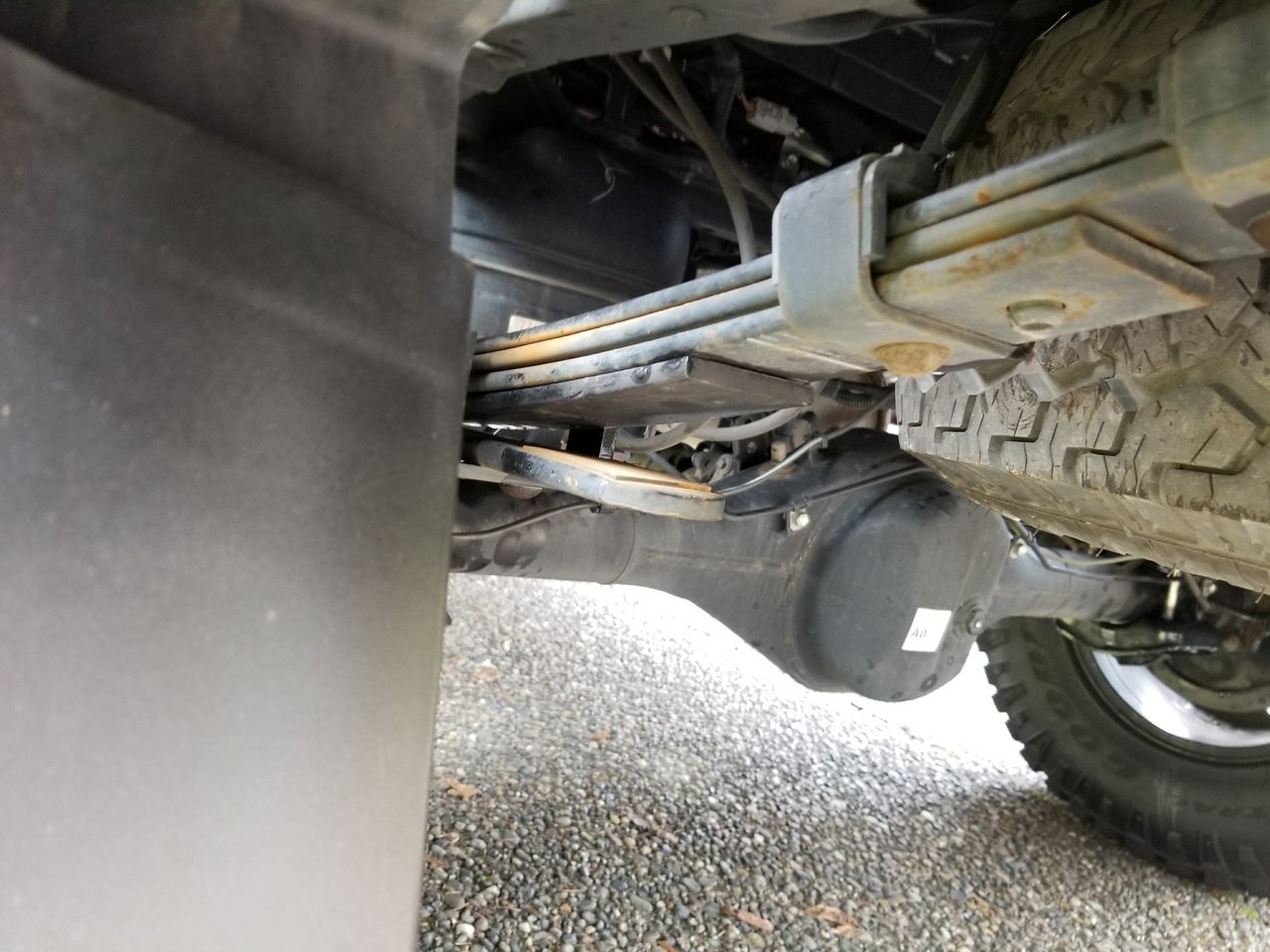

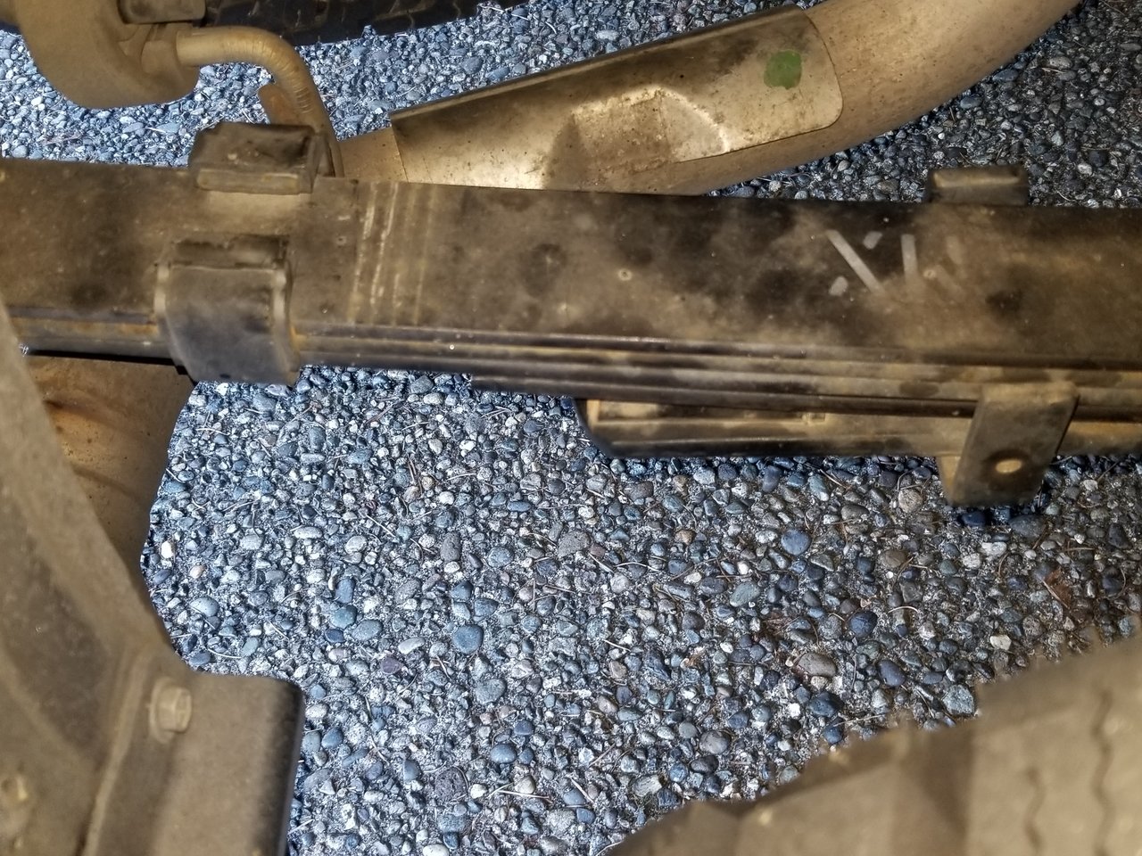

    Yes, mine was a single leaf added to each side with new center bolt included. The skyjacker box says is 1.5-2" inch but I put it right at about 2" of lift on both sides and I left the OL leaf in. Here is not some of the best pics but its what I have to give you on short notice. Keep in mind, my truck is sitting at least 45 degrees in an uphill driveway. I think it is sitting pretty good and all these pictures including the ones showing the OL rubber bumper spacing are with most of the weight transferred to the rear of the truck due to the driveway. Looks about the same on a level surface about 37" front with post AAL with OL about 38" rear.
    The AAL leaf is the one right above the OL leaf that has the straight ears (factory I didn't bend those or cut anything) which holds my added AAL perfectly.
