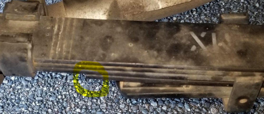

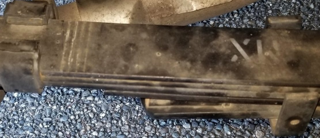

    I think I had to leave the OL leaf in place for my application since I added a single leaf on both sides with no brackets on the new leaf and it isn't long enough to reach the ones that others are having to cut and grind. The OL leaf has the U shaped open factory bracket (the one that is not folded over from the factory) which the new leaf I installed sits on top of the OL leaf using the open U bracket to keep it straight. I don't see how you would install what I did without leaving the OL leaf. Worked out perfectly for my application since I didn't plan to remove the OL leaf anyway.
    Notice the leaf that I added is right above the OL leaf and doesn't reach the rear folded over factory clamp but the open clamp on the right which is riveted to the OL leaf is what my new leaf and the other leaves are sitting in to keep everything lined up. This is why I didn't have to grind or cut anything since it doesn't reach those closed clamps like other AAL do I think.

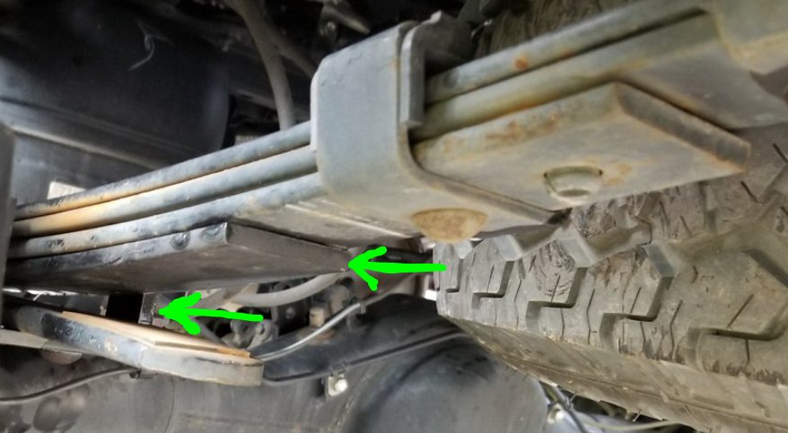

    Below green arrows show the "open" OL leaf U shaped bracket and the leaf I added for another view:

    The new AAL pack has brackets on either end that holds the OEM leafs in place. In the pic below you can see them just outside of the OL brackets. These are the HS 3-leaf, not sure of other brands.
