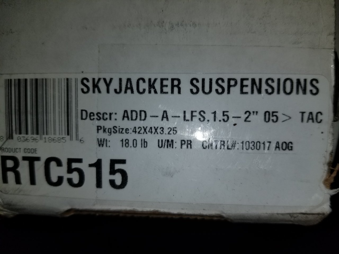

    The site I got mine from must not of added the addition Tacoma years then. That is the exact model number I got for my 2014: RTC515 for $108 which comes with two single leafs and two center bolts with free shipping currently. They have others that have tips if you are worried about squeaking but I don't know anything about the others. Like I said, my leaf packs don't squeak so I didn't even think about that when I ordered.
    http://www.sdtrucksprings.com/index...4&make_select=654&model_select=8688&x=62&y=10

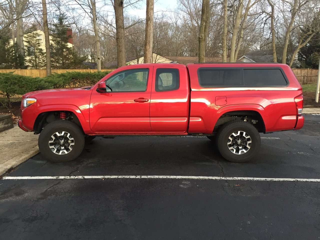

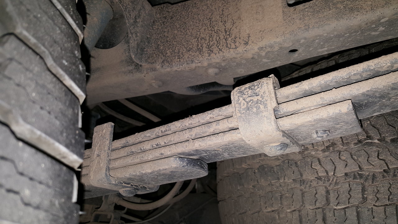

    I got my cap installed yesterday, i think im going to end up with an AAL by summer.4B05ABD0-55F8-43E6-8712-13D40CC903B4.jpg
    As of now, I still have rake, but i can see that changing knowing how tacoma leaves are.

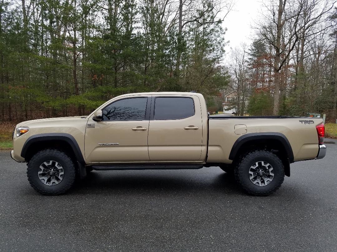

    Here is my truck with the same setup

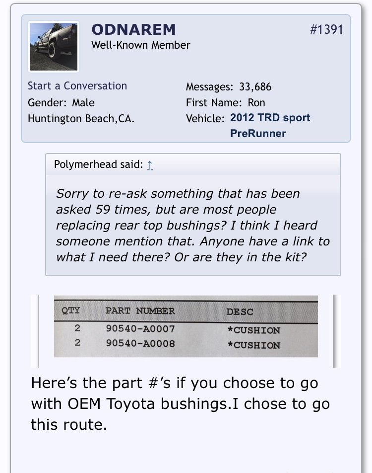

    what was the part number for the replacement rubber washers that goes on top of the shocks? Don't recall what page that was discussed!
    Age315 likes this.

    sxe4533[QUOTED] likes this.

    I'm liking the 10$ rancho's off Amazon! Toyota part number don't pull up on there to see the price diffrence! But it' just some bushings should be good to go!

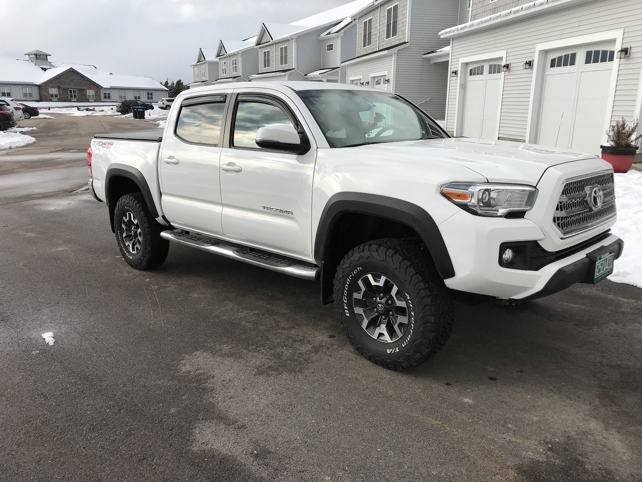

    Before: DSF 20.5” DSR 22”
    After: DSF 22” DSR 23”
    Used 1” Toytec block in the rear. I already had them from a previous project I never got done. Drove home 15miles I really like it. It is harsher on very small bumps, but much nicer on bigger stuff like potholes.
