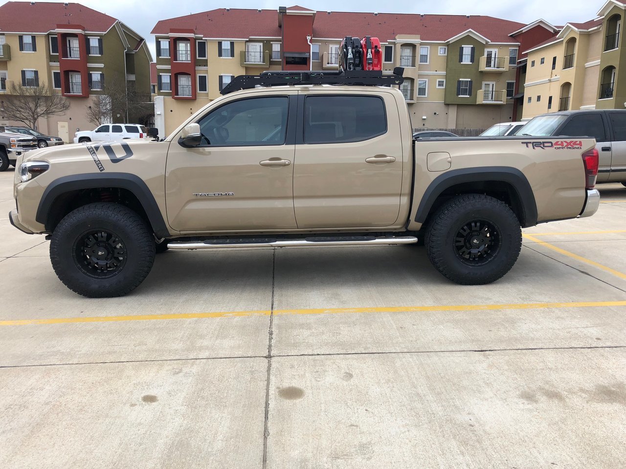

    I finally had time to take a a side picture. Had my suspension, tires, and wheels done earlier last week.
    Tires: 285/75R16 (33s) Toyo AT2
    Wheels: Pro Comp 5001 Series 0 Offset
    The front sits a little less than 1/4 higher compared to the rear.

    Did you have to do anything to get those tires to fit? Spare?

    I measured everything out and the minimum rubbing was 0 Offset in size 16 with 4.5 backspacing. It barely rubbed at full lock, but I overland so I had CMC done (not a lot of material was taken out) and just took a heat gun to the inner wheel well and pushed the trims in a bit. No rubbing anymore (I did a flex test with a forklift) and can't even tell the CMC was done cause I only had to take very little off.

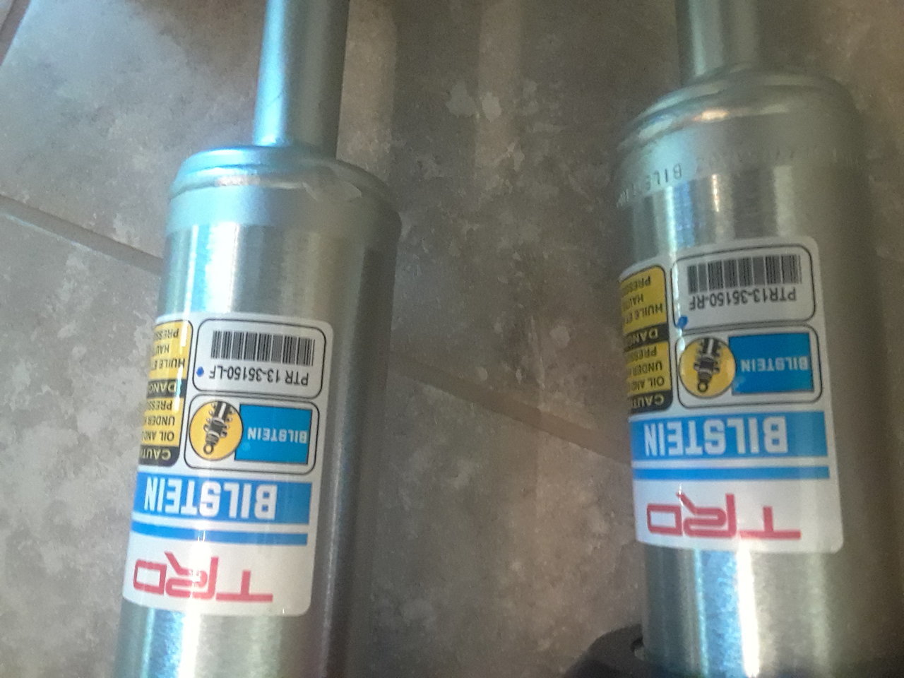

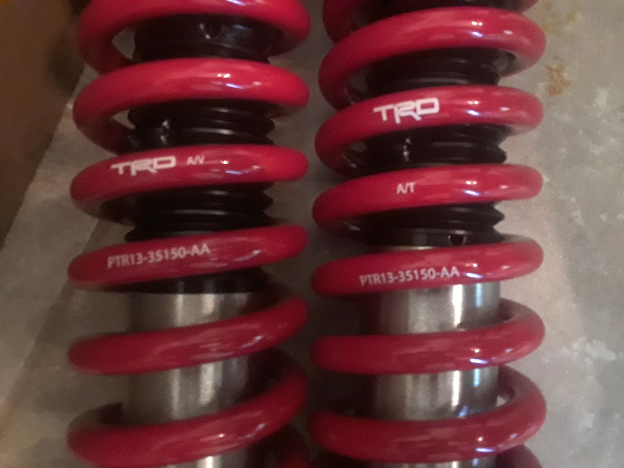

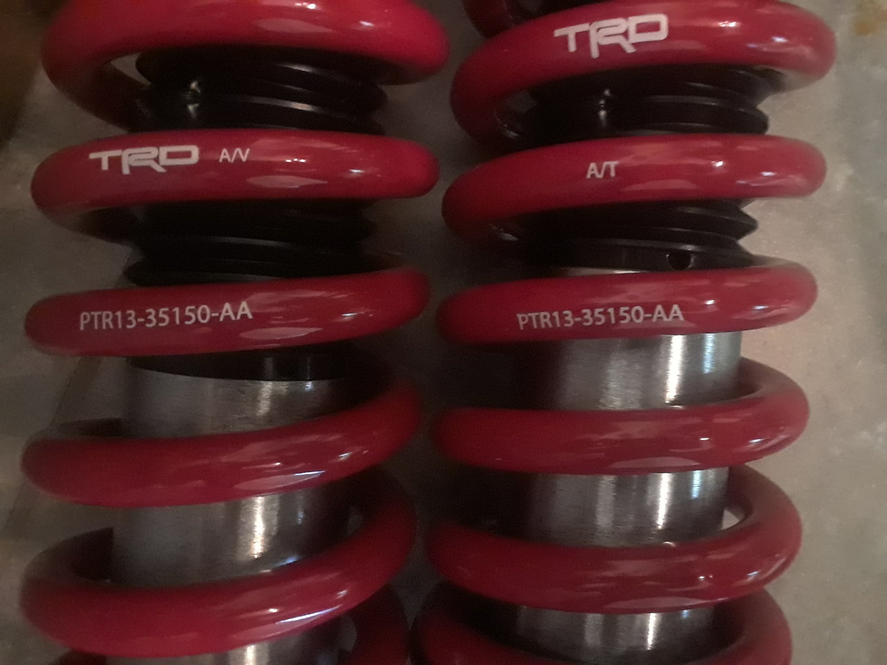

    The springs are probably the exact same rate and length.

    I am thinking the dealers ran out of the matching parts kits and started throwing a bunch of parts together too make some more kits too sell,hopefully there are no problems with the mismatched kits.

    Your left one is a 4Runner coil

    Checked mine. They have matching part numbers on the coil and shock for each side.

    Did a Toyota dealer print off an exact label for the entire kit, find the exact factory box and ship out? I think not. They stand to profit more selling the parts individually. Did Toyota clear them out because they knew this happened?

    Different part #s different part.Id be suprised if they are the same.JKs have many spring sizes for the many models they have(2 door 4 door softtop hardtop).They all have different part #s.Hope it works out.
