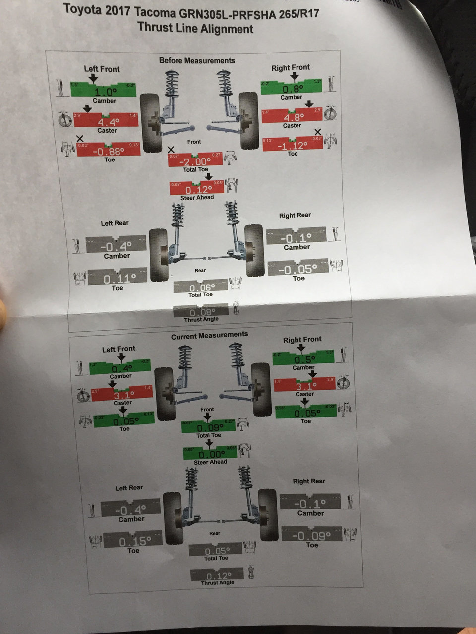

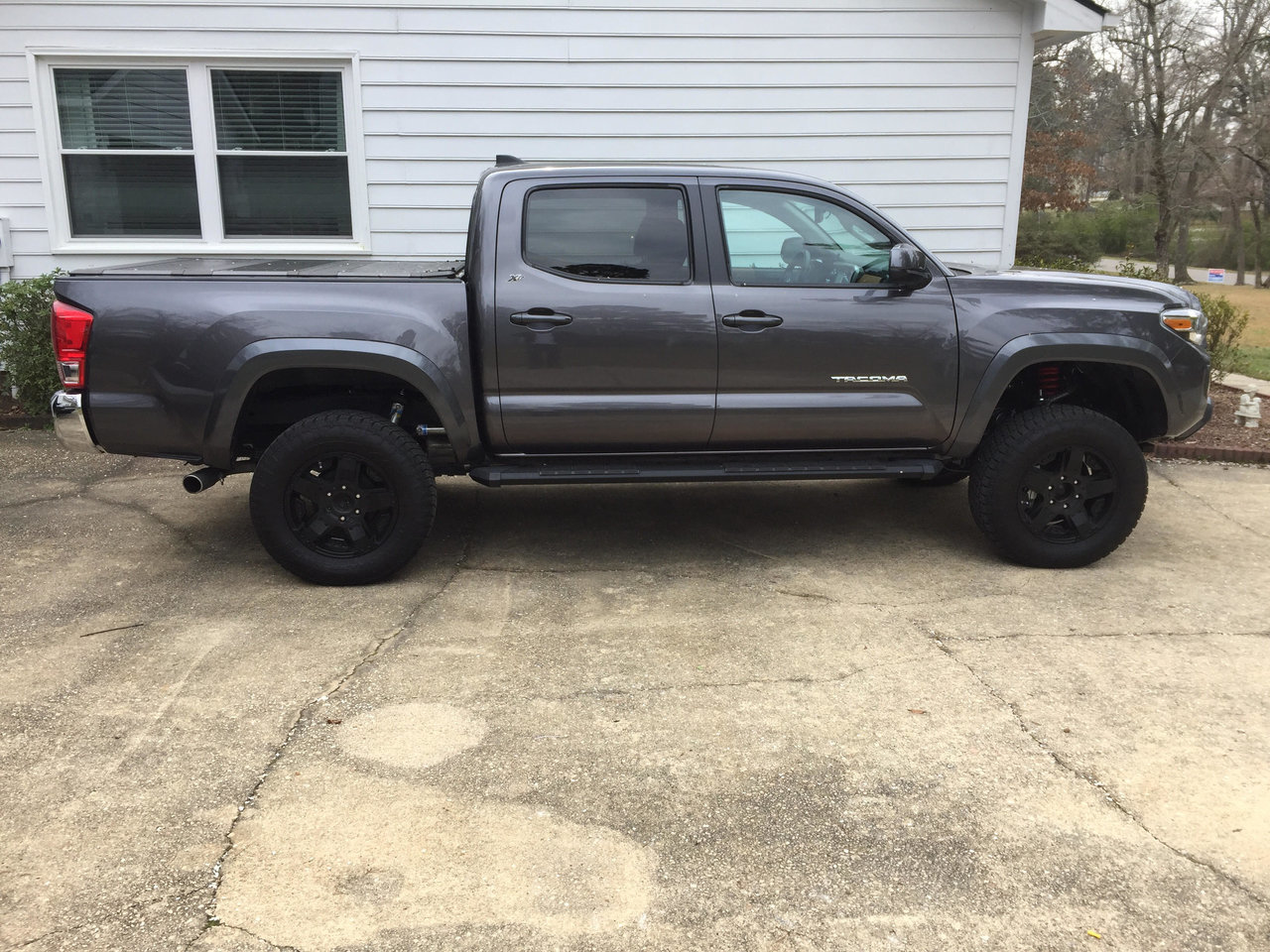

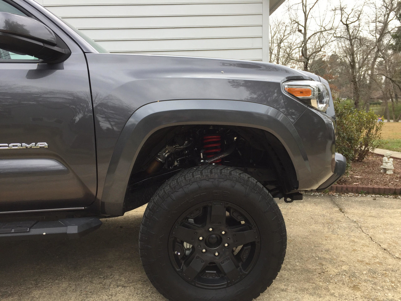

    Knocked out the TRD lift this weekend with some Camburg Uniball UCA's.

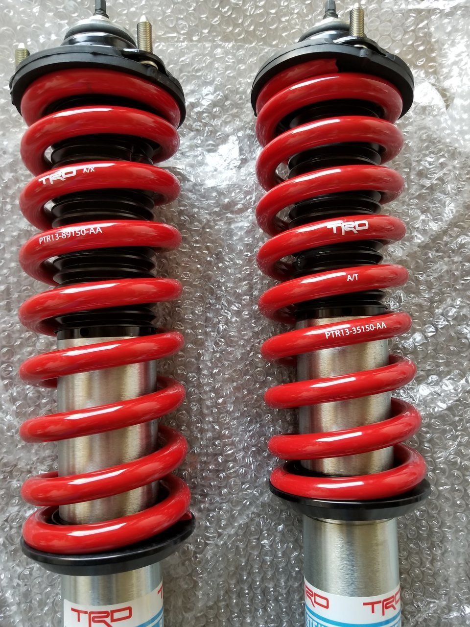

    Hello All,
    Just wanted to provide an update to those with mismatching coil #'s. My dealer contacted the Toyota parts line and was told that this is indeed the WRONG PART...they will be ordering a new spring for me with the correct number. Just an fyi to all out here with the same issue. The rep on the phone mentioned that there was nothing indicating that the part numbers cross reference to one another!

    Alignment after lift and UCA's.
    09 Redneck likes this.

    Thanks for the info. Guess I'll be contacting the place I bought it from.

    You're welcome, hope this can be of help to members that were impacted by this mismatch.

    That's a damn fine alignment right there

    Thanks, it was a small town shop. I am pleased with their work. Next week I should receive my new FN FX Pro wheels, so I can put on my 34x10.5 KO2's with them.

    That Really sucks! mine have just been setting in the box since I got them but I pulled them out to make sure everything matched.

    That is a ton of lift. Did you do anything other than the kit?

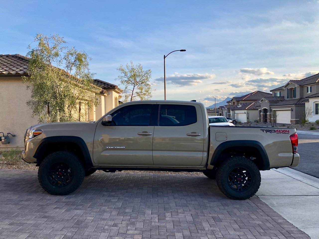

    Got the front struts swapped. I also had them take out the overload - sat a bit high in the back (HS Progressive AAL in back only / nothing extra in front other than struts). Instead of a +2" rake, it's now at 1". Here it is sitting both directions in my driveway. The vibration between 6-12 mph seems like it is gone too.

    Rob,
    Did you install UCA?
    How's the alignment after installing the 1/4" spacer?

    No. Just stock uca
    Alignment was still good.
    Try to get Max caster.
