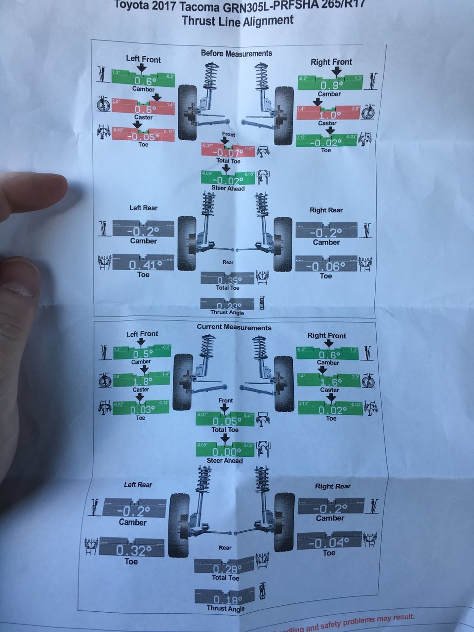

    Nice! I just looked back at your install posts and have a few questions.
    1. Did you do UCA’s?
    2. Where did your alignment end up?
    3. Did you do ECGS bushing? If not, any vibes?
    I just had knee surgery so my install date has been pushed back. However, the delay may allow additional funding for UCA’s or other add-ons if needed.
    Thanks!

    Thanks man! Stock UCAs and no ECGS bushings, decides to wait until the needle bearing fails and try to have Toyota repair it under warranty. And my alignment was actually pretty decent, I’ll have to find the paper and look at the numbers exactly. But definitely no complaints, a buddy and me knocked out the install in a few hours on a Saturday morning.
