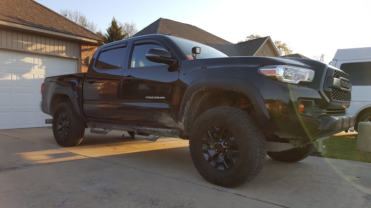

    Wow, you're truck looks amazing. What are those, 33's? You've got me thinking that's the way to go. Forget gas mileage and acceleration
    Bajaaataco24[QUOTED] likes this.
  9. Mar 13, 2018 at 11:45 PM
    #2569
    Bajaaataco24
    Bajaaataco24 Member
    Dec 25, 2017
    #239307
    21
    Michael
    2017 Super White TRD Sport 4X4
    Haha thanks man yes they’re 33s. You definitely will be a familiar face at the pump but it isn’t that bad speed wise. With the ect button on it still picks up pretty well imo.

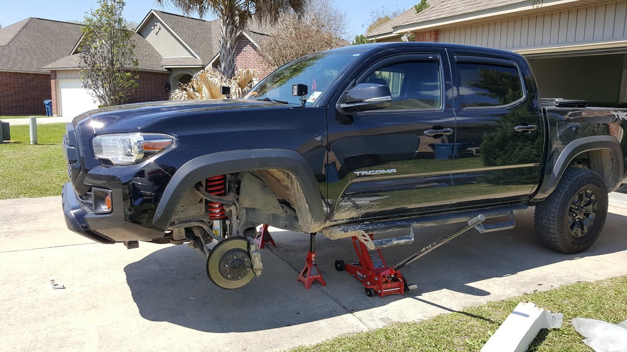

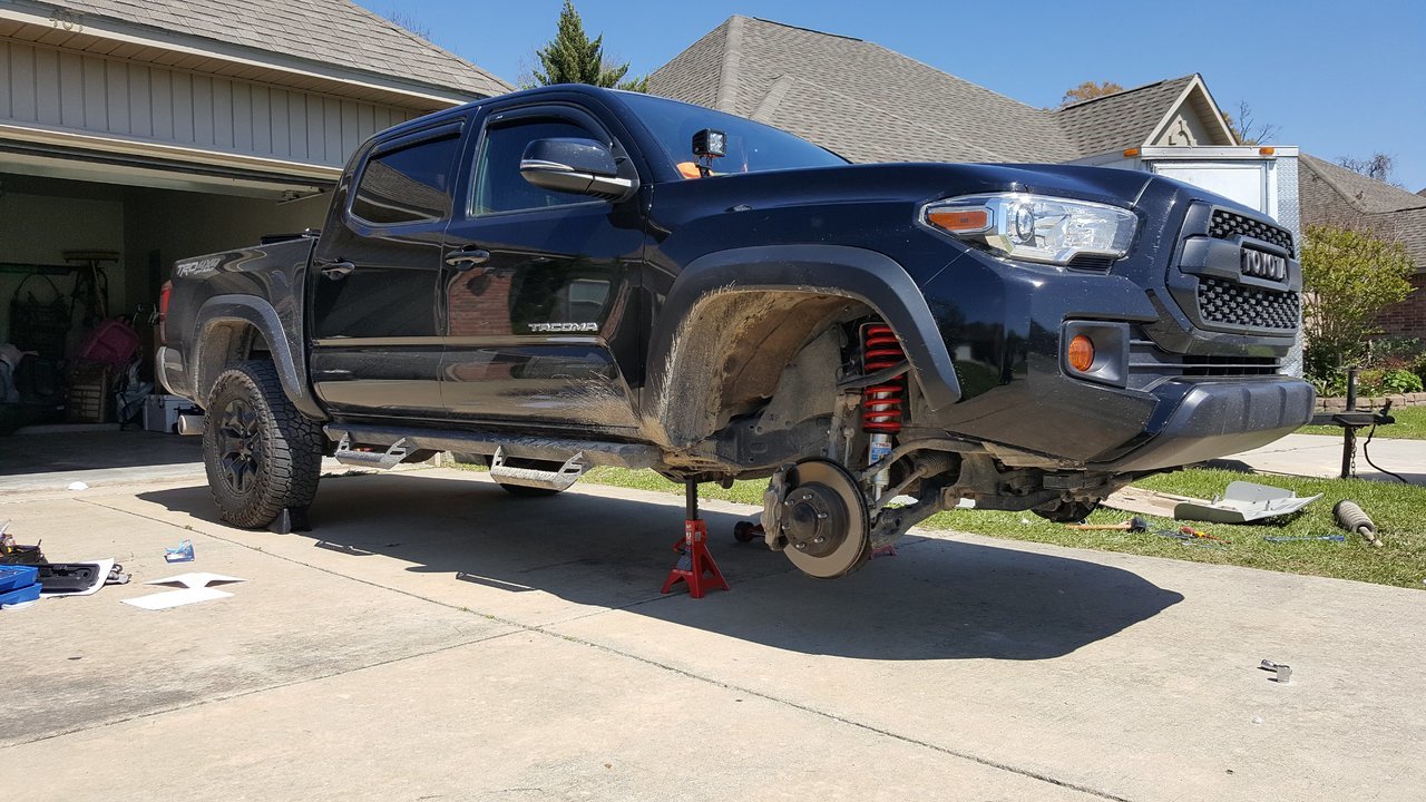

    Installed the lift all around but skipped the AAL for now!
    Pre Lift measurements:
    FD 34 15/16
    FP 35 7/16
    RD 35 12/16
    RP 36 5/16
    Post lift measurements:
    FD 37
    FP 37 1/4
    RD 36
    RP 36 1/4
    that is sitting on 265/75R16 and after a few spins in the neighborhood.

    When you jack up a truck like this, do you lower the jack so the jack stands are supporting the weight of the truck? Or are they just there for safety (ie. backup)?
  16. Mar 14, 2018 at 5:07 PM
    #2576
    Carrot Top
    Carrot Top Well-Known Member
    Apr 18, 2016
    #184682
    155
    Mark
    Las Vegas, NV
    2016 Inferno Tacoma TRD 4x4
    The jack stands are supporting the weight of the truck.
    NMTrailRider likes this.
  17. Mar 14, 2018 at 6:27 PM
    #2577
    Dee1seven
    Dee1seven Well-Known Member
    Jul 31, 2017
    #225491
    341
    RVA
    '17 DCSB TRD OR - Quicksand
    '15 TRD Pro Bilstein Suspension HS 3 leaf AAL TRD PRO Wheels 285/75r16 BFG KO2’s Truxedo Soft Roll Up cover
    Jack stands will “safely” support the full weight of the truck. For the sake of safety never rely solely on the jack to support the full weight of the truck while you’re working underneath especially. ( I admit I do this all the time because I’m lazy to get the stands out)
    When setting up the stands I suggest: lower the jack just enough that the full weight of the truck is on the stand, while the jack is still up but not entirely supporting the weight, walk around both sides and make sure the stands are standing firm on the ground, I usually try to rock the vehicle a little bit to see if there’s any unsafe movement on stands before I fully lower the jack just in case I need to adjust the stand position or in case it slips the jack is still under and will support it. Also if you’re only using 2 stands always chock your wheels
    On the rear You’ll also need your jack to support the axle while you remove the rear shocks. You may need to raise or lower the axle, don’t lower too much to avoid over extending the brake lines.
    NMTrailRider[QUOTED] likes this.

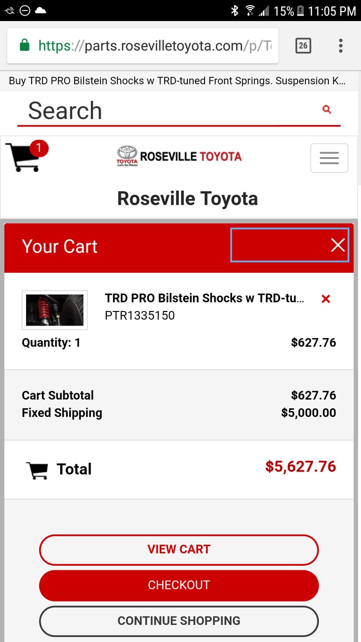

    I found one dealer that still has them... shipping seems a bit high though.
  20. Mar 14, 2018 at 8:08 PM
    #2580
    oscolivar1
    oscolivar1 Well-Known Member
    Oct 30, 2013
    #115568
    2,267
    Oliver
    VA
    2017 Tacoma Limited
    Bilstein 8112/8100, JBA UCAs, Icon RXT leaf pack, work wheels 17x8.5;-10os, 285/75/17 cooper LTX AT3, Mobtown HC rear bumper and Sliders, SSO front bumper, BAMF greceased grill.
    o_O
    That can't be real....
