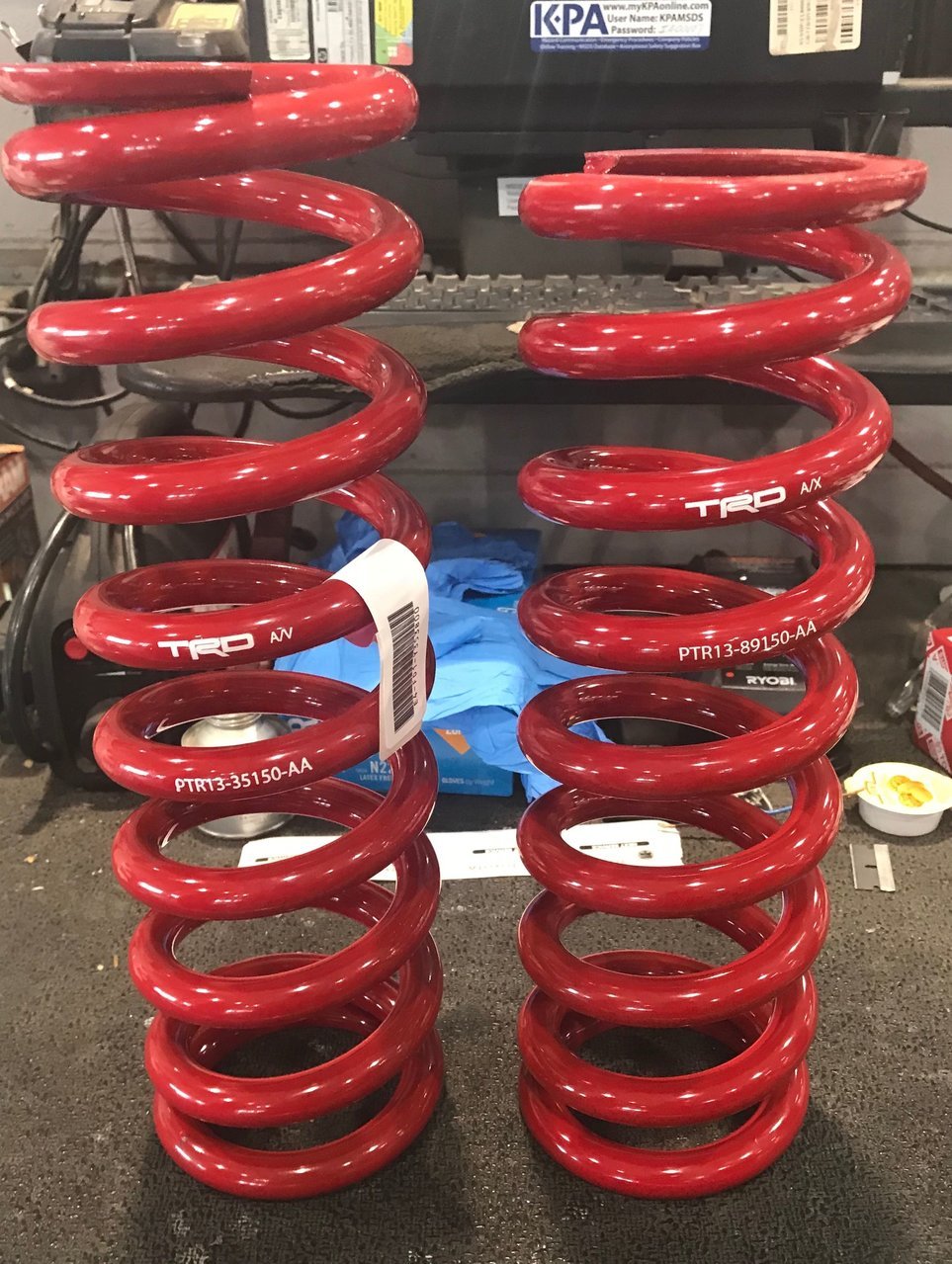

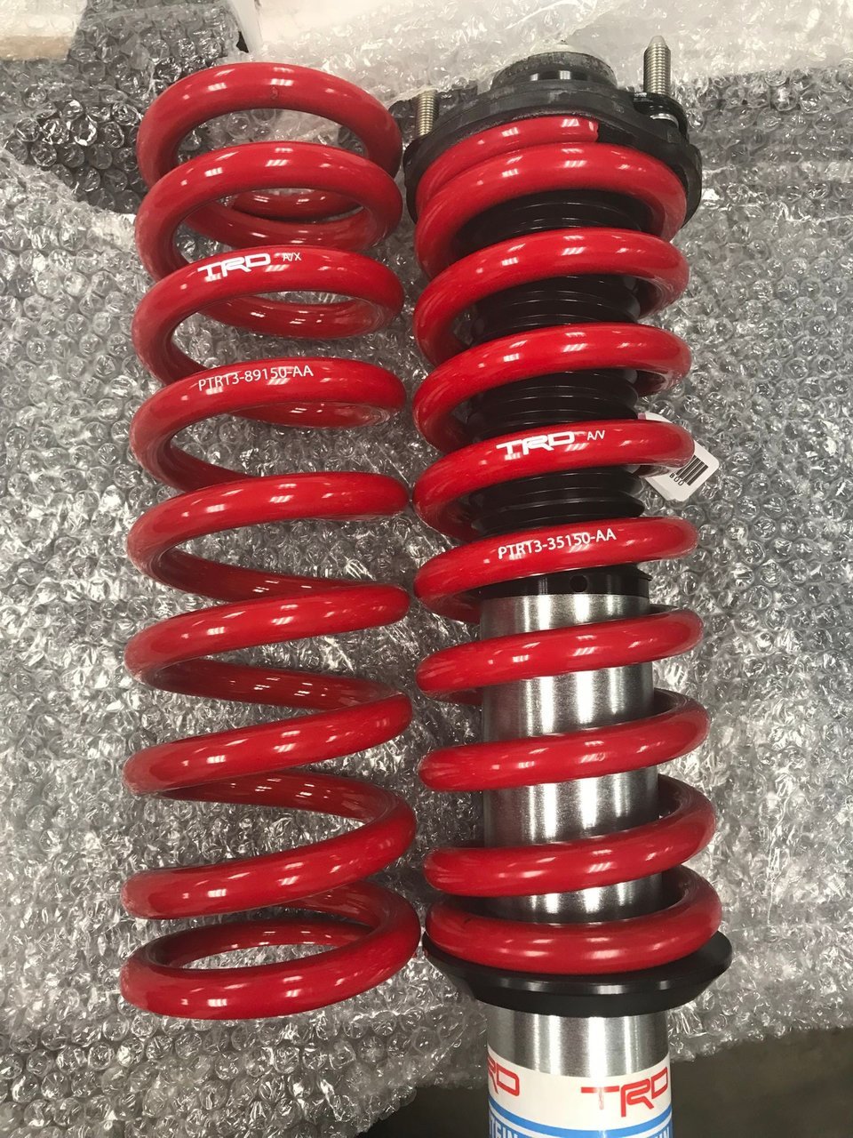

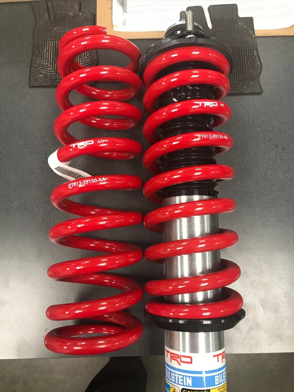

    For those wondering what the difference bt the 4runner coil vs the Tacoma coil looks like, Toyota of DesMoines emailed me pics of the swap they did for my set that was wrong.
    Big difference if you ask me. So if you have the wrong coil, get it taken care of asap. This has the potential to be a big safety issue should you install and drive around with it on.
    Thanks again to Toyota of DesMoines for taking care of this. Looking forward to getting it back and starting my install!
