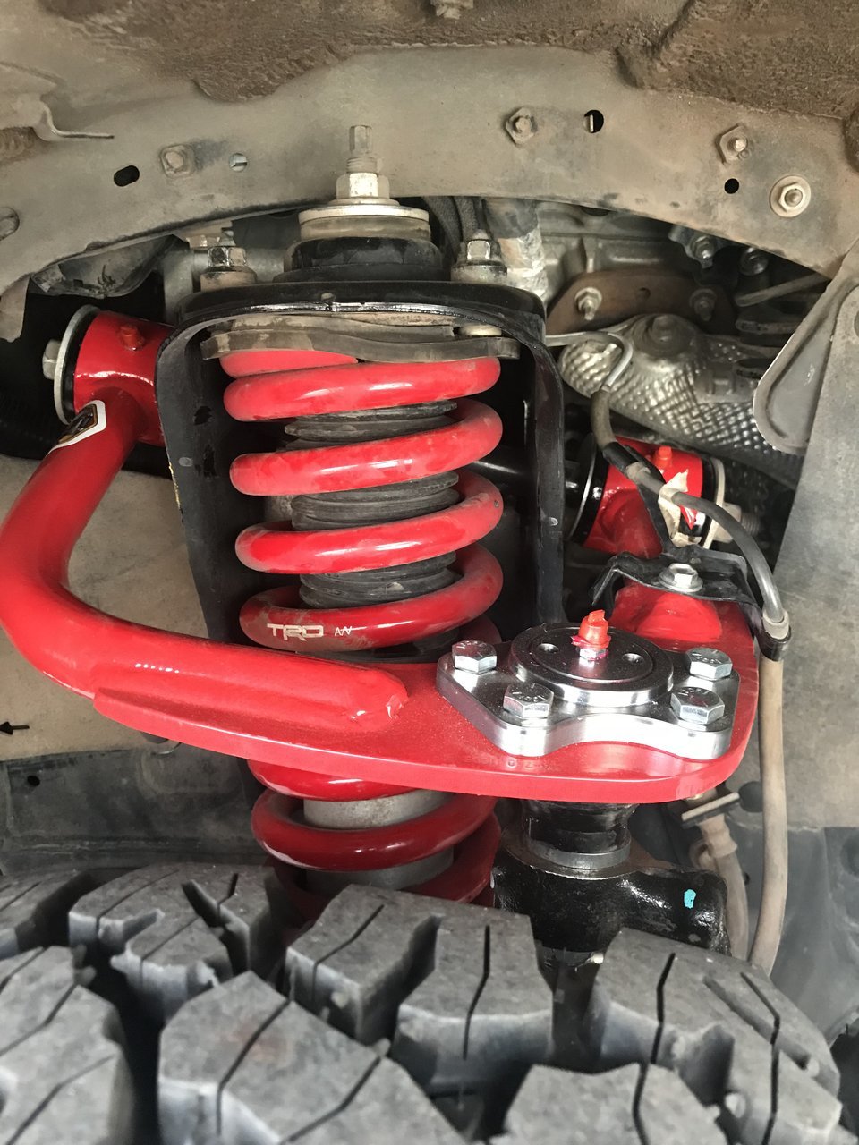

    Picked up 1.25" with the bags at 5psi and pro rear suspension. Fronts will go on soon.

    DIY?

    Had my local suspension shop install, along with 1/4" lift spacer for the Bilsteins to level it with the rear as i noticed it dropped a little after 2years. Seriously though, the JBA change the way the way the vehicle drives both on road and OR due to much better camber. Totally worth it. OEM UCA make it feel unstable compared to the JBAs. Now it drives incredibly confident with less play in steering and improved alignment. IMO.
    I suppose I could have tried DIY, but I had major back surgery this year so it's not possible for me.

    What rims are you running? I was considering the JBAs but I am not sure how much of an improvement they would really provide. Sounds like you are happy with them.

    I have TRD Pro 4 runners 17". Prior TRD Beadlock 16". The steering on oem felt okay, but a little wobbly on both rims especially on curves or bumps. When JBA was installed the whole truck feels like a different beast-solid, stable and coincides, no wobble. The bilsteins perform even better off road. JBA are the way to go if you don't want to adjust camber compared to other UCAa and they are claimed to have excellent alignment since they come pre-set to avoid issues with the alignment shop not getting it right.
