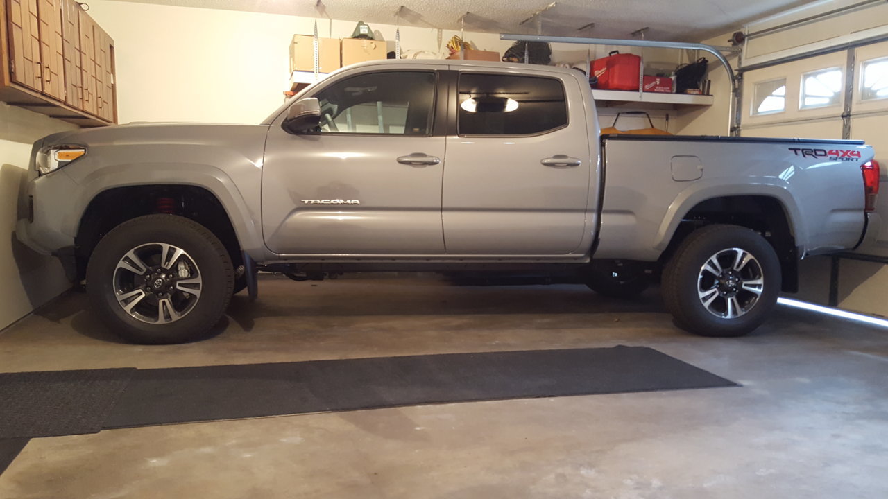

    Stock
    Anyone have pictures of this lift with stock tires? I have mine ready to be installed but want to make sure it doesn't look too goofy.
  5. Mar 29, 2018 at 5:21 PM
    #2725
    na8rboy
    na8rboy 18 DCLB Sport Cement
    Jun 3, 2012
    #80024
    3,673
    WI
    18 DCLB SPORT CEMENT
    I'll try and get some tomorrow, and post them.

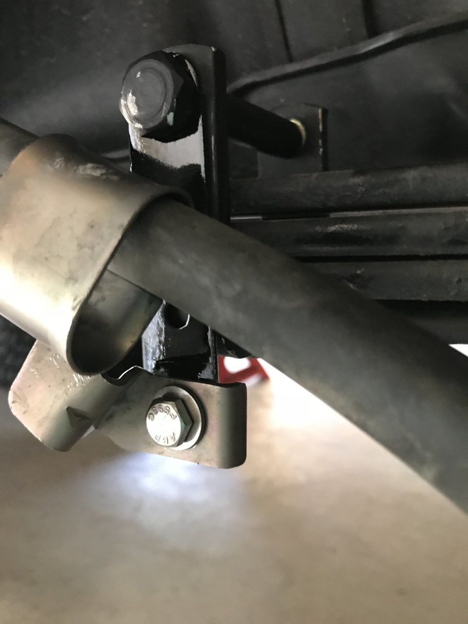

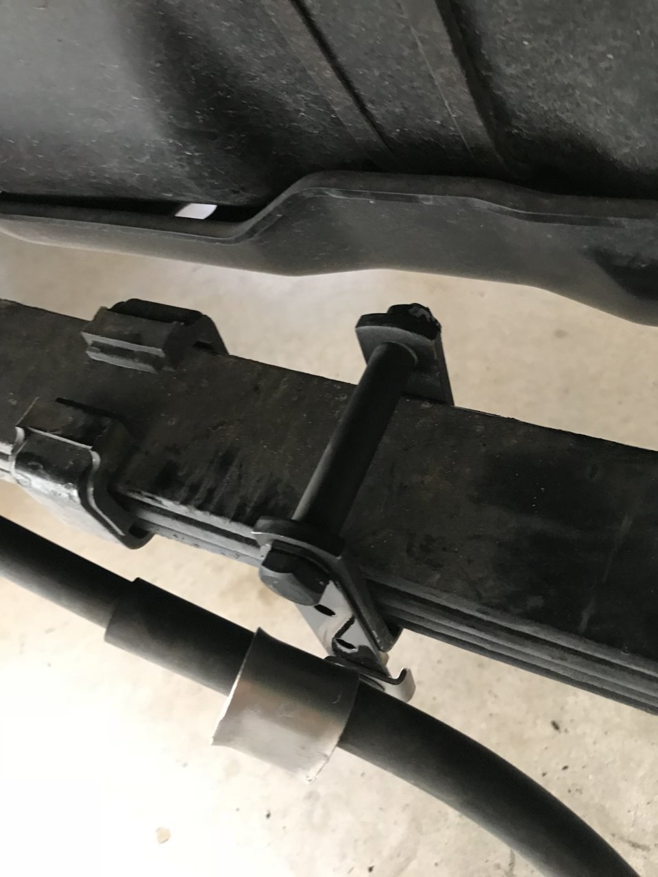

    This was my fix for the ebrake cable with my HS 3leaf Pack. Simple bracket that bolts to the front retainer on the pack, put a slight bend in the factory bracket and bolted it at the bottom. No flopping around and worked fine at full droop in the garage.
    And just FYI no factory overload if you can’t tell from the photos.
    TheAngryGinger, Jon8251 and JS760 like this.

    Good workaround. I may try this on mine this weekend.

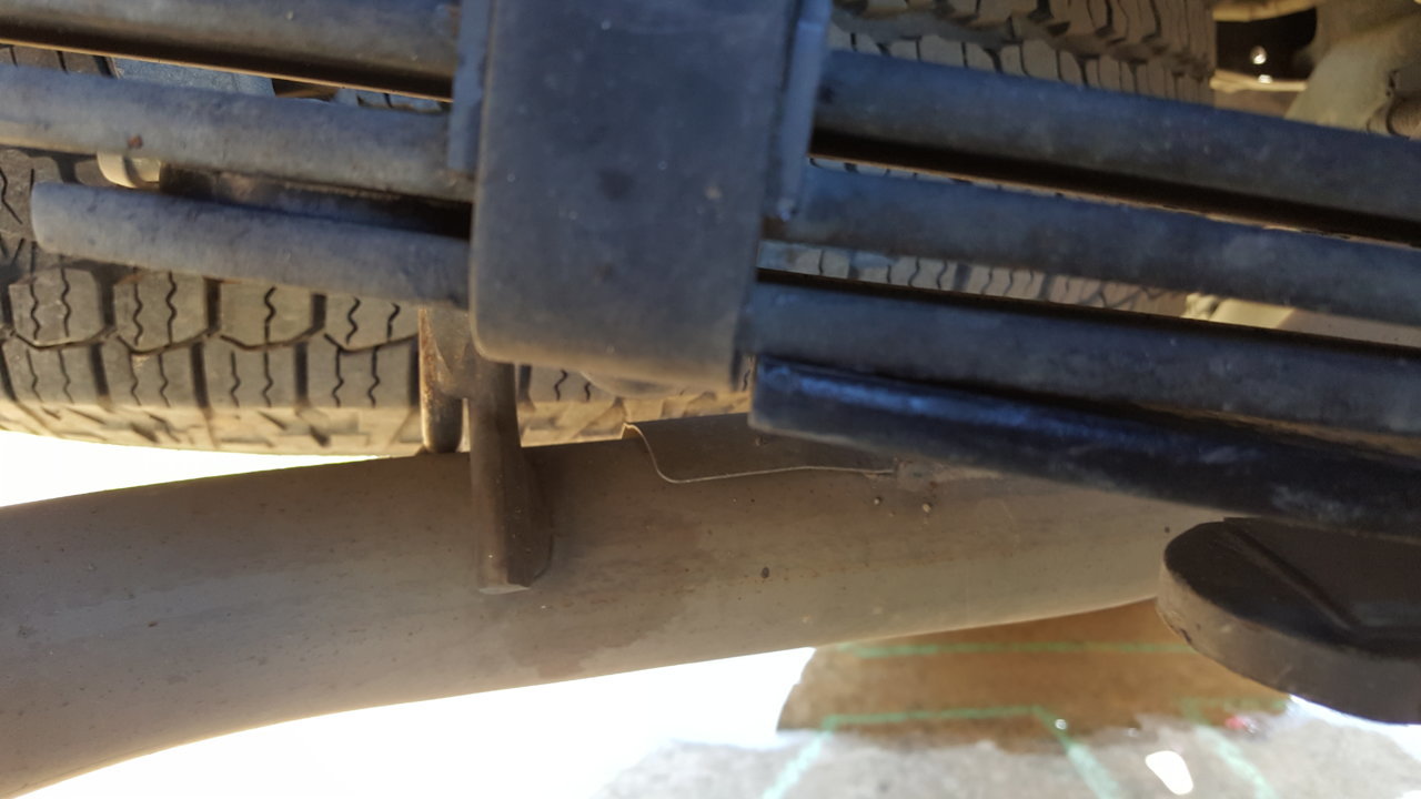

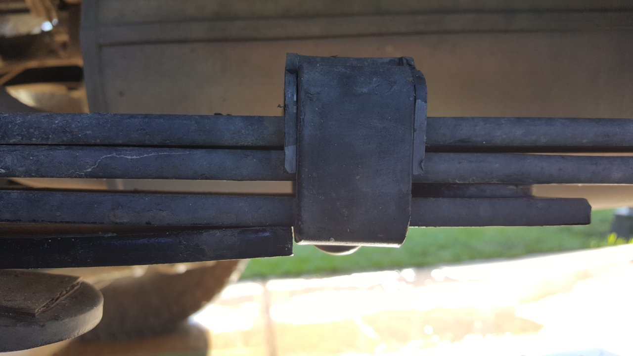

    594
    Edmond, OK
    2016 TRDORDCSBAT
    2015 TRD PRO suspension

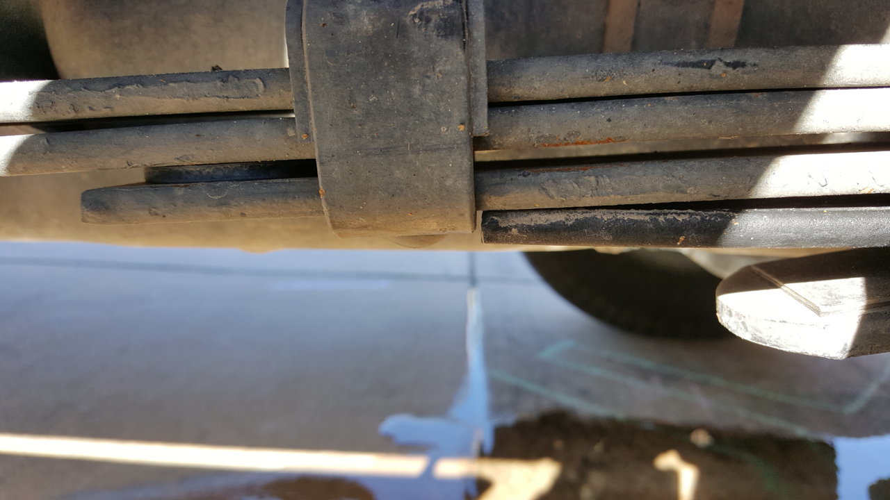

    Finally got a chance to putt the skyjacker aal RTC515 in the back! I couldn' find much info on anyone that did that on the 3ed gen but here it is. I couldn't feel any difference in the ride quality so far with an empty bed! Now I had the kit installed for quite some time and that stuffined up the rude a bit but the aal itself yielded no change. The leafs are a little long and I was concerned at first but they are not touching the c-clemps I slipped a credit card there and had someone bouncing the bed and cc stayed free. Easy install no cutting or grinding took about 2 hours.
    Mesurments from ground with 265/75R16
    FD 36
    RD 38
    FP 36 1/4
    RP 38 1/4

  10. Mar 30, 2018 at 7:53 AM
    #2730
    na8rboy
    Jun 3, 2012
    #80024
    3,673
    WI
    That is going to cause you trouble. That add a leaf is going to smash into the spring clamp, when flexed. There is a lot more movement while driving, than someone bouncing on back.

  11. Mar 30, 2018 at 9:05 AM
    #2731
    Sharpish
    Sharpish Well-Known Member
    Jan 4, 2016
    #173981
    3,824
    Brian
    Victoria, British Columbia, Canada
    2012 Tacoma TRD OR 4x4
    I agree. Driving around might be ok but when you flex the axle off road it's going to bind

  13. Mar 30, 2018 at 9:10 AM
    #2733
    na8rboy
    Jun 3, 2012
    #80024
    3,673
    WI

  15. Mar 30, 2018 at 9:32 AM
    #2735
    na8rboy
    Jun 3, 2012
    #80024
    3,673
    WI
    There is a 1-1/2" in front and 3" in back, look tighter. Other side of garage is 3' deeper but need space to get at work bench.

    #2736
    sxe4533
    sxe4533 Well-Known Member
    Sep 12, 2015
    #164074
    594
    Edmond, OK
    2016 TRDORDCSBAT
    I highly doubt it! As the leaf gave a bit of an arch back but still consideably flat so even with a backward arch it might barley touch! Those clamps are very soft metal anyway worse case the leaf will carve them maybe a millimeter at max!
  17. Mar 30, 2018 at 10:00 AM
    #2737
    TheAngryGinger
    TheAngryGinger Go Big Red
    Apr 11, 2013
    #101892
    1,023
    Nebraska
    '17 TRD Sport
    Stock
    Perfect. I was hoping the sport "AT" wouldn't look too goofy with this setup. It looks good enough to be able to deal with it for now.

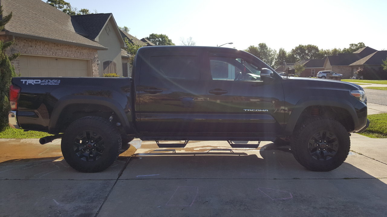

  18. Mar 30, 2018 at 10:07 AM
    #2738
    Ram.95
    Ram.95 Well-Known Member
    Nov 24, 2017
    #236782
    185
    2017 Black Tacoma TRD OR 4x4 Dallas Tx
    TRD PRO Bilstein Suspension HS Progressive AAL
    Here is mine on the stock wheels and tires with the OL in.

  19. Mar 30, 2018 at 1:22 PM
    #2739
    NMTrailRider
    NMTrailRider Well-Known Member
    Sep 28, 2009
    #23469
    5,293
    New Mexico
    That's a good look imo.
