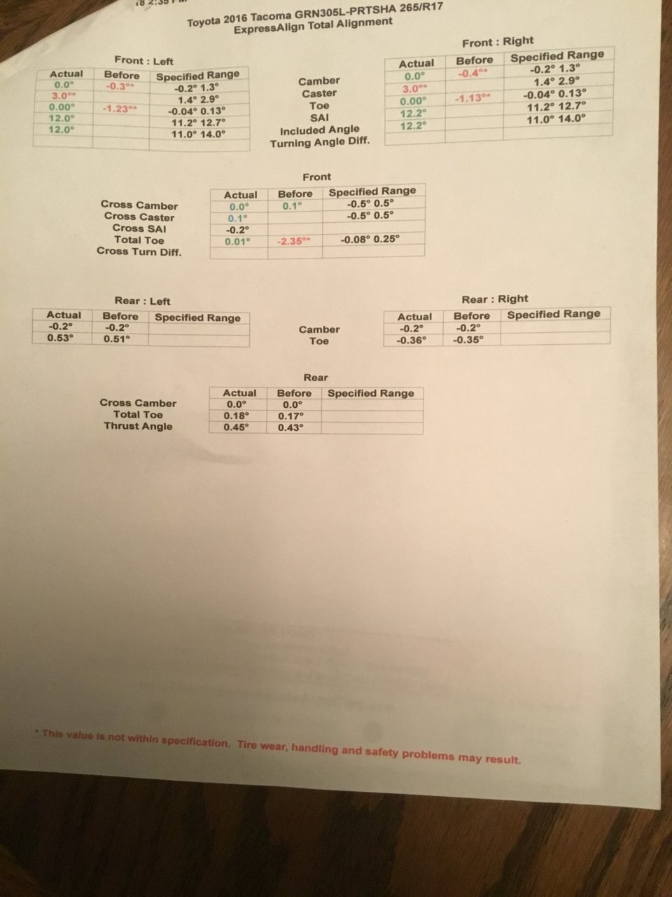

    After installing my lift w/1/2” Headstrong spacers I didn’t get the lift I expected. So I installed 1-1/8” top spacers and ended up at 22-3/4” DS & 23” PS HTF which I was satisfied with. So after finally receiving my SCS wheels I got an alignment.
    After alignment I’m at 23-3/4” HTF DS & PS I didn’t realize alignment makes such a difference in ride height. Now I’m concerned about my cv angles. I hope to get my wheels and new tires installed this week and wait to see if it settles some after driving awhile.

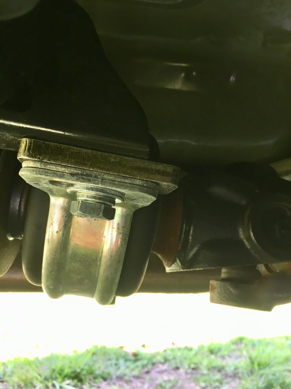

    Installed with 1/4 spacer, jba uca, 1.5 wheelers aal + ubolt flip and superbumps all around. Alignment in the AM. Happy with how it turned out. 2" all the way around, exact measurements side to side currently. Random pics for now... didnt make it to the skiders yet ha and still need to reroute the ebrake cable
