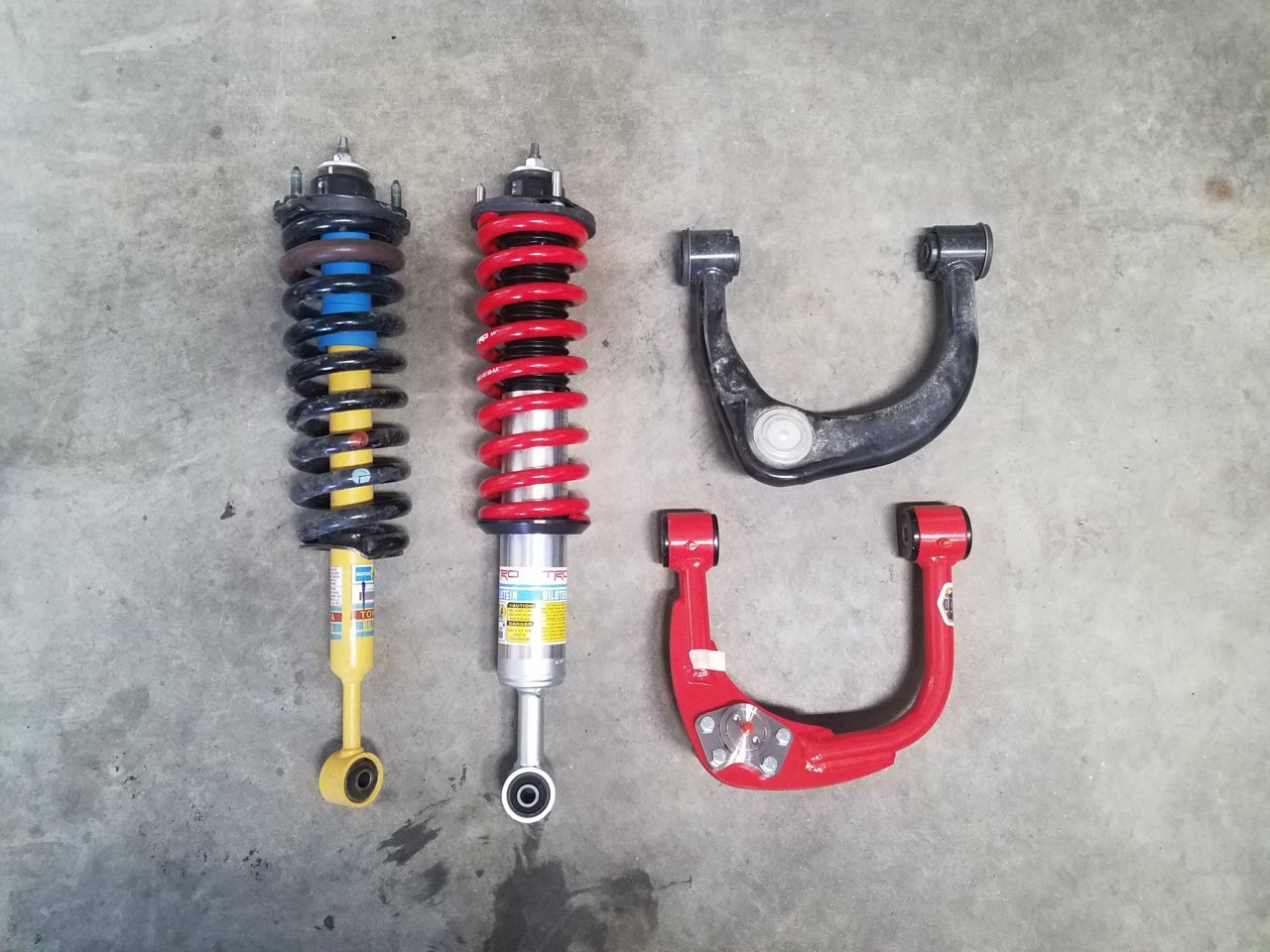

    As a follow up, after alignment: the ride is amazing. I didnt not expect it from this small upgrade. I suggest uca if you want the truck to ride and drive well. No overload for me, rear end is much more supple. I am planning to go with icon's rxt pack in the future. 1" rake. Ill report back in a few weeks with settled numbers.

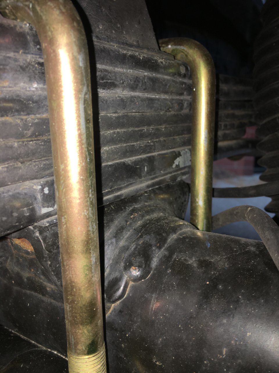

    The digital angle finder I ordered came in today. I will be measuring my operating angles this weekend. My 2016 did not come with axle shims. Do you know what degree shims are on your truck? Are your shims installed with the fat end of the shim facing forward or rearward under the leaf spring? I'm trying to figure out what the factory setup is for shims. Does anybody else know as well?

    Mine look to be about 3/16” down to 1/16”, fat end towards the rear

    Thanks so much for the info and picture! I will work now on getting my pinion angle to match my Universal joint next to the CB.

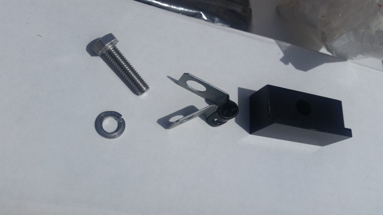

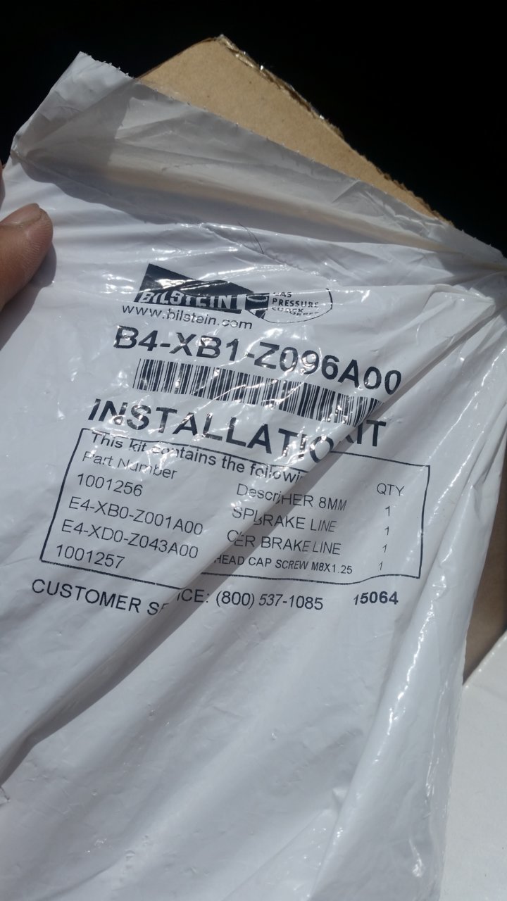

    What side is this going?
  19. May 6, 2018 at 11:51 AM
    #2919
    natural_nativ
    natural_nativ Well-Known Member
    Jan 29, 2016
    #176482
    367
    2024 TRD Sport MT
    Driver's side.
    Rear brake line spacer. Should be just to the left of your pumpkin. You'll see the spot for it to go.
