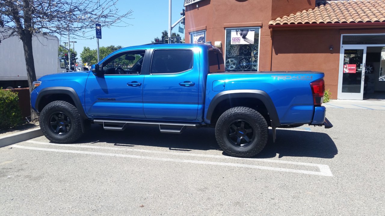

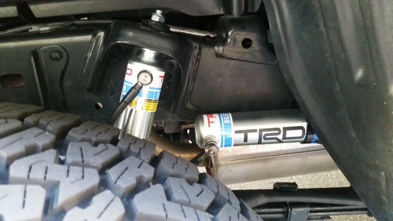

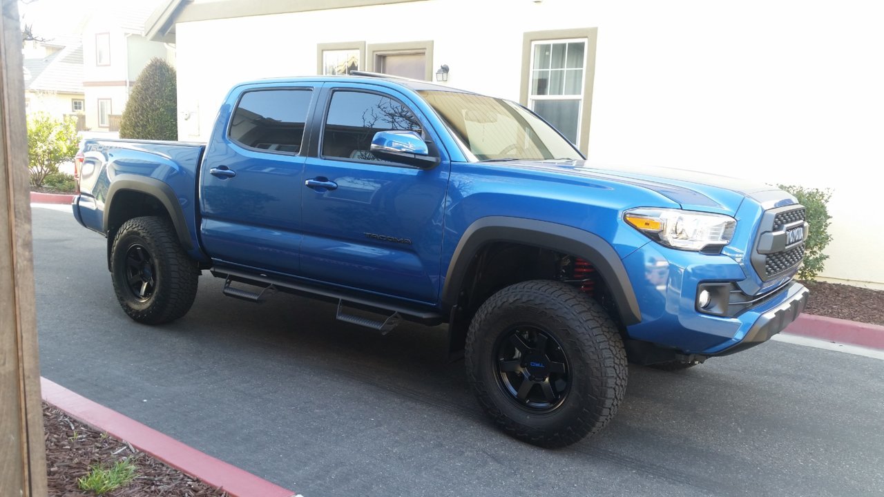

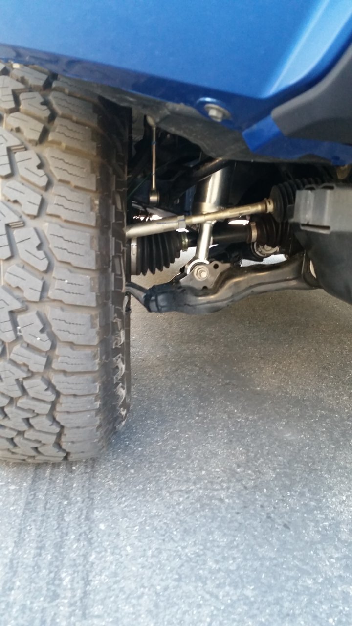

    I installed my TRD Pro kit today.
    265/75/16 At3ws Falken Wildpeak 5 tires
    16x8 0 offset wheels
    1.5" rear block
    1/4" added front upper plate to both sides.
    Stock UCA
    I still have 1/4" lean to the driver side.
    IMO it drives better than my stock 4x4 OR suspension.
    The last picture with stock suspension

    Looks great! Any vibrations at all?

    I took it for a drive looking for the vibration.
    So far, thankfully none...
    I am very pleased with this suspension.
    They are a lot better than OR stock suspension (IMO).

    which kit did you get?
    any reason why you put the spacer in on the passenger side? i would assume leaving it out would have fixed the lean.
    have you rode in a 17 or 18 pro fox suspension? how would you compare the ride?
    I like my OR suspension vs the Fox Pro. the originally posted kit i wonder if is softer sprung vs the actual fox pro suspension.

    I haven't driven a tacoma with the Fox Pro suspension.
    The OR too wobbly for me.
    This Bilstein Pro is stable.
    I added 1/4" spacer to both side to achieved more lift. The driver side has a higher perch than the passenger side. That should help or fix the lean. 1/4" spacer should give you 1/2" lift.
