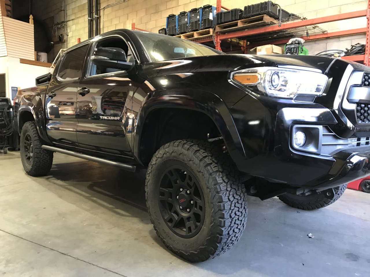

    :wave: Finally got mine done over this weekend with the SD Brew Crew! :cheers: :thumbsup:
