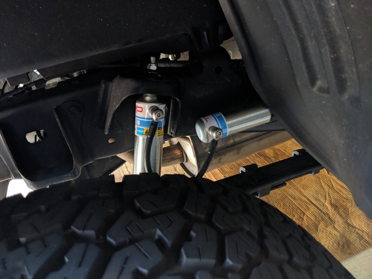

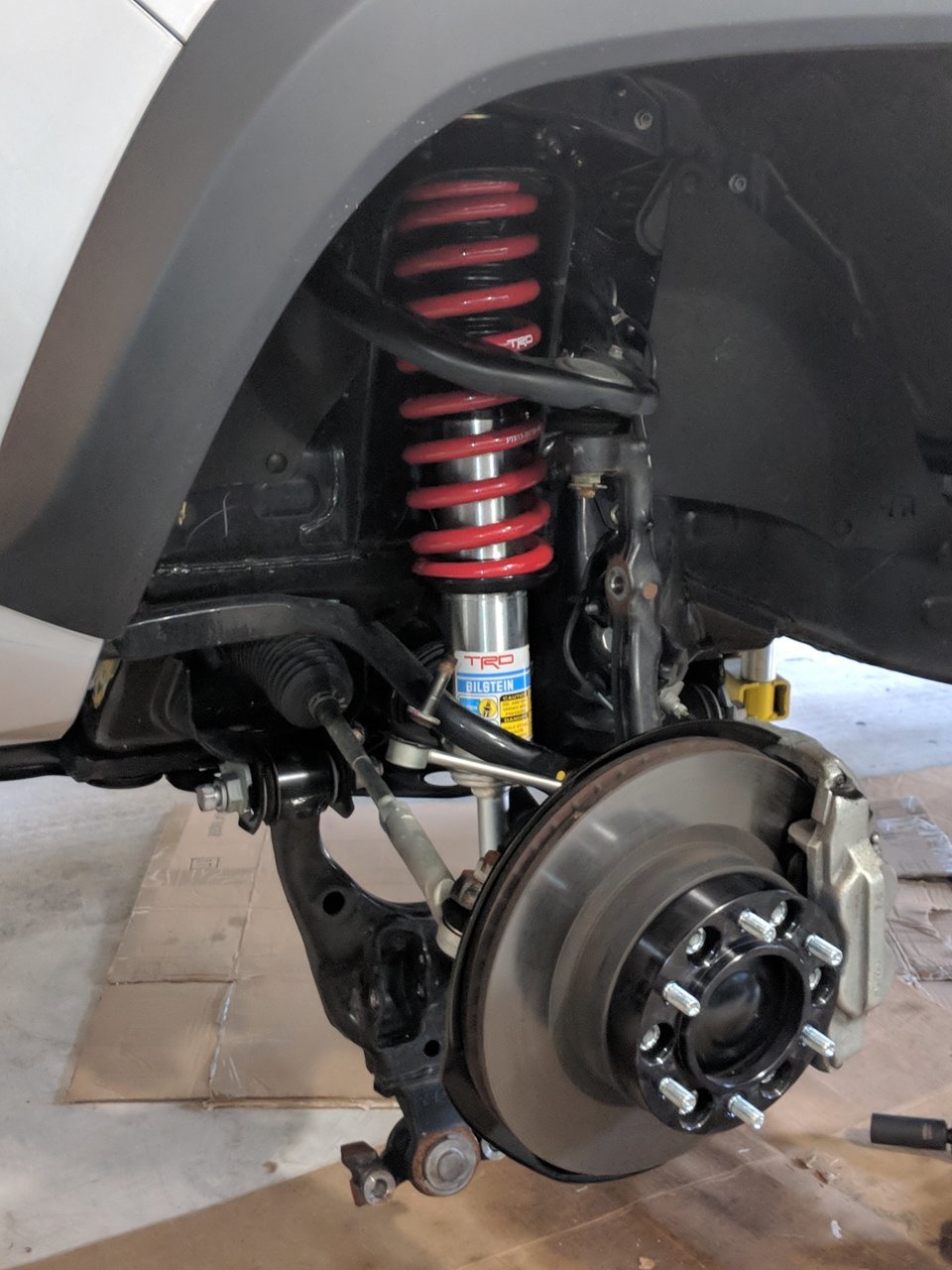

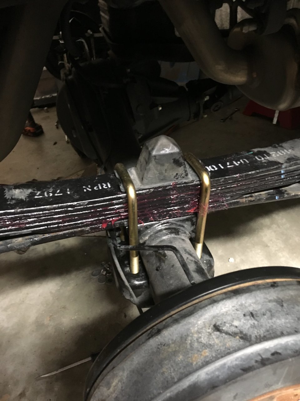

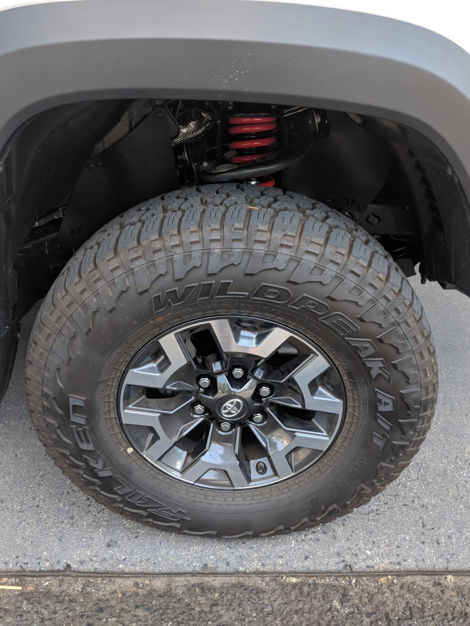

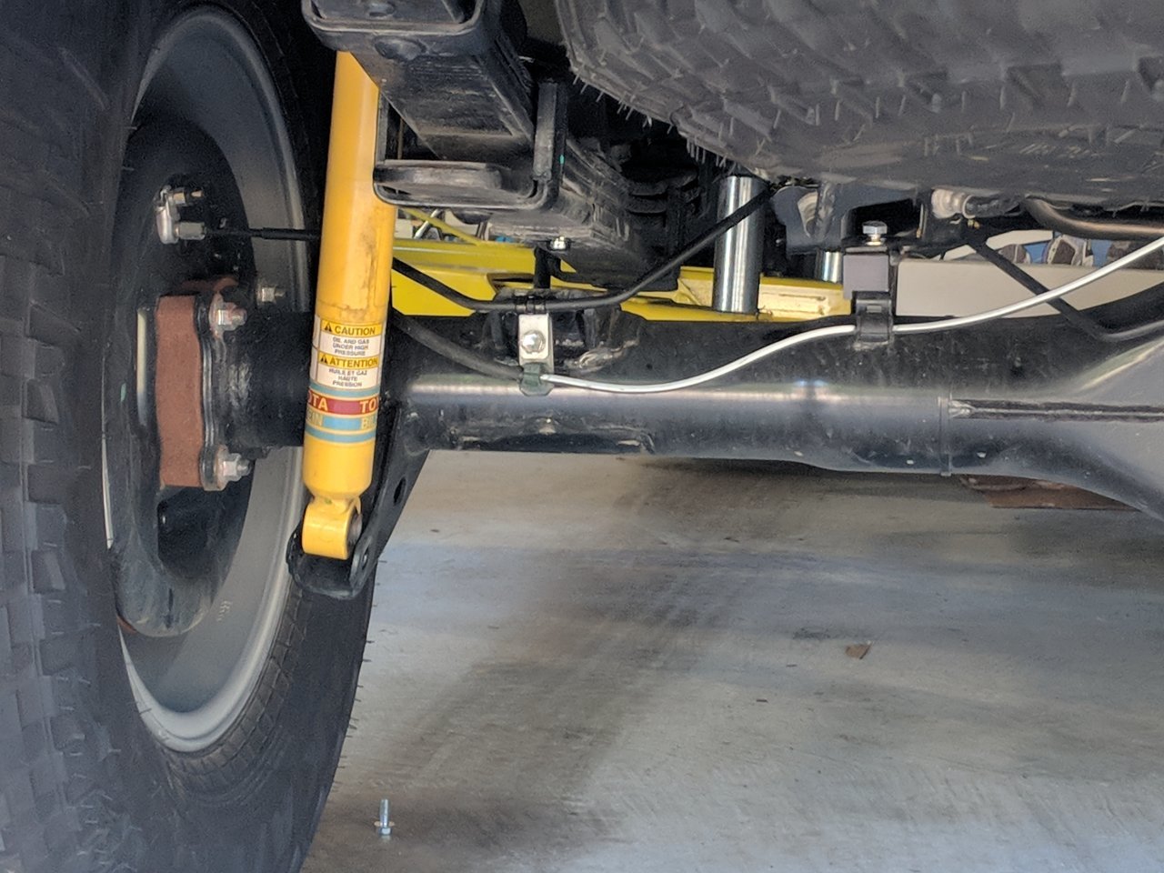

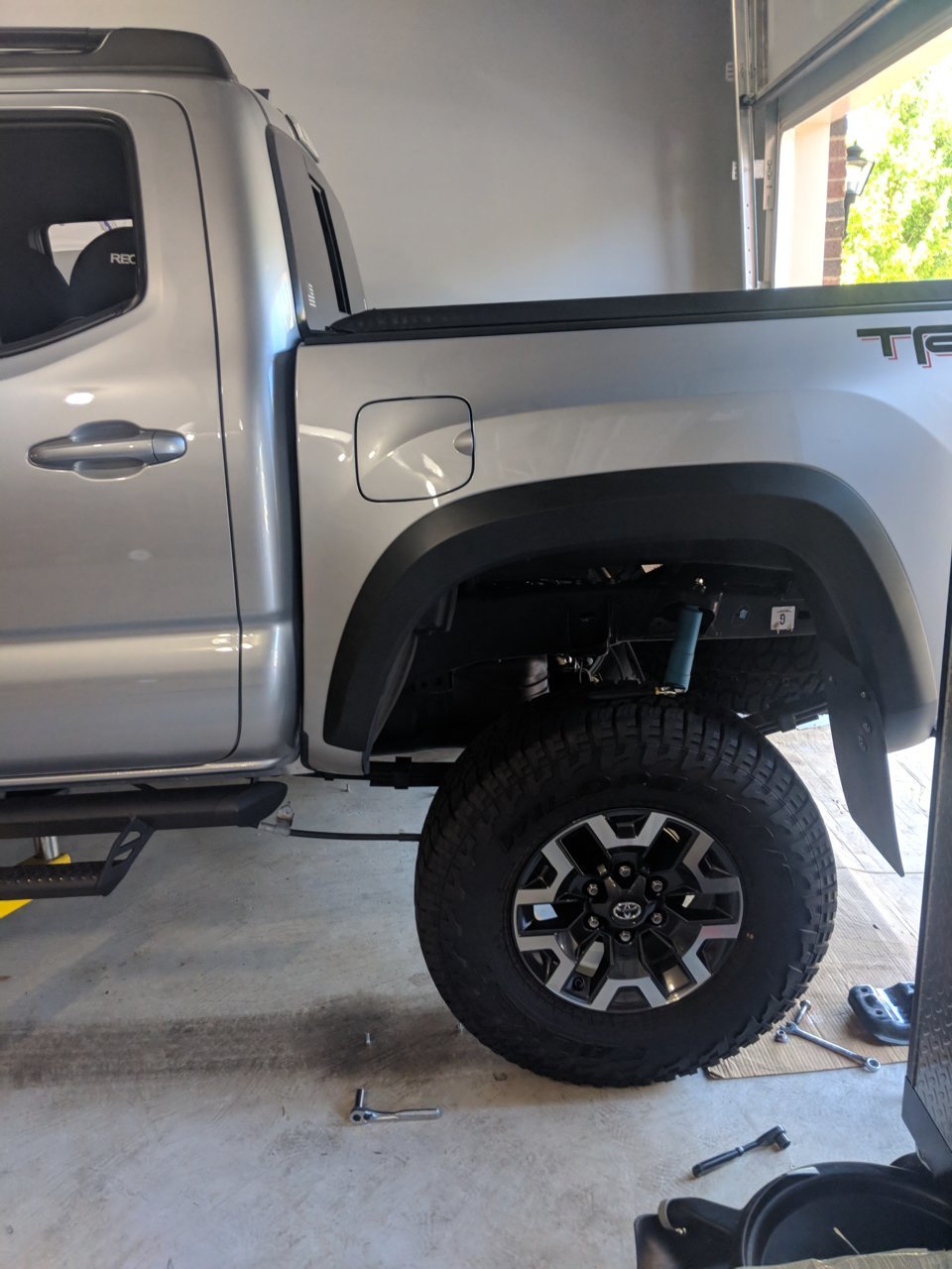

    Finally installed mine this morning. Front was easier than rear. Having a two post lift in the garage helps. Lol!
    Rear is just a 1" block from ReadyLift. I do have the HS AAL sitting in my garage if I ever felt the need to go slightly higher.
    Overall happy with it. Initial ride impressions is definitely smoother than the stock OR Bilsteins and less bounciness.
