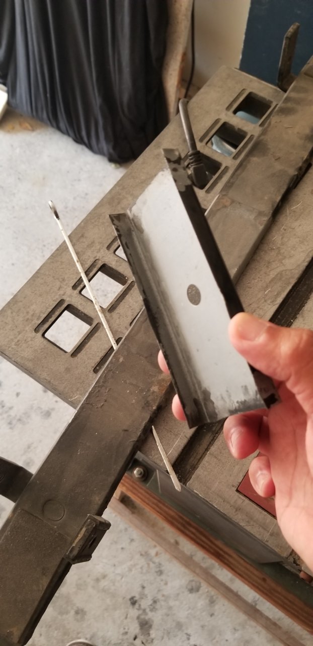

    No clue what it’s called, but I had that piece on my leaf pack too. I can only assume it’s purpose is to give a little protection from any rubbing that may take place between the leaf pack and the axle.
    Don’t mess with them is likely your best options. Most all factory leaf packs will begin to make noise over time but will remain noise free longer than any aftermarket pack or a factory pack with an AAL of any kind.
    I’ve run Dakar’s and loved them, but I could hear them squeaking when UPS dropped them off at my door. As @Dee1seven mentioned, there are a few remedies to moderate the noise, but in my experience the squeaking always returns.
    My suggestion is to either never mess with to begin with, or simply get used to the squeak.

    Put this between my leafs. No noise

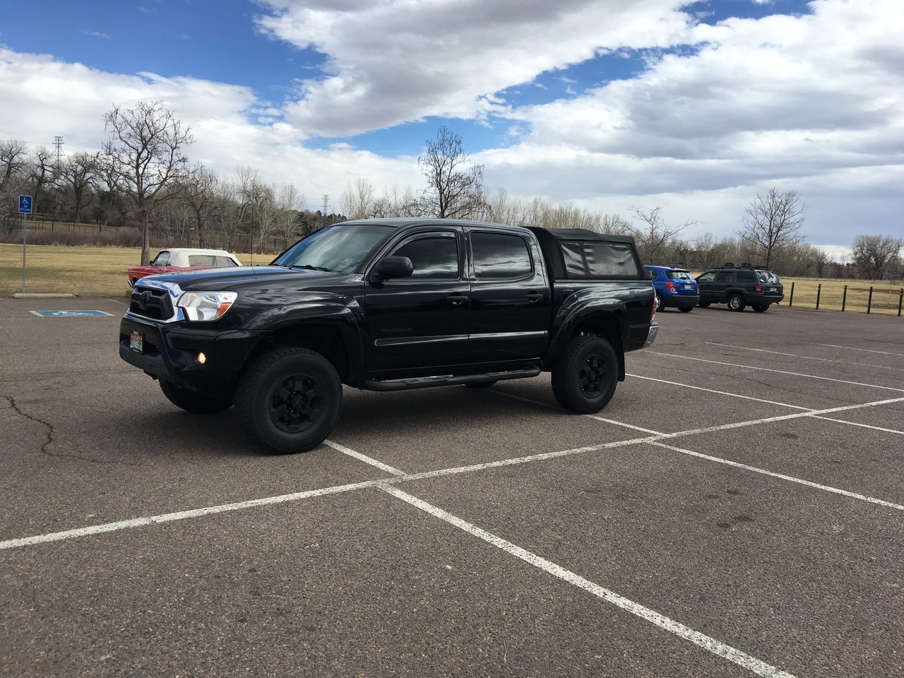

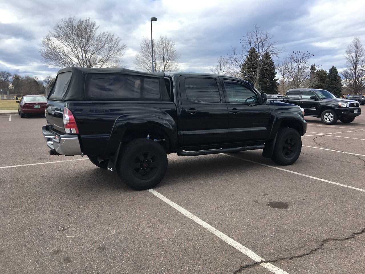

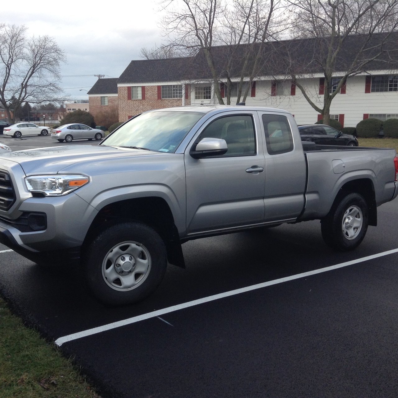

    Hey Tacos in Gensokyo your truck has a nice stance! I bought this trd suspension for my SR 4cyl but haven't installed it yet. How do you like the ride compared to stock? Also any issues, alignment difficulties etc?

    Best money I ever spent on a vehicle. No known issues, needle bearing didn't fail (YRMV) and ride is much nicer than stock. I had a local shop put these in and they had no issues aligning it.

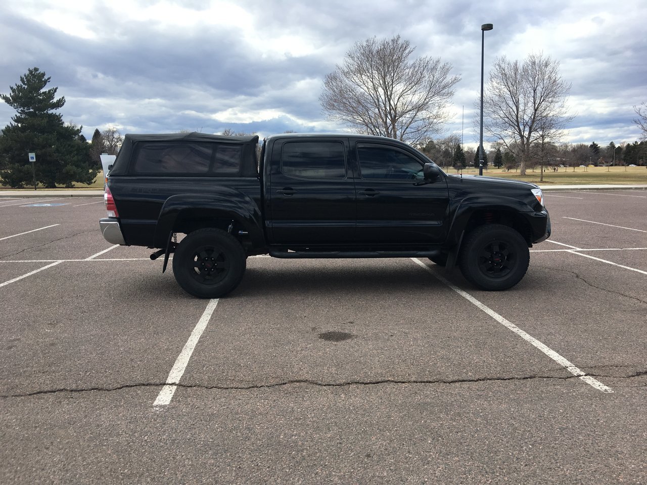

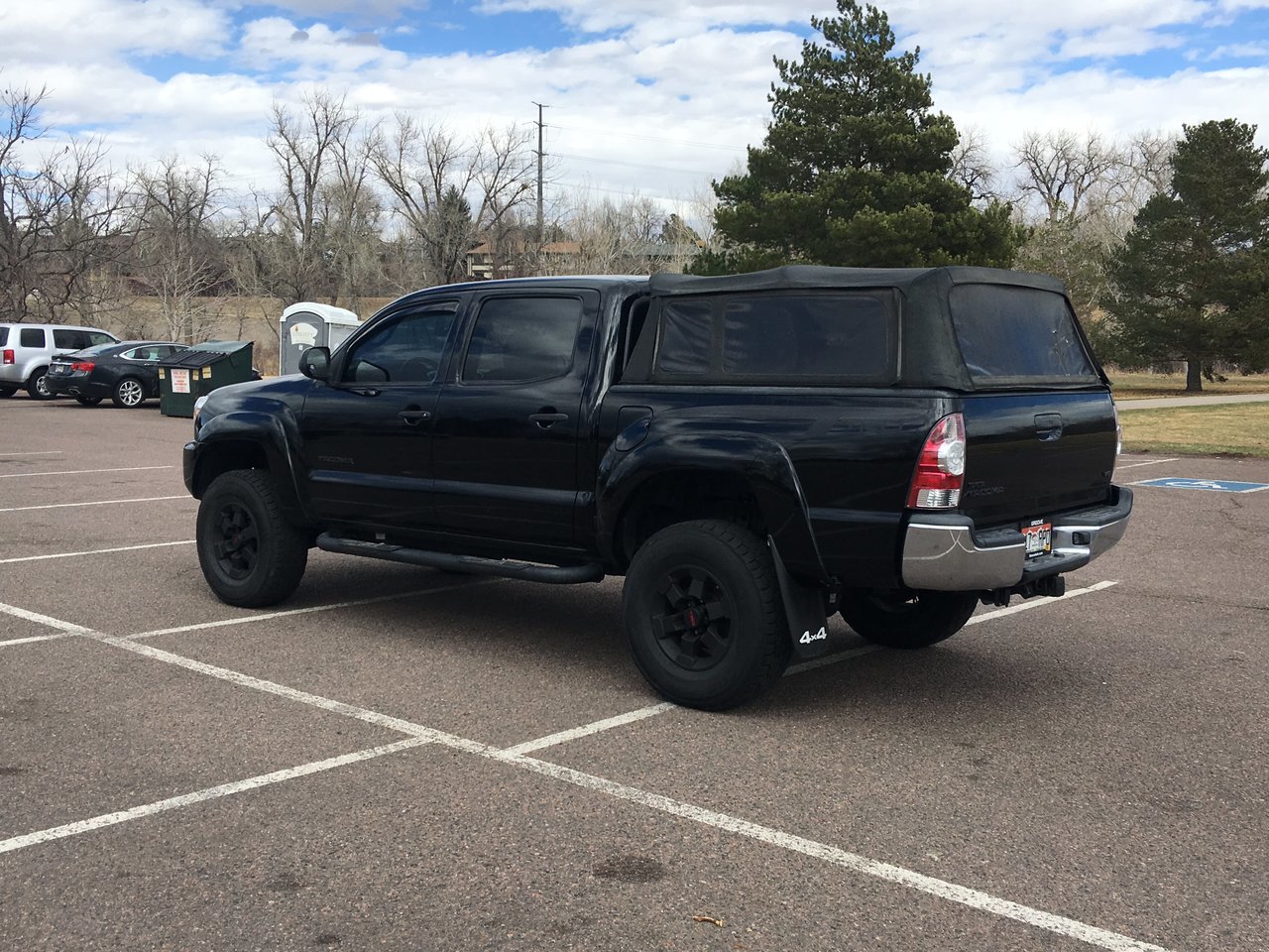

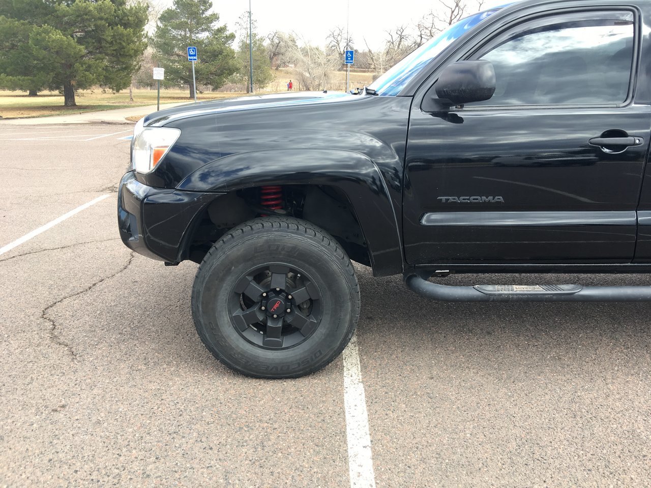

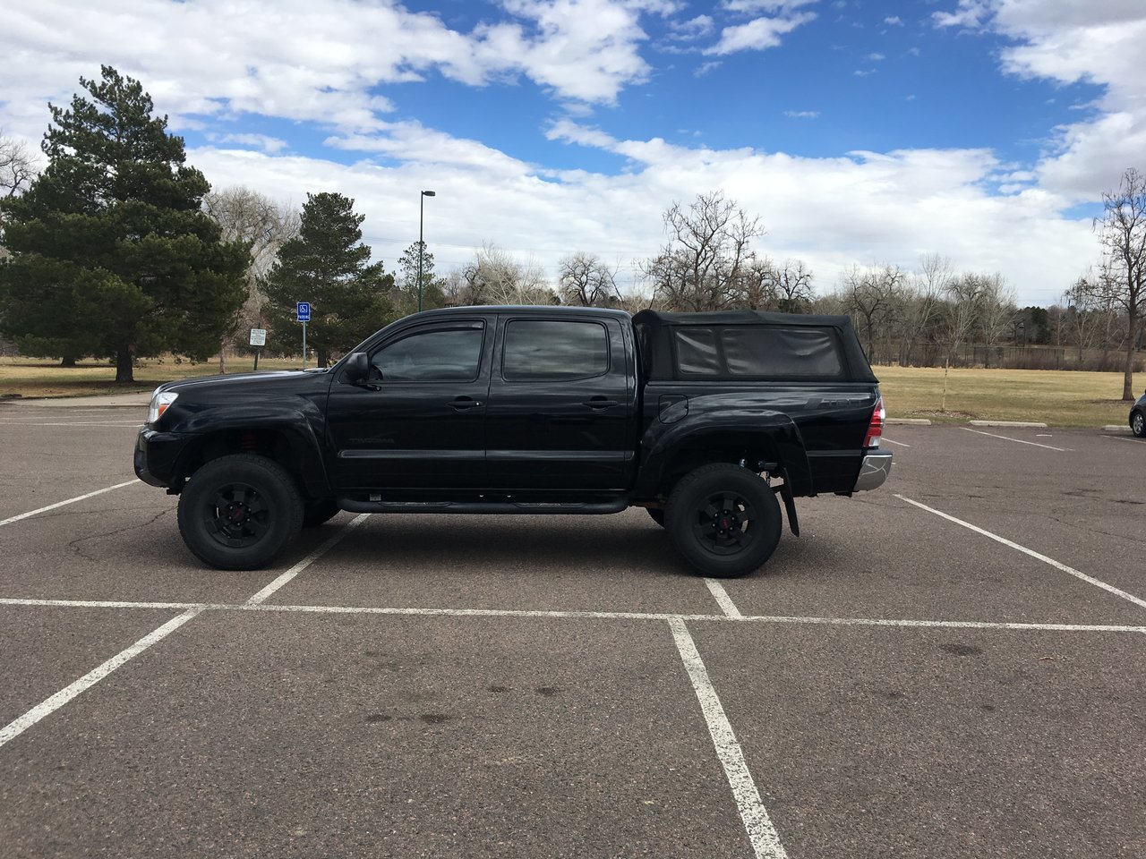

    29
    Anyone know how much lift those spacers really add to the front? I've got the TRD pro baja suspension, but I swapped the rear spring pack with the Icon RXT setup and don't want to end up with a reverse rake situation. Been looking for a thread that has the info, but can't seem to find it. Any help is appreciated.
  11. Aug 24, 2018 at 3:24 PM
    #3051
    CO Ryan
    CO Ryan Well-Known Member
    Jul 14, 2014
    #133913
    1,104
    Colorado
    13 TRD Offroad
    stuff
    See above. 2nd gen, but might help give you an idea. My truck sits pretty level.

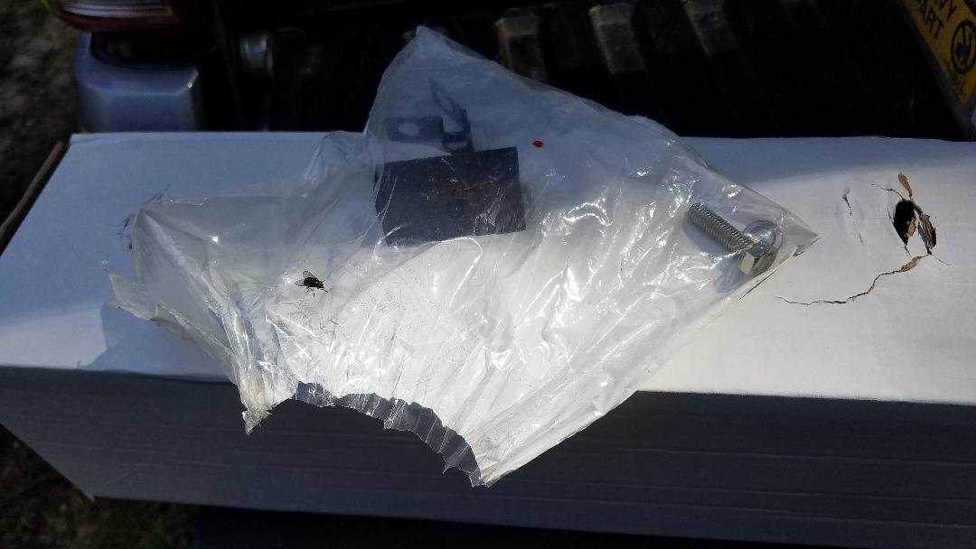

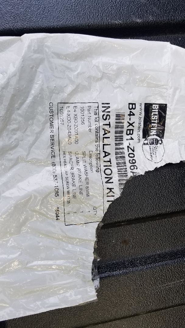

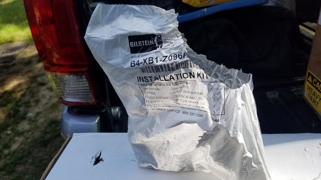

    What came in the box with this kit ?
    I found a single open bag that was separate from the individual shock boxes.
    The bag is marked with: Part # B4-XB1-Z096A (?)
    (Some numbers may be missing)
    It contains the following:
    1- Cap Screw
    1- Washer
    1- Brake Line Spacer
    1- Brake Line Clamp
    I am wondering if this is for front or rear, left or right side and/or if there should be one kit for each side ?
    Can you help ?
  13. Sep 2, 2018 at 9:37 AM
    #3053
    rnish
    rnish Well-Known Member
    May 9, 2014
    #129450
    8,563
    Peoples Republic of Maryland (USA)
    Tacoma 2nd gen
    King's, Camburg UCA, Dirt King LCA, armor
    This is for the Driver side Rear brake line. It gives you another inch so you don’t over extend your brake line. Yes, only one necessary.
    EDIT: Go to post 1083 of this thread. Find the Toyota Pro Kit installation instructions. Go to page 7. They are discussed there.
    Frito[QUOTED] likes this.
