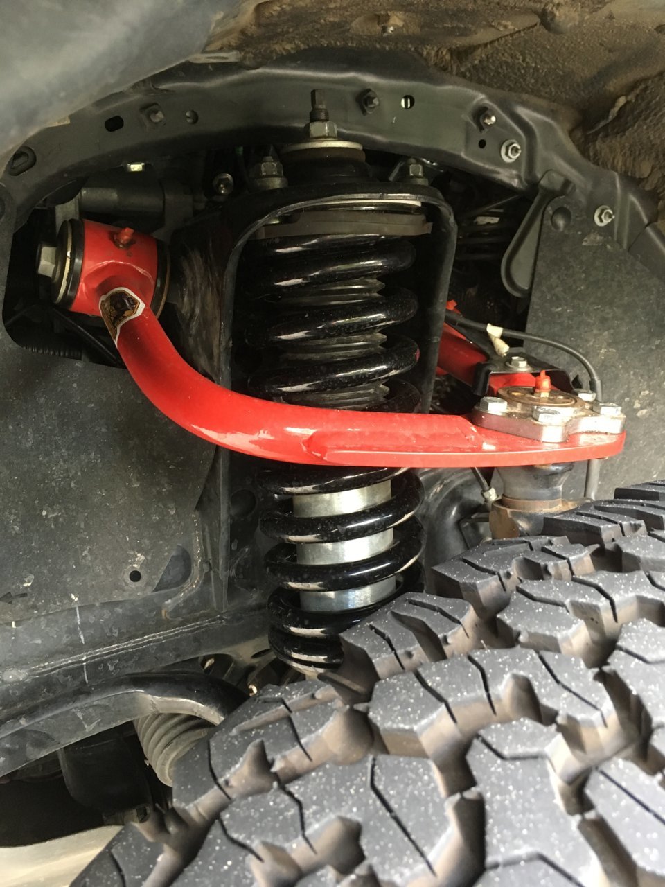

    I installed the SSO slimline hybrid bumper with a Smittybilt X20 12k synthetic line winch. It dropped the front down quite a bit and the suspension felt pretty soft. I upgraded the springs to Eibach 650lb and I got the lift and ride quality back! :thumbsup:

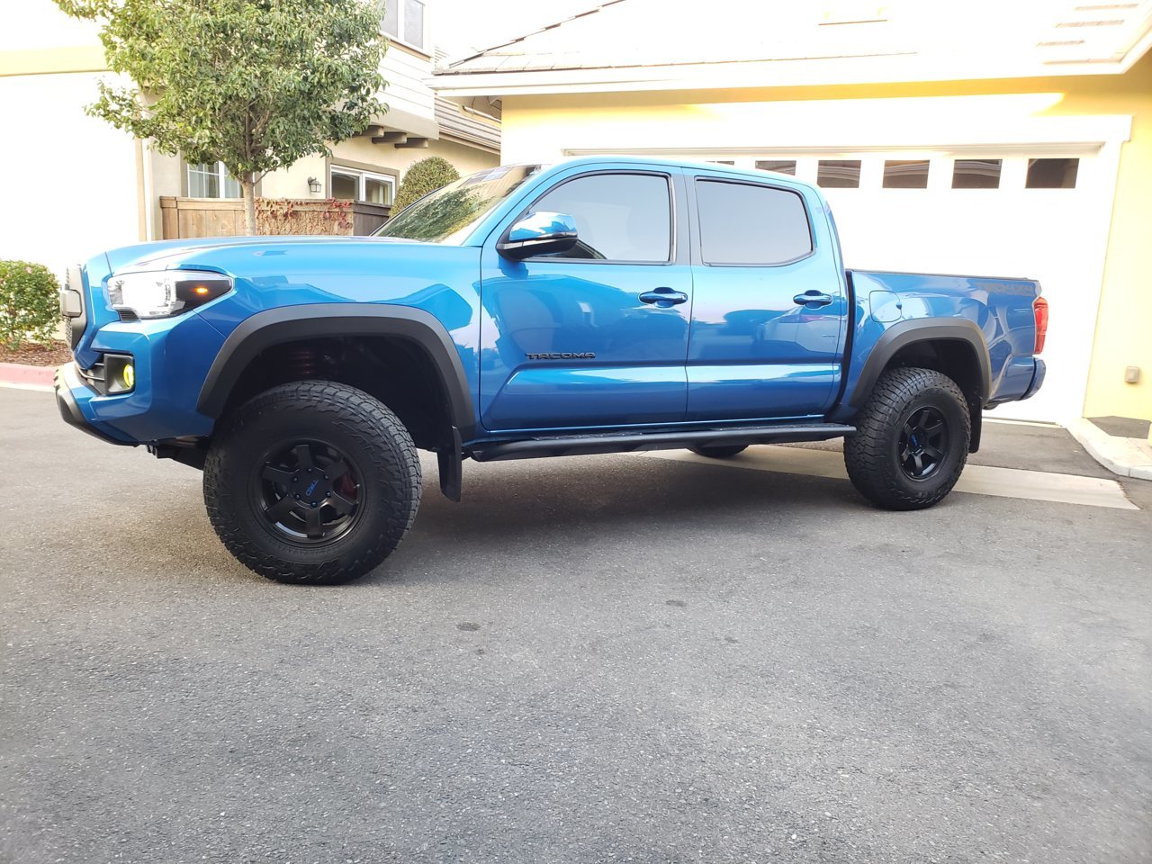

    Just to add some more results to this thread, I installed mine this weekend, picked up just the fronts from a member here locally. They leveled the front about 1.5”. Sitting about 36.5” ground to fender on all 4 corners. I imagine they will settle a little. Looking at ordering some 5160s for the rear.
    Before:
    After:

    What color are the eibach 650lbs spring you upgraded to? I want to upgrade my springs but I want to get red coils

    I couldn’t find red ones. I went with the black ones from Wheeler. They complement my red JBA UCA’s pretty well.

    Ahh so you tried getting them red as well :thumbsup: I’m getting jba uca for Xmas so maybe I’ll do black coils as well...can you post a pic of your wheel well? Thanks in advance @noexcuse4you
