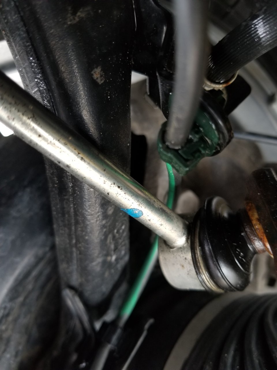

    I figured out part of my noise. The sway bar endlink is hitting the upright. I'm going to disconnect it and see if it gets away to confirm.

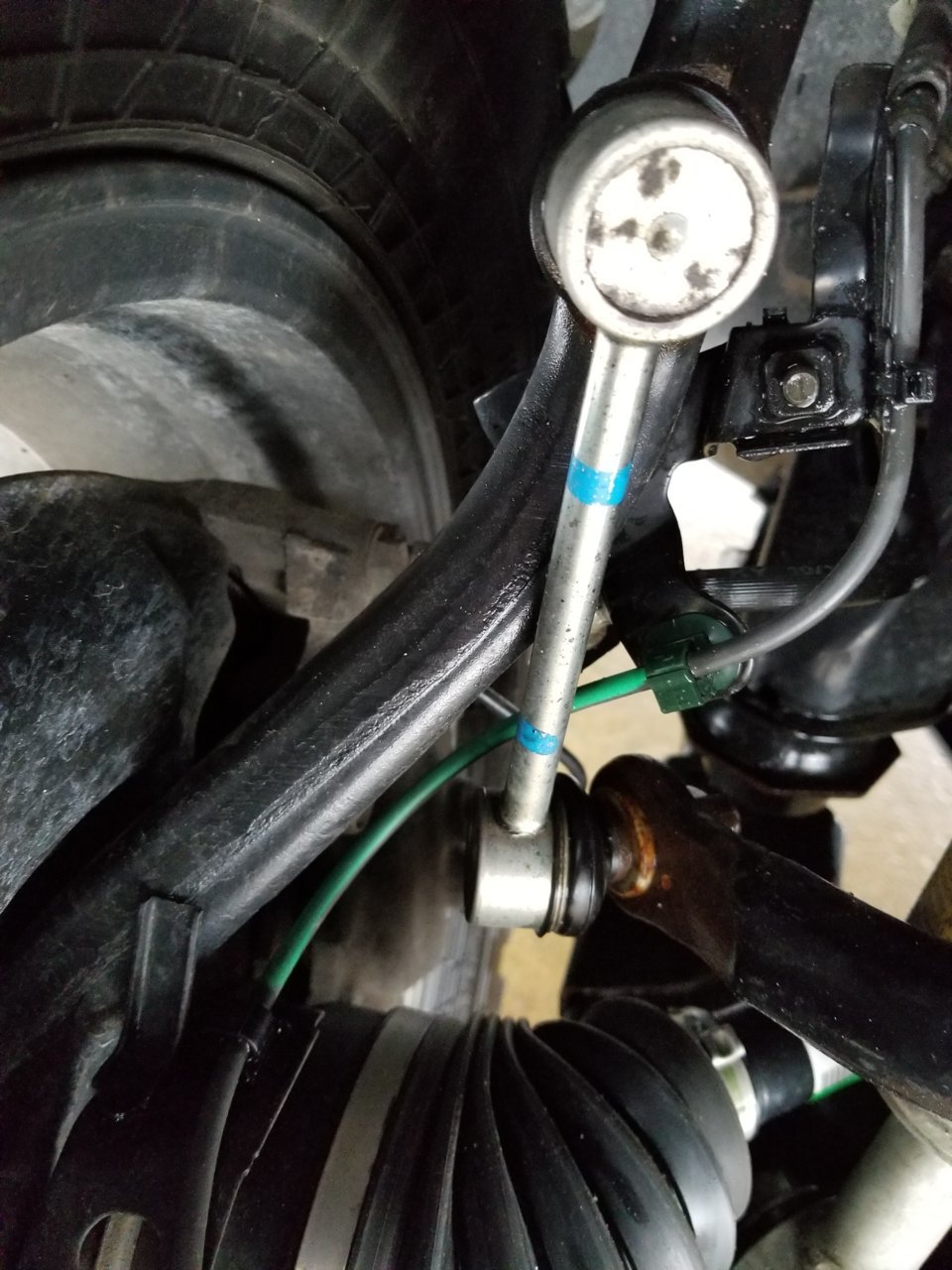

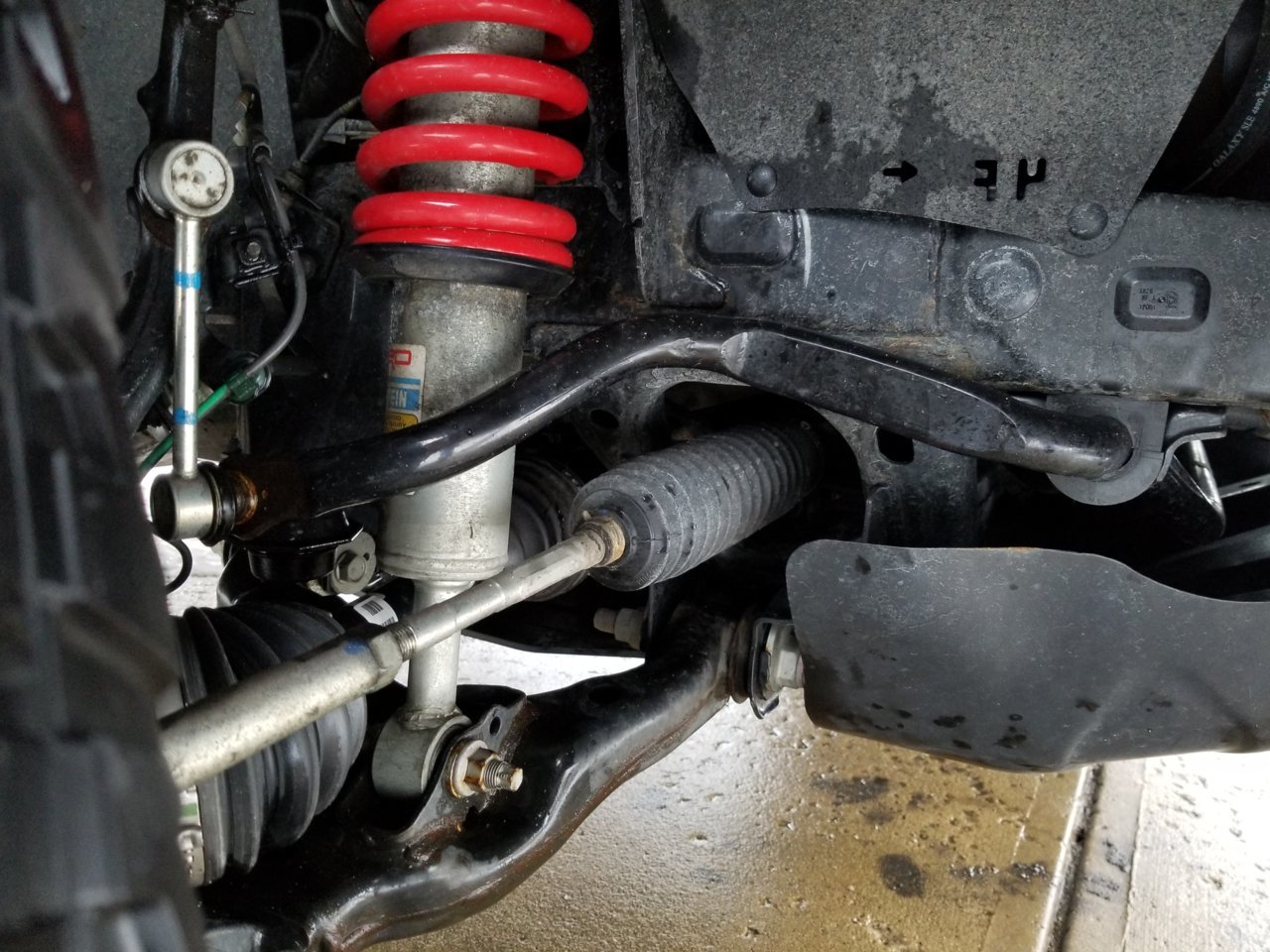

    @MikeyMcFly
    Ok so here are some pics of my truck on level ground side to side, but pointing downhill. Now I hear and sometimes feel my clunk clearly up front. I did have a cluck from my front flaps. I thought with my lift I would be able to go back and run the stockers, no, they still rubbed. Removed and have other clunk still present.
    My noise clearly started on the driverside front and now I get it on both sides fairly easily. Even the slightest irregularity in the road gives me negative feedback. I can also get a clunk simply turning the wheels on what seems to be smooth pavement. If I turn and hit a bump it still clunks seemingly all the same.
    I had to re tighten the end link mount driverside as it somehow came loose after 2-3 weeks, it too caused a clunk but was easily addressed. After tightening the mount at the upright (sorry, blanking on the parts name...spindle, hub, end with the tire...) no more problem for awhile.
    As for the pictures, the silver endlink clearly is contacting the upright. I think that endlink at either end is causing my issue on dips and bumps as I think the link is sitting differently from where it was stock and is stressed somehow. If it were to ever quit snowing and or raining here I would spend the 5 minutes and disconnect my sway and test it. I can not leave my sway disconnected as I tow a lot and don't want to go down that road.
    Ultimately my cluck is probably a 3/10 on the noise level and maybe even lower on the feel scale, but it is clearly there and it is super annoying hearing bumps and not feeling them...
    Pictures are all taken with wheels not quite full lock left and right.

    Very interesting. That isn't an area that I would have immediately looked at for interference. I'll have to pull a wheel the next time the weather cooperates and take a look. I'll have to suck it up and roll down a window the next time it's not actively freezing and listen for the metallic rattling as well that I've got.
    I'll keep updating this thread as I eliminate things. I'll have to cross-reference parts numbers later tonight to see if Toyota changed the bar / end links from 2G to 3G, because I definitely didn't have this issue with my 2G, although I wasn't quite as high in the nose.

    I’d be willing to bet the clunk is the pax side sway hitting the shock or spring. Check for rubbing. The eibach kit comes with a sway relocation for just 2 in of lift... I could have not installed it and under certain situations it would have rubbed and ultimately clunked. Remove the front sway to see if that solves it.

    I have plenty of clearance around the actual assemblies. I have no indication of contact there. The spindle interference @Lt. Dangle showed is interesting.
