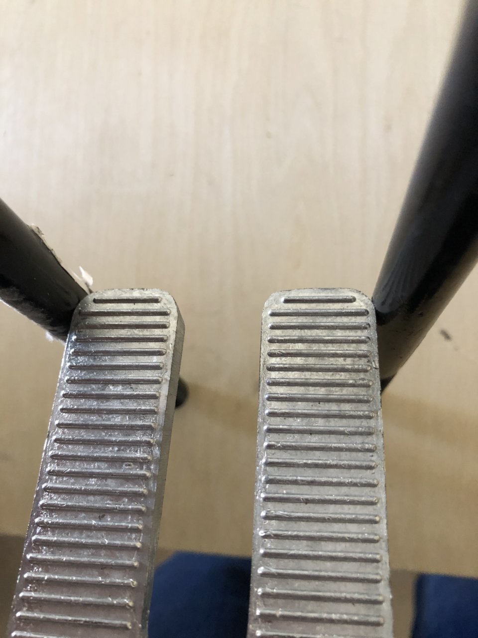

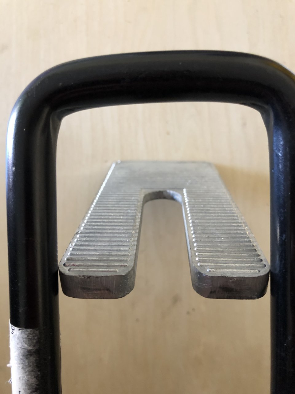

    Those who installed shims I bought 3 degree from headstrong off-road and they seem a bit wider than the UBolts. Couldn’t squeeze them in there they are wider then my leafs! Am I supposed to grind the sides down to get them to work!!!! I tried hammering it in there but won’t budge.

    You can, won't hurt anything. Guessing they sent you Tundra shims.

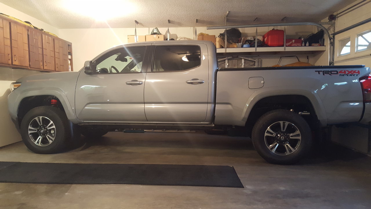

    @Ran-TRD

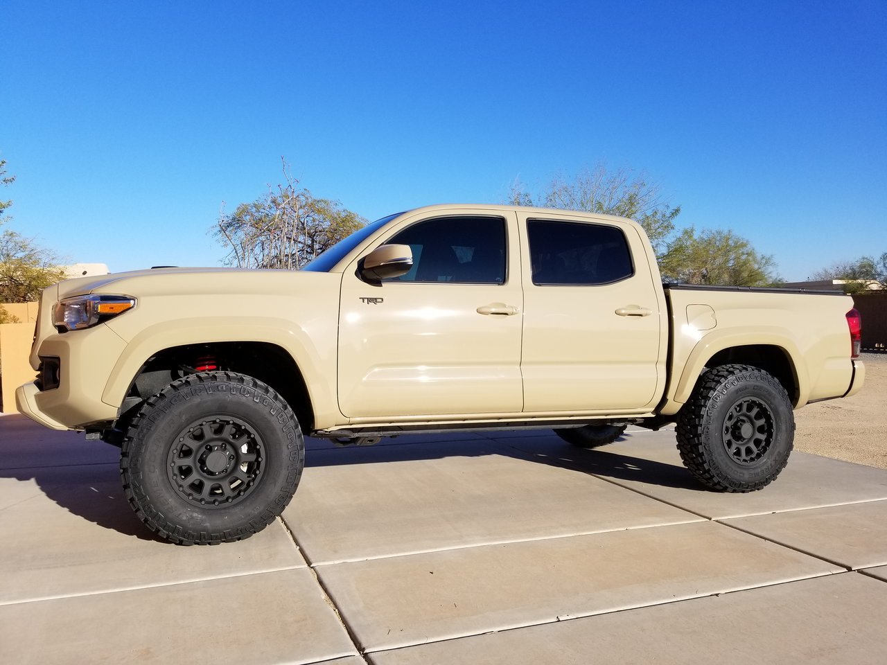

    Here is my truck with the Bilstein Pro kit installed, along with the HS 3 leaf AAL and factory OL leaf. Tires are just 265/70/17

    Very nice. Glad to see it still looks level with that AAL. I’m thinking of just a single AAL if I get a little too high in front. Dont want the rake either way. I may be towing small trailers in the future as well so should help reduce any squat (I hope). Still waiting for the guy to ship my kit to me from ebay. Was hoping to install this weekend. Not happening. Makes me very sad...
    Also nice to see that the standard size wheels and tires look good with that lift. I do not plan on going bigger, done that twice with 4Runner and an FJ and bitched and moaned about mpg both times.
    Some off road tires will be plenty I think after these stock OR tires get worn enough

    Looks may be deceiving. The rear is actually right at 1.5” higher than the front. For me, that’s how a truck should be. I use my truck as a truck. The last thing I want when towing or with a loaded bed is to be nose high bro-stancing.
    I’d agree though that the 265s do look proportional with the meager lift. Although I still only get about 15-16 mpg :notsure:
    I’ll likely be going to 285s when these wear out.

    Agreed!!! It is amazing how pictures are deceptive. THanks

    Man that looks good ! My dilemma is I’d like to fill in the wheel well just a bit more
