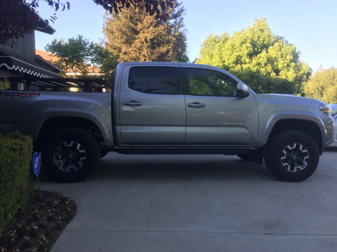

    B833CE2D-9CD4-4919-9A79-A4925E85B4C7.jpg Finally installed the 2nd Gen TRD Pro package today. Wife was out of town (her truck) so a little surprise for when she returns tomorrow. It is a 18 Sport with 16” OR wheels (I just like the look and size better, and not buying wheels anytime soon). 265/70/16 tires. I dont care about the change in lift. It isnt even settled yet. Put maybe ten miles on it. Love the ride. Takes a big hit easily and no more bouncing which I hated. OEMs are Hitachi shocks from Mexico?? OMG Toyota. Very happy I did this and pretty as well. Able to do myself with the instructions and Im a lightweight mechanic at best. Bought the set, new in box, off ebay for about 750, from a guy who bought in ‘17 when toyota was clearing them out. His receipt was still in the box.
    Thanks for the posts guys as that is what helped me buy this setup, saving me a bunch off the Icons I was going to get. Im happy
    Not sure why the 05 pix showed up but oh well

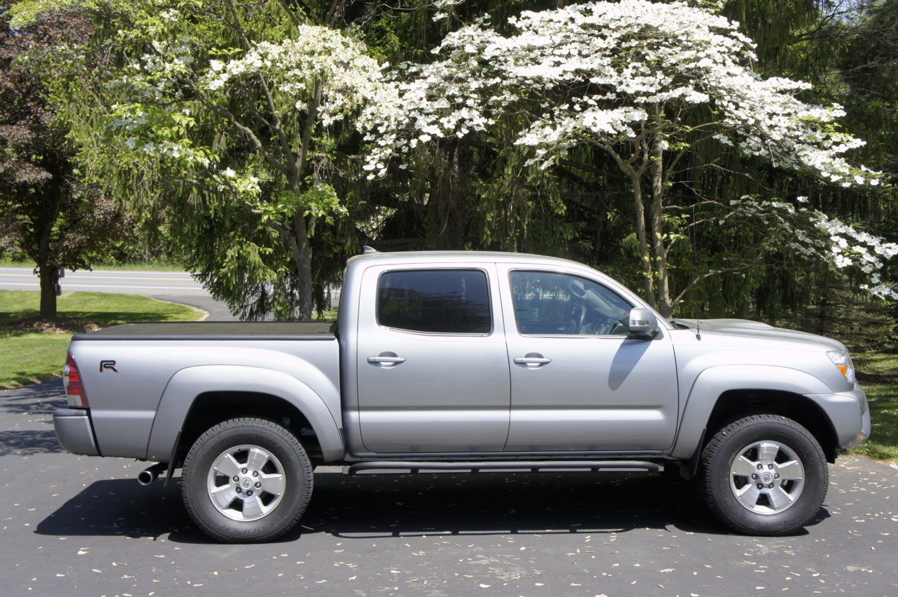

    I like the additional stiffness of the front end. I thought my Sport wallowed in the turns. Also the additional lift looks good.
    Stock
    With lift & 1.5” blocks on rear.
    With OME 95R leif springs on the rear.

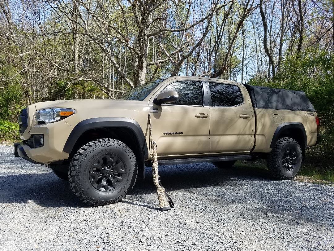

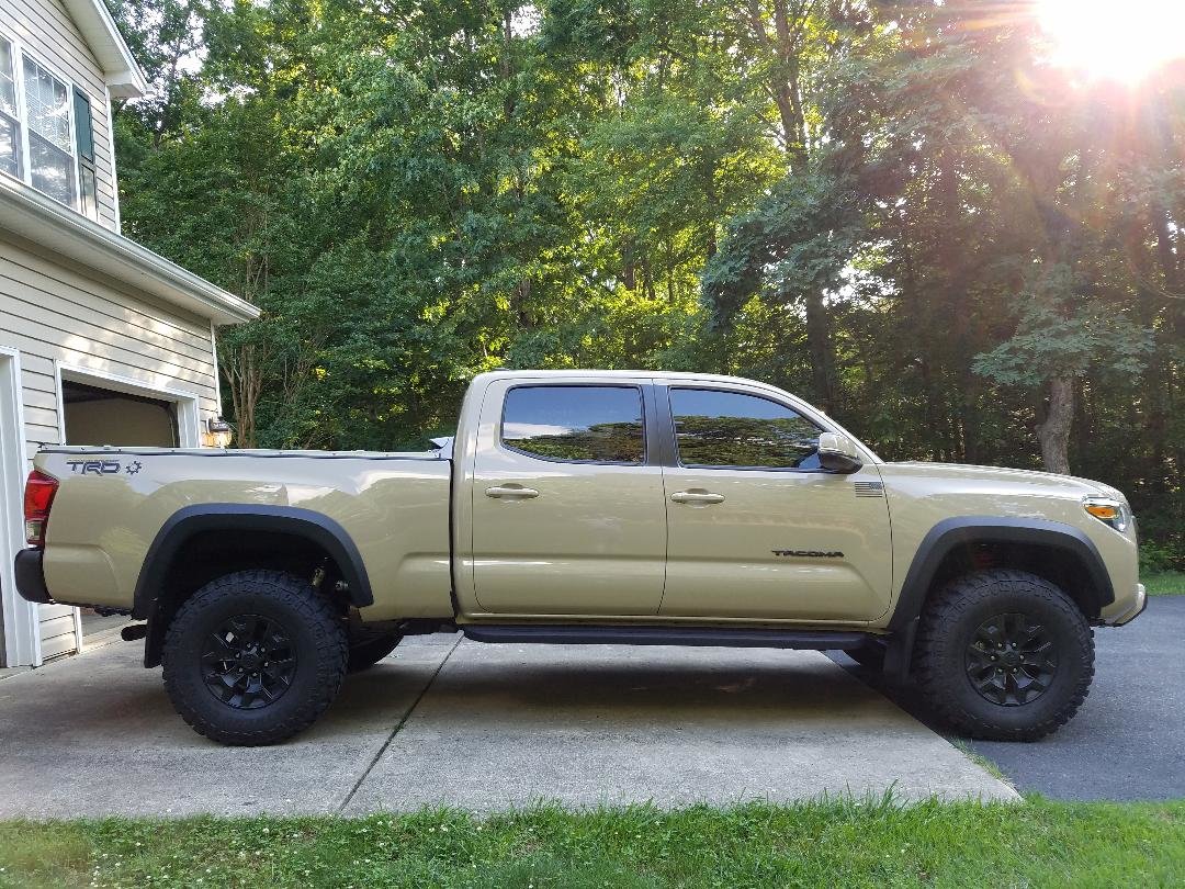

    Here are a couple of pics of my setup with DC Extreme Country 255/85/16 on stock OR rims. I left the O/L in when I installed the AAL though.
