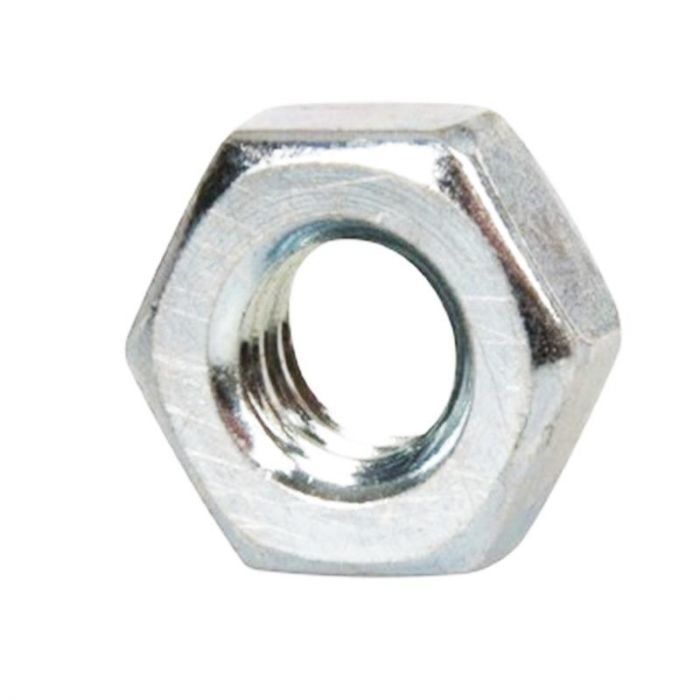

    same question. These nuts linked from wheelers are the lower profile ones that will save me from having to put in longer studs, is that true? He mentioned finding ones himself at a hardware store.
    Because an SST nut actually looks more like this I believe:

    Yes, these allow full thread contact with a 1/2” spacer with current studs. You can get SST (stainless steel) nylon lock nuts in the correct thread pitch at places that have the large nut and bolt selection like ACE Hardware.. The Wheeler nuts above are grade 8 and a little stronger than the SST ones. I have both, but I wanted to try the SST first to avoid rust issues long term. So far they are working just fine and haven’t budged, still at correct torque a year later.
