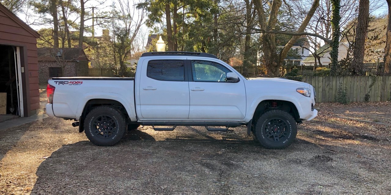

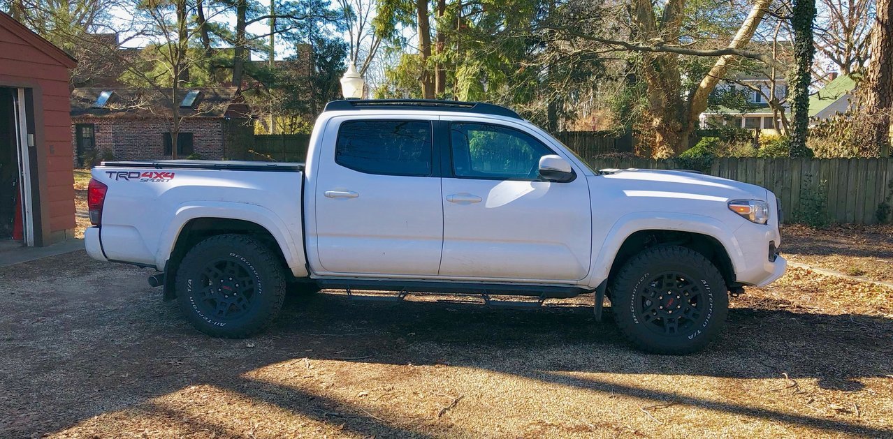

    Only fronts have been installed so far
    Pre-lift measurements:
    Front Driver: 35.0 in
    Front Passenger: 35.4 in
    Rear Driver: 36.0 in
    Rear Passenger: 36.0 in
    Post-lift measurements:
    (measurements made after driving around about 4 miles)
    Front Driver: 37.12 in
    Front Passenger: 37.25 in
    Calculated Front Lift:
    Driver: 2.12
    Passenger: 1.85
    Considerations: Probably needs more time to settle. Initial measurements made with cold air in tires (10 deg F), temperature after install 35 deg F plus heat generated from driving around.
    Picture time:
    Before:

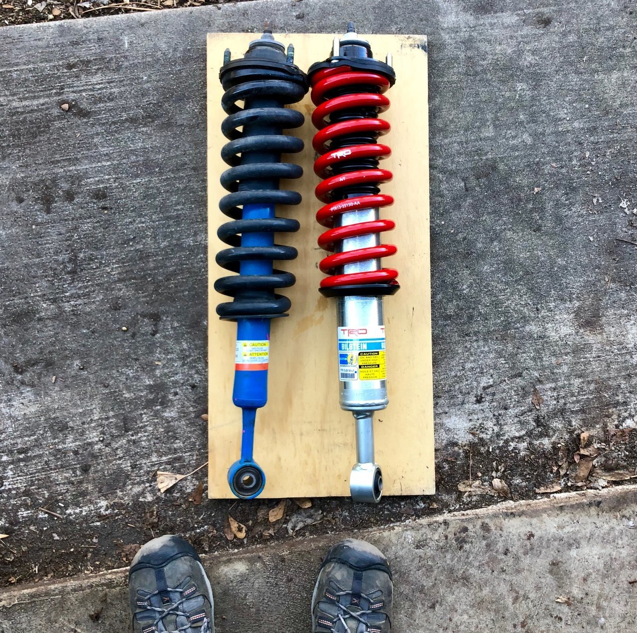

    Bilstein vs. Hitachi sport

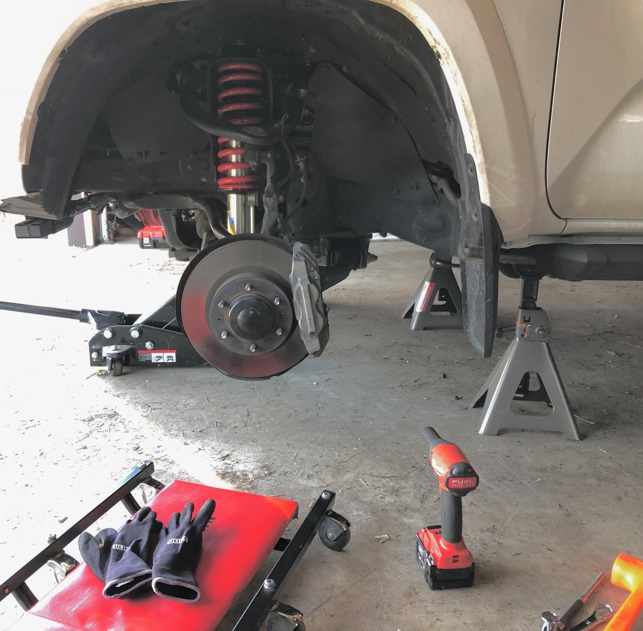

    Mid-install
    After:
    Comments:
    I am definitely nose high by about 1 inch. I don't think settling will bring me back to level. I will be adding a 3 leaf add-a-leaf from wheelers to bring back some rake. No feedback on ride yet. Ive only driven a few miles.

    Thanks for the info. It looks like people who only want to be level will still need something out back.
    Once you've put a few miles on the set can you snap a photo where the truck is on level ground? The photo you show is great but the slope hides the nose-high a bit.
    Looks like a rear lift may be in my future sadly.
    Truck looks awesome tho.

    You sir are the MVP of this thread!
    Seems like it will settle to give you 1.75" lift
