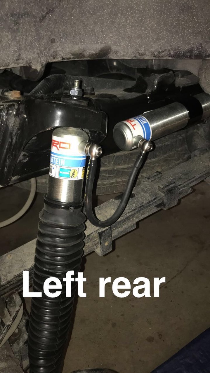

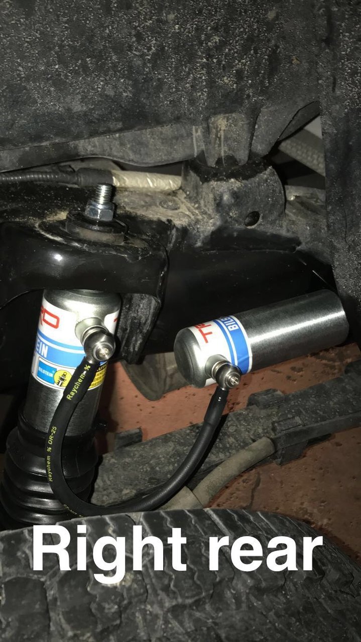

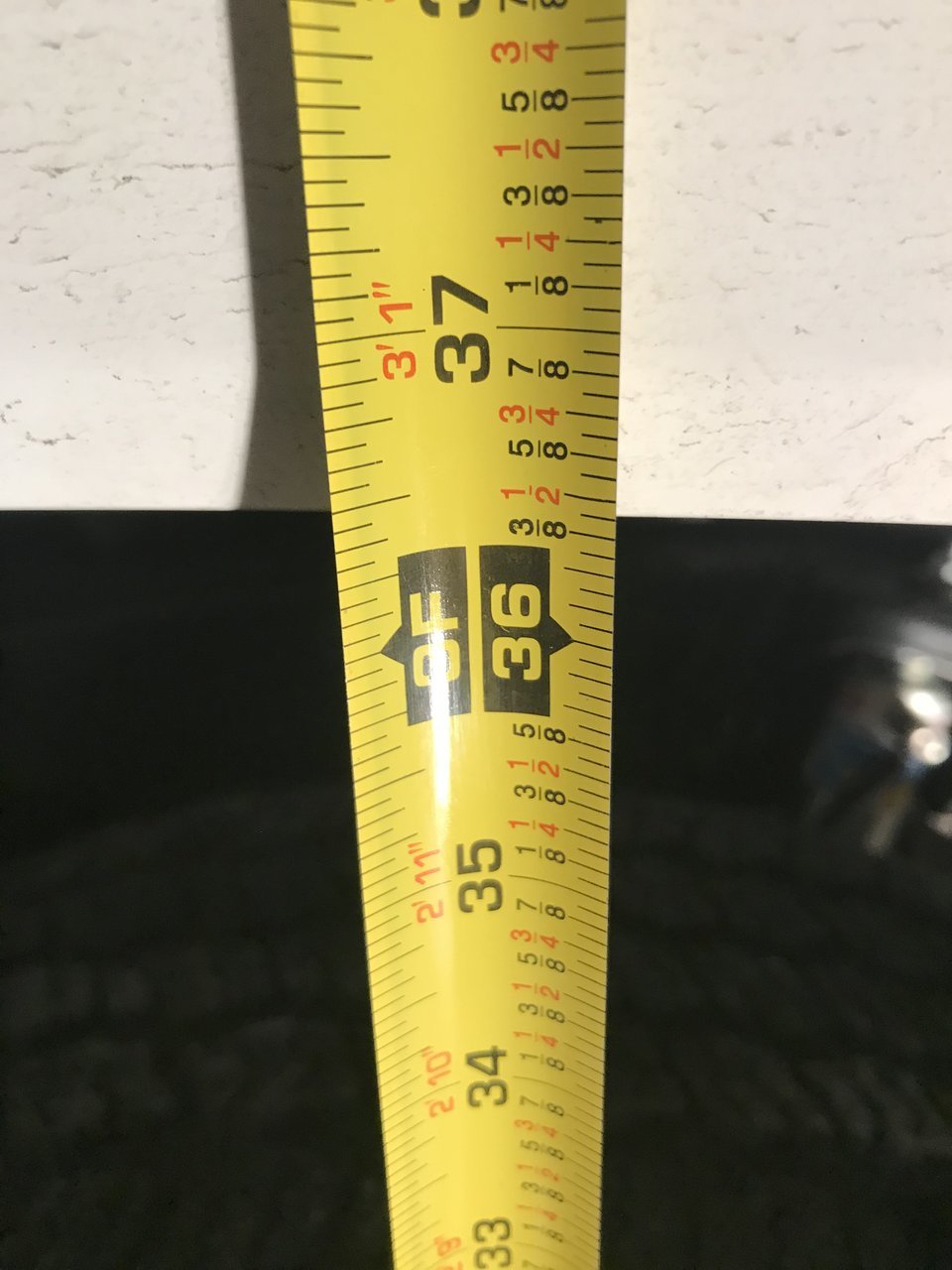

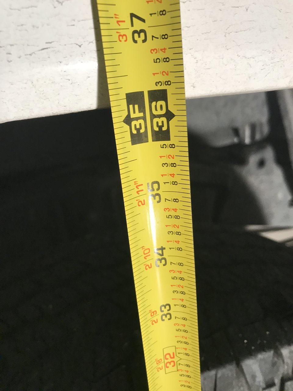

    996FA63D-B922-443A-B327-BC5EB6683943.jpg E86DA99B-E505-4941-958B-B099AA2A3691.jpg Rears of this kit on my 2016 Sport. Running 2017 Pro wheels and tires. Measurement is passenger side without driving before and after.0B03295F-FCF2-46E1-91DD-D218A47BFF22.jpgE67783A3-FE15-48ED-B2DE-A7594CF6E450.jpg

    So a total of a 1/4 inch?
    I want to see some more numbers. Hopefully others will chime in soon with measurements and driving impressions because there seems to be some confusion.

    I think those are rear measurements... so essentially no difference before and after lift as expected.

    And about an inch lower than the front.
