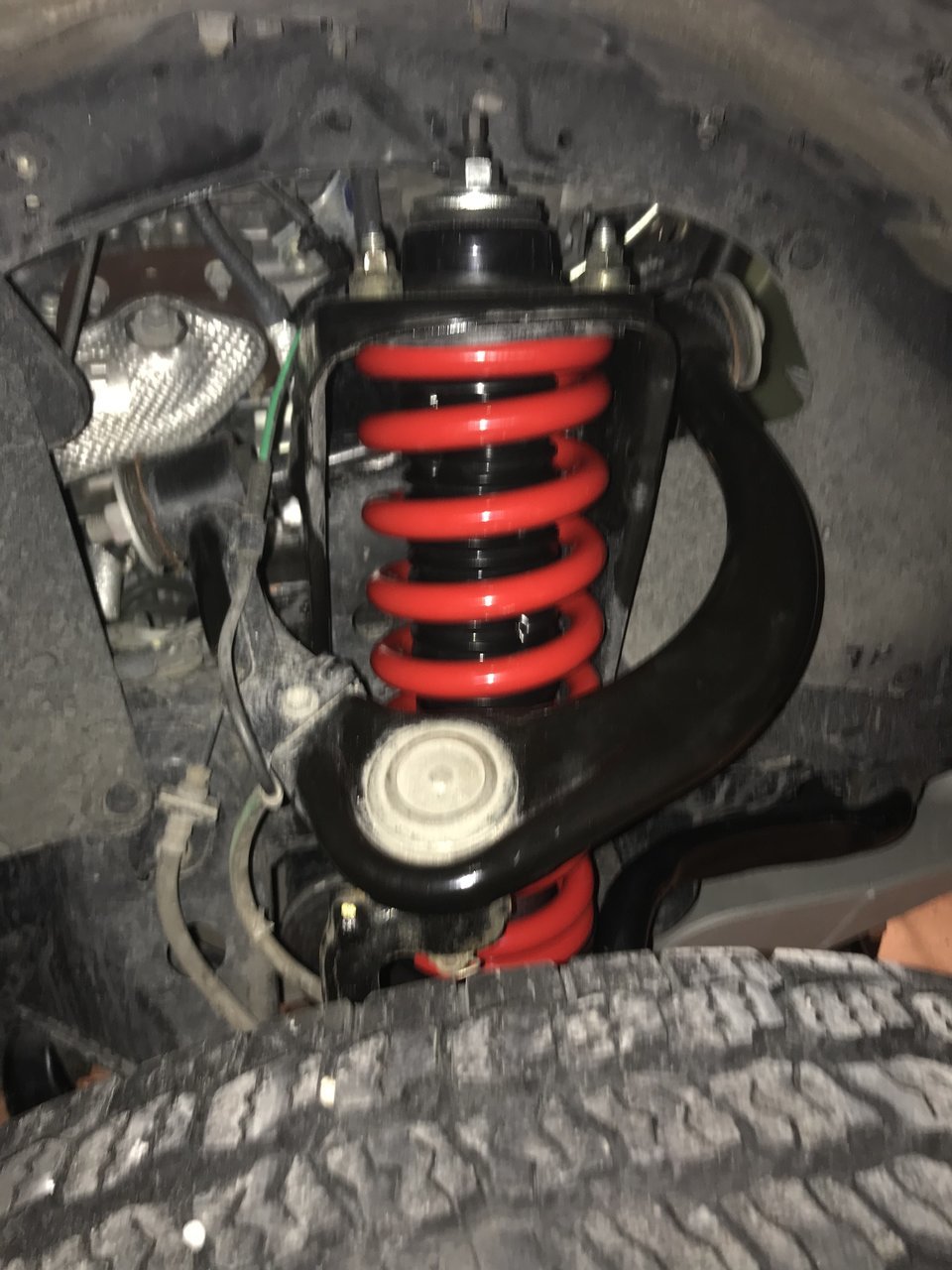

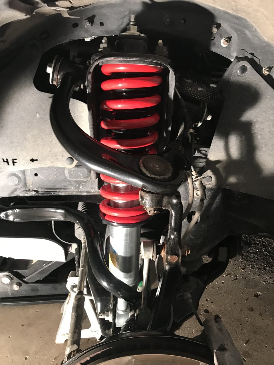

    3763B32F-DB6D-467B-BC02-E24070A66DC3.jpg D1CD93F6-B35D-428B-A12F-E315CD647278.jpg
    Finished the fronts today, forgot measurements, but agree with ones posted already. My question for you all is the brake line spacer, I didn’t see a need for a 3rd gen.

    Forgot to mention passenger lower shock absorber bolt was a bitch, needed extra set of hands from a buddy. Driver’s side was easy. Few pics.

    Just the opposite with mine, driver's side was a bitch, passenger side was super easy..
    It doesn't look like it's needed on a 2nd gen, but I just installed it anyway.
