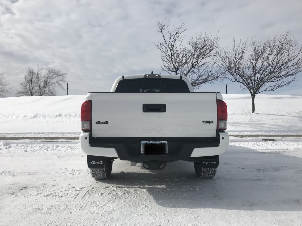

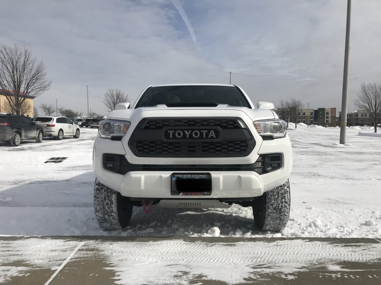

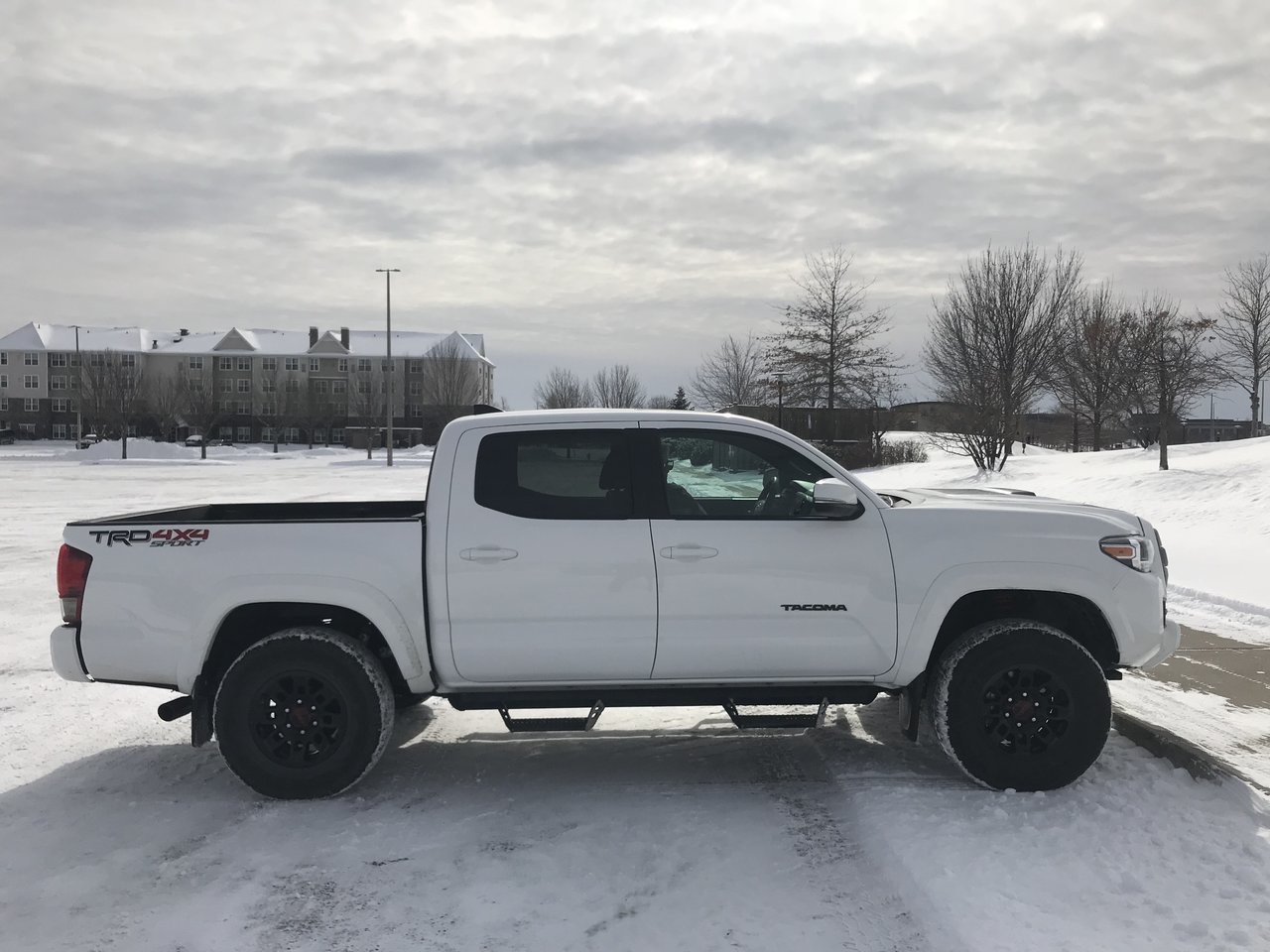

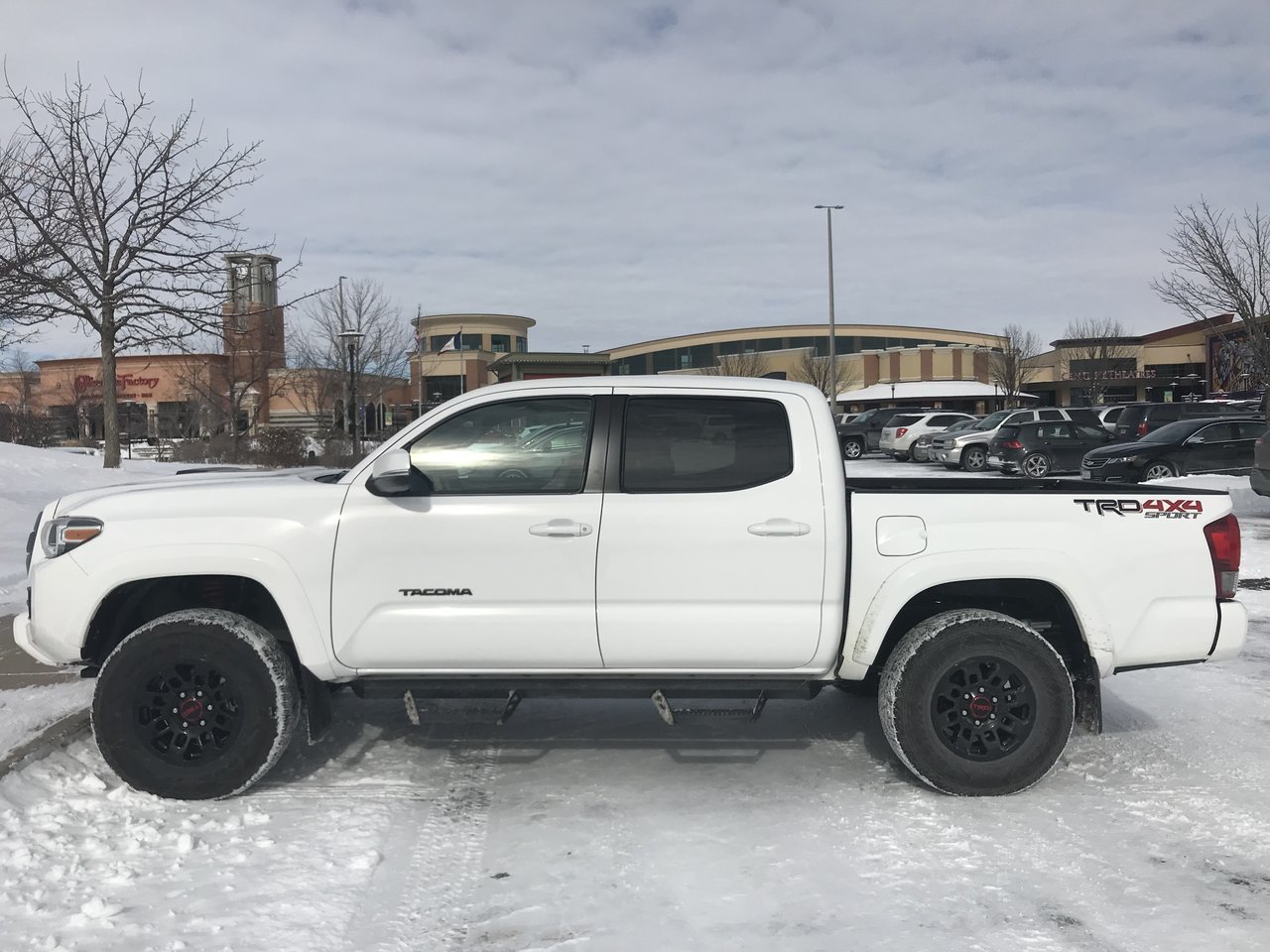

  7. Feb 6, 2018 at 10:15 AM
    #587
    UAL777jet
    UAL777jet Well-Known Member
    Nov 2, 2015
    #168423
    298
    Bill
    Norwalk, IA
    2019 Tacoma TRD Pro Voodoo Blue
    TRD Performance Air Intake
    Here you go, stock 17 Pro wheels and tires.642610C6-4A49-4702-9214-7D0182F80F62.jpg
  8. Feb 6, 2018 at 10:24 AM
    #588
    Sharpish
    Sharpish Well-Known Member
    Jan 4, 2016
    #173981
    3,824
    Brian
    Victoria, British Columbia, Canada
    2012 Tacoma TRD OR 4x4
    It's nose high because the 3rd Gen is already an inch higher in the front than a stock 2nd Gen right? So both generations seem to be getting the full 2" of lift. On a second gen this would likely level it out and not be nose high.
  9. Feb 6, 2018 at 10:24 AM
    #589
    vietjdmboi
    vietjdmboi Well-Known Member
    Oct 6, 2015
    #165979
    408
    Hieu
    Orange County
    '18 Tacoma TRD Off-Road
    So it’s definitely nose high. Will you be doing anything to the rear to correct this or leaving it as-is?

    As is for now. Not towing anything currently, looks fine to me. Might change my mind down the road?
