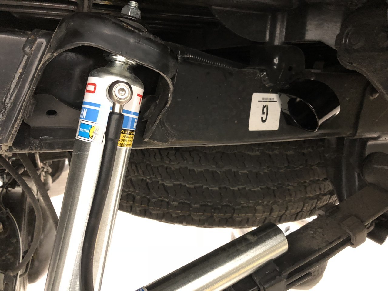

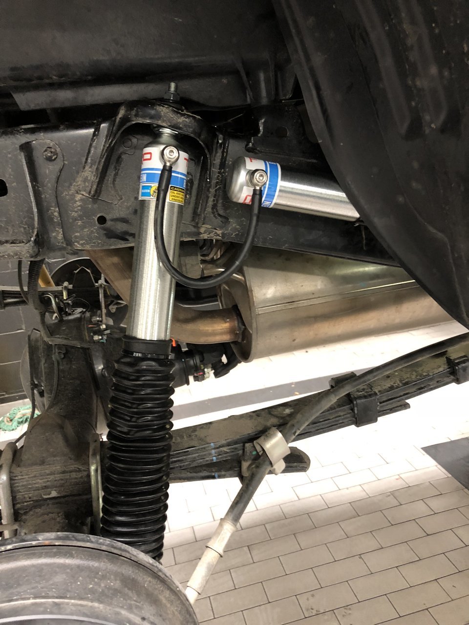

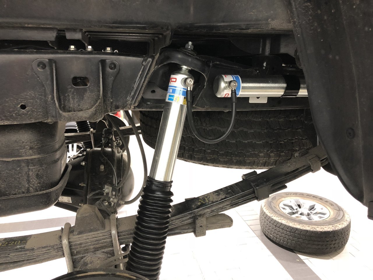

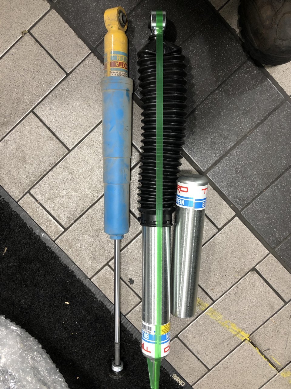

    Ok so update is only did the rears tonight. Just so you guys know if you don’t ask the parts guy at Toyota for the install instructions you can find them at toyotapartsdeal.com. I recommend reviewing them before installing instead of just winging it lol. Some tips for the rear would be put the bottom of the shock in first with the bolt, then compress and slide the top in. Also install the reservoir holders loosely without the reservoir and then slide it in and tighten everything down.

    Looks really nice. Thanks for sharing the pictures!
