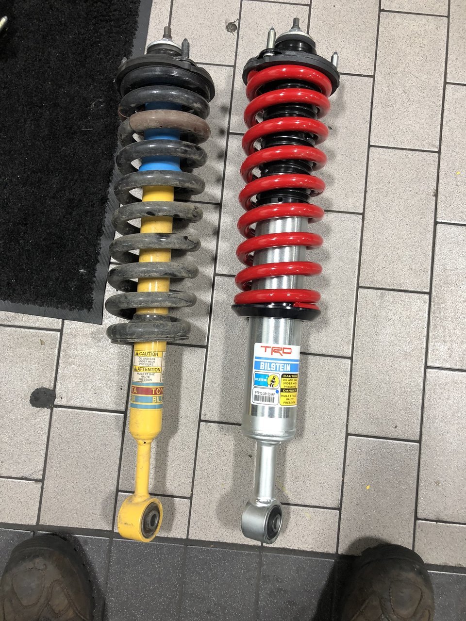

    Just drove it 2.5 miles home from the shop, feels more supple over bumps but I’ll be going back out to the desert in three weekends and will really see how it does

    @Timmcc02
    Great! Seems like you got a bit more lift than other members before settling. Maybe the manual trans?
    Also a bit different that your passenger side remains higher - did you move the clip up on the driver's side?

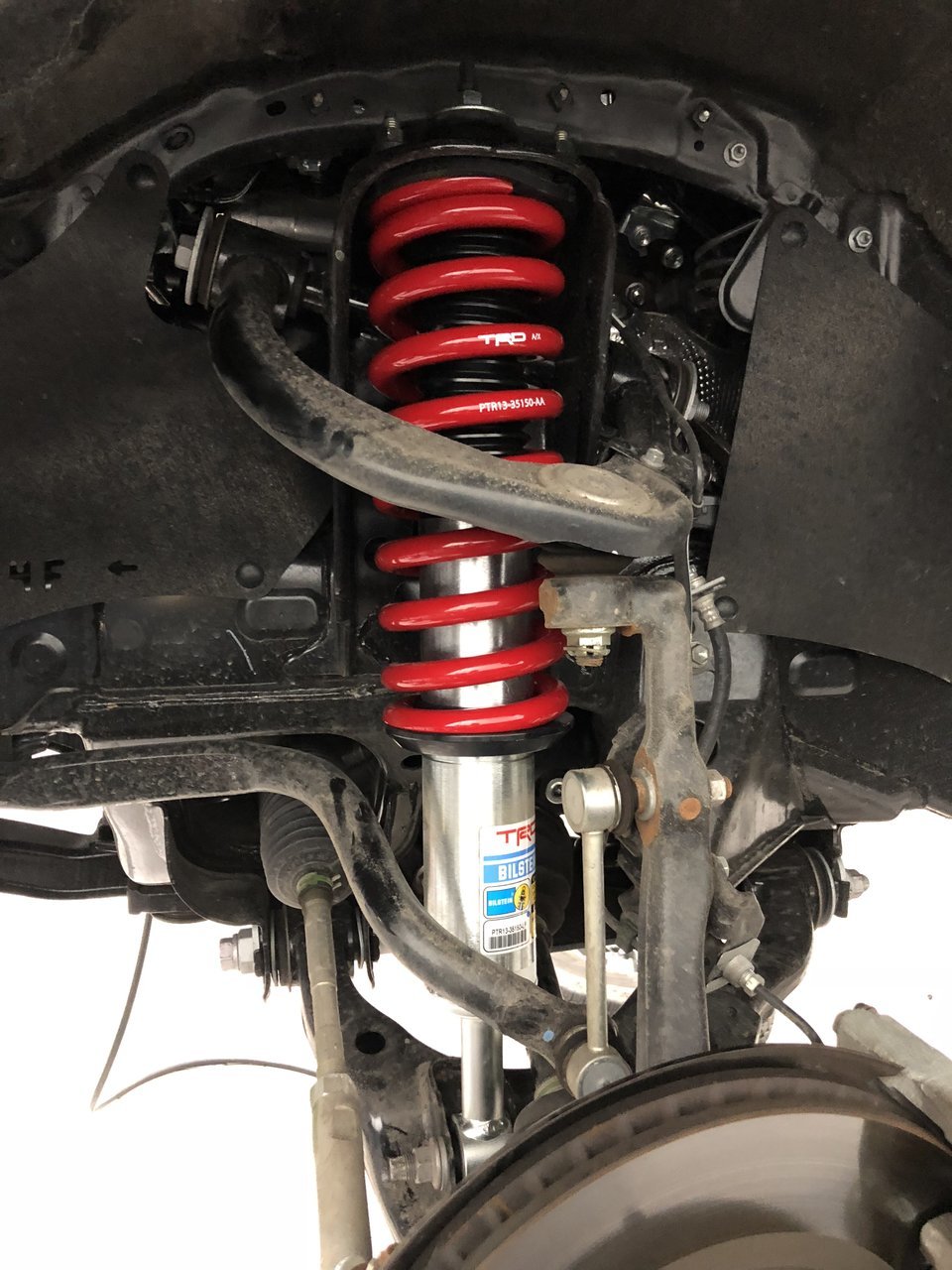

    The part number on my springs went to the back side. Maybe just were they installed the decals? Looking at driver’s side here.

    Keep up updated on how it settles. That looks super tall, significantly taller than @TPC and @pocketsmcaaron trucks.
    You got nearly a 1/2" more of lift there.
    Edit: The bizarre thing here is that 3G coils give a 2G a lift, but a 2G lift is the same on a 2 vs a 3. The coil location must sit higher on the 3G shock, which is why everyone thought (myself included) you'd only see the 0.75" of lift.

    Snap ring is visible on drivers side, like in pic, but on mine part number and TRD decal is not visible. No big deal, just noticed the difference. Made me check directions to see if I had them on correct side!

    Mine installed the same as yours, part number facing inward. The top plate looks like it sits at a bit of an angle based on the shape of the top of the spring. I wonder if this has an effect on ride height.
