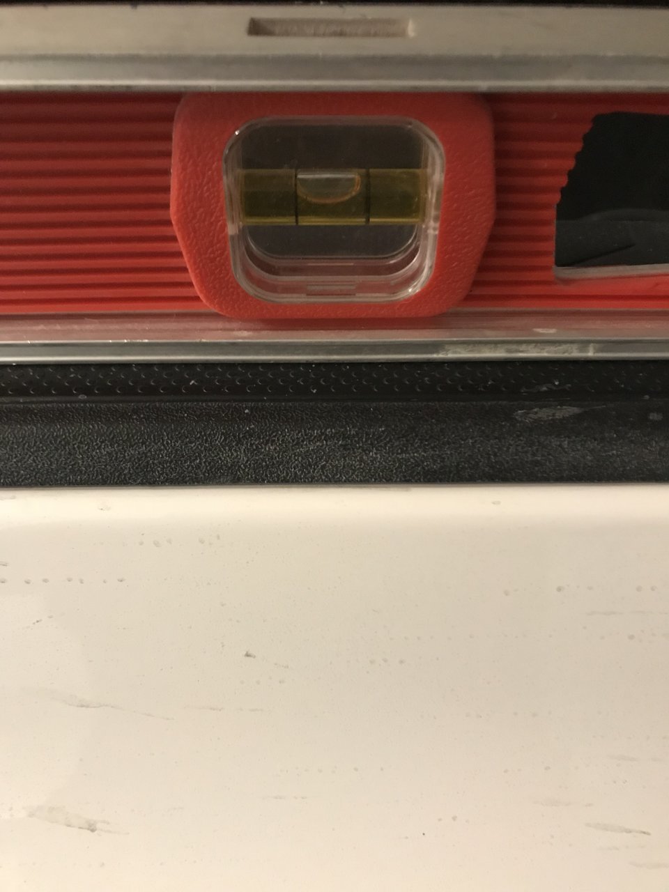

    Okay go easy, this is my first truck and first suspension kit I changed. I understand factory rake and the purpose of it. Question is, if I put a level on the truck bed it shows almost level, maybe a slight rake. Garage floor shows level. Floor to fender flare is slightly higher in the front. To my eye, matches the level. So what do I have, level, factory rake or a Bro Taco? Confused :confused: Left side of level is the front.

    Your pitch is toward the front ......

    The kit was designed to "level" the front of a second gen tacoma, by taking out the rake and from what it seems a lot of the Pros are higher in the front. 3rd gens seem to get the same amount of lift as well, so to get that factory rake back AALs or new leaf packs are more than likely needed. Settling will occur as well over the next few thousand miles as well.

    If you measure from the center of your hub on your front wheel to your fender, then measure from the center on your rear hub to your fender you will see whether your high in the front or have a slight rake.
    If the left side on your level is the front of your truck then you got a bit of bro lean happening.

    Thank you for the explanation. I am fine with level, not towing currently and only a few loads of wood a year. Rechecked garage floor, matches level. So I must be close to level. I will wait a few thousand miles and see if I want to lift the back. I didn’t know the Pro’s were nose high, guess my truck is pretty much a Pro poser anyway with most Pro parts. Wish they had made them in 2016.

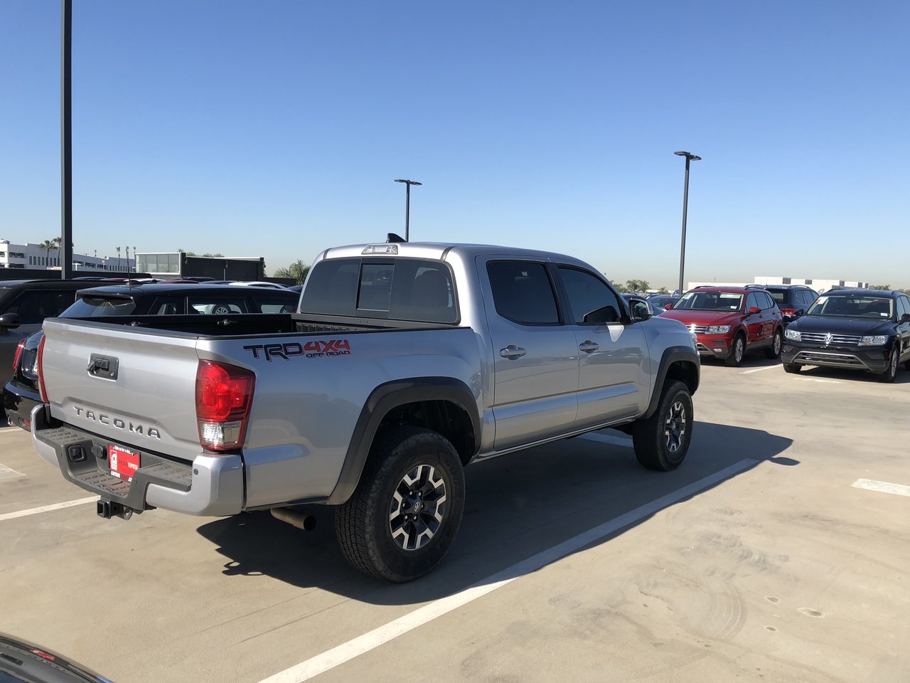

    Update since I got nothing better to do at work lol. Remeasured LF AND RF-36 7/8, LR AND RR-36 1/4. I love the way it’s sitting right now here’s a couple pics...

    Nice! That came down a lot over night. Are you going to add an AAL to bring back the rake?

    Nope, I think I’m going to leave it alone

    What’s your fuel level?

    Timmcc02 Well-Known Member
    Dec 17, 2017
    #238717
    169
    Tim
    2017 TRD OR
    Just under a full tank

    So looks like it came down at least half an inch fairly quickly.
    Still looks great :thumbsup:

    So yours has settled to roughy 1.5ish” over stock height in the front?
