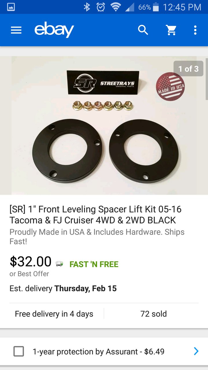

    I saw this on ebay 1" front lift spacer.

    Found this on ebay 1" spacer

    Just get this set for $32. 1" spacer

    There's a spring perch spacer and a top plate spacer. There are 2 different conversations going on right now.

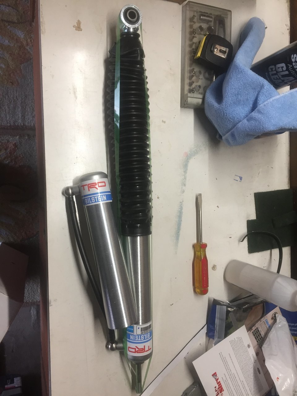

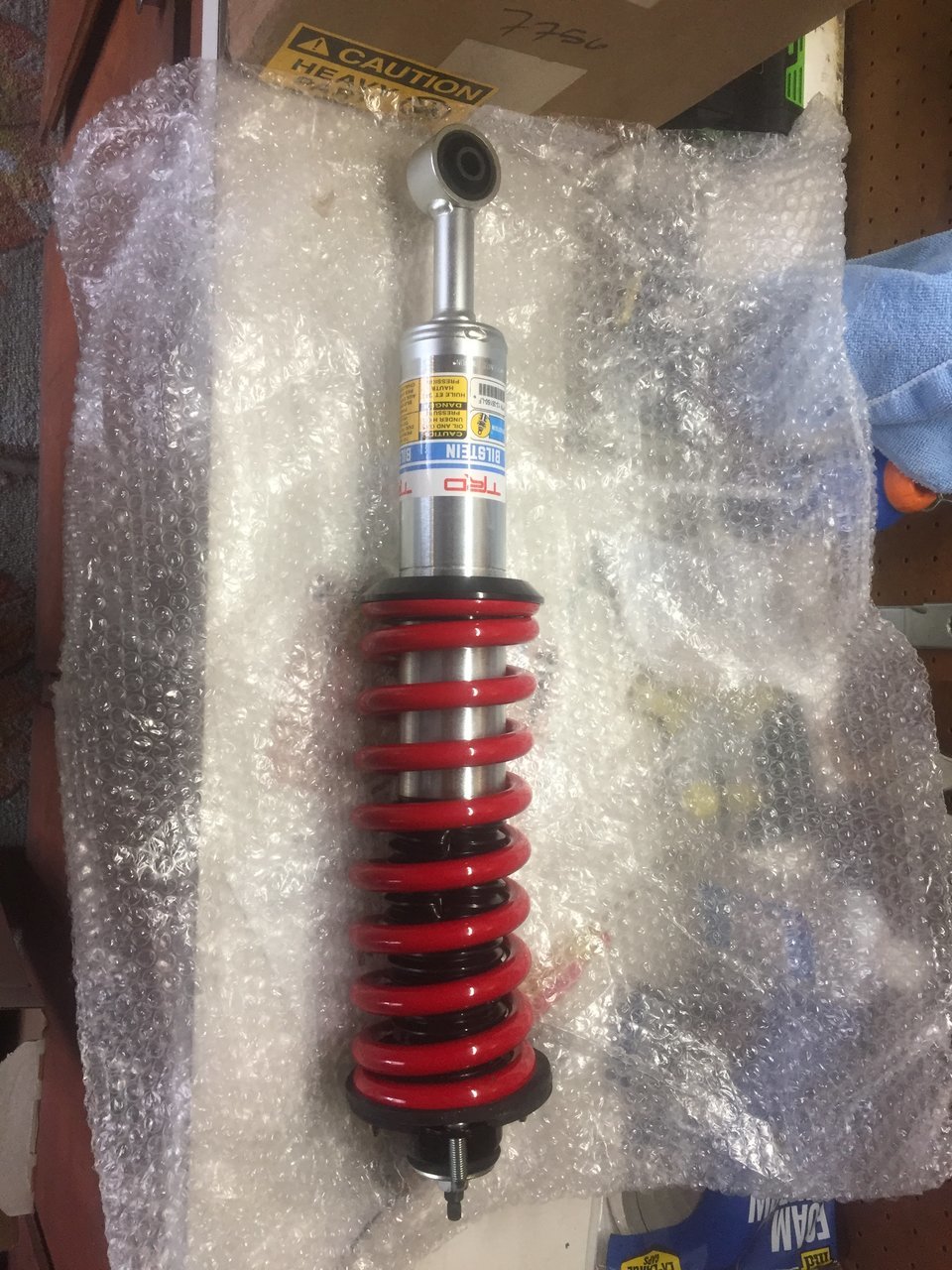

  20. Feb 9, 2018 at 3:57 PM
    #860
    indevo
    indevo Well-Known Member
    Feb 17, 2017
    #210798
    126
    2019 T4R Pro
    56EA5778-EE7A-45F0-AF14-65E37FEBDD1C.jpg 763515C8-9D95-47C7-816C-9899ECB41452.jpg Got my set today. The springs had a couple knicks, deep through the vinyl skin. Not sure whether to be concerned or not?
