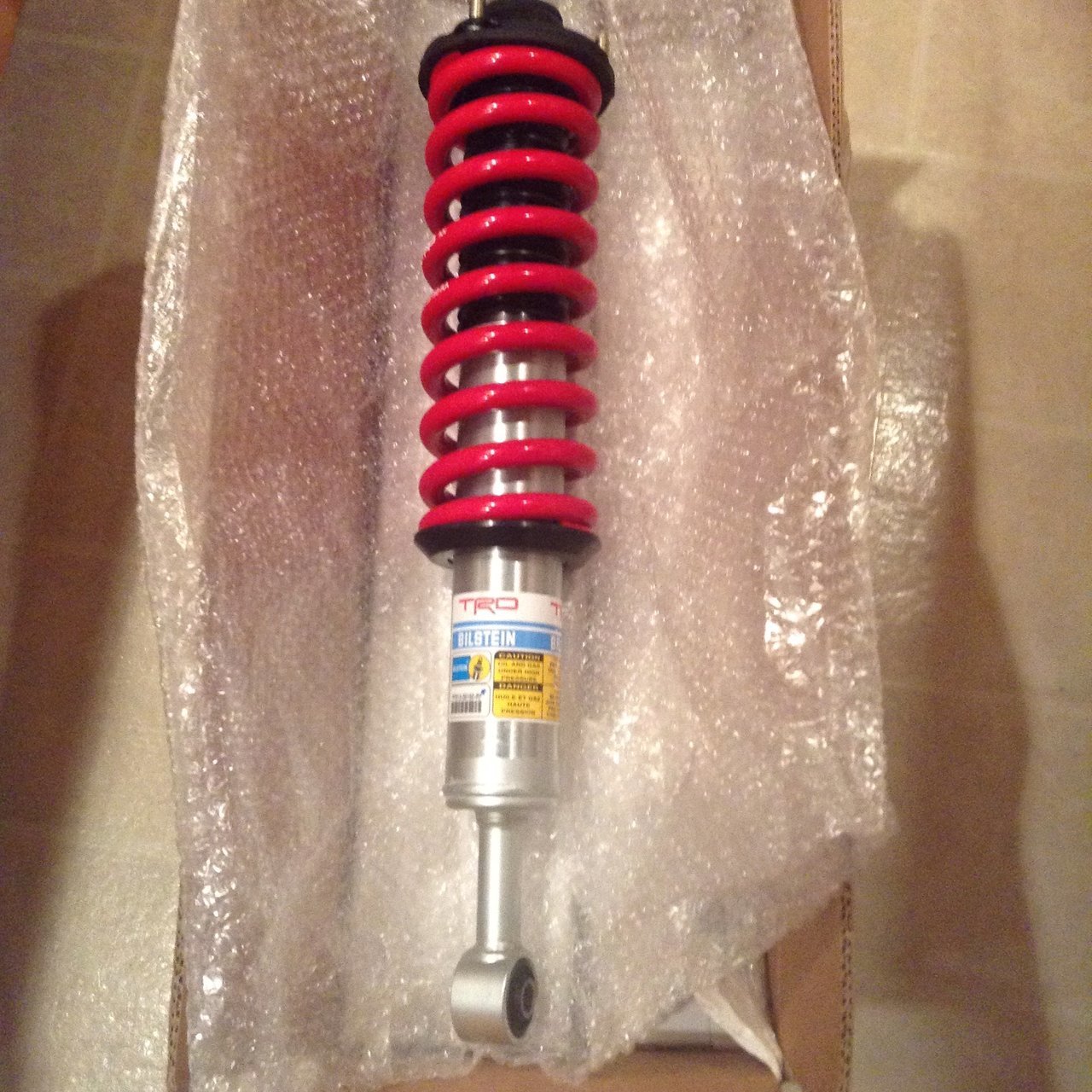

    I bit. PTR13-35150 for $633.76 shipped. Gotta be better than my procomp leveling kit PO put on. Keeping my fingers crossed.

    Got mine today. I have next week off, so I'm hoping to get them installed then and be able to provide hard numbers for the 4-banger crowd.
