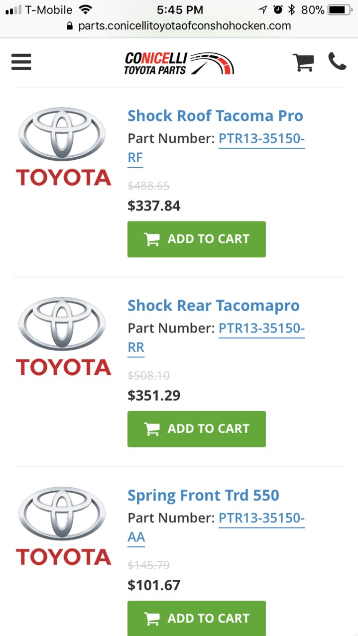

    Bill
    Norwalk, IA
    2019 Tacoma TRD Pro Voodoo Blue
    TRD Performance Air Intake
    Part guru that hooks me up on my purchases! Fellow Tacoma owner and on this forum.
    TACOMATuRD and valdomero[QUOTED] like this.
