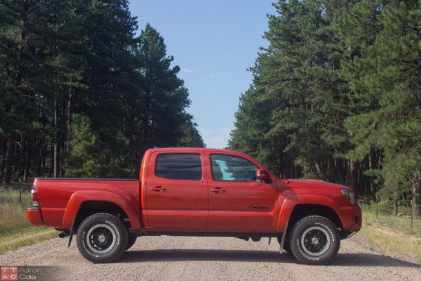

    I test drove this white 2013 Baja a few weeks back when I was looking for mine and it definitely had some bro lean. Might not be super noticeable in the picture, but it was definitely noticeably in-person and on the test drive.

    Thanks for the pic. Was the Pro setup the same way as the Baja as far as the rear end? I know the Baja had a different spring rate on the front. Also might be some sag in the rear of a 5 year old truck. Not trying to be a jerk, just thinking out loud. Either way, I don't believe there will be an issue with lifting the rear of the truck 1.5-2" in conjunction with the shocks in this kit. Mine should be here this week, but it will probably be a couple of weeks before I get to install.

    Oh yea I don't doubt the truck would have worn given it's age and about 70k miles on the odometer, but for what it's worth the other standard Off Roads I checked out didn't have the sag, even at over 100k miles. I don't own a Baja/Pro myself so I can't comment on the specifics about at how many miles the sag starts to become more apparent, but I'm anticipating it so I got the Wheelers 3 leaf AAL to put in along side with my kit.
