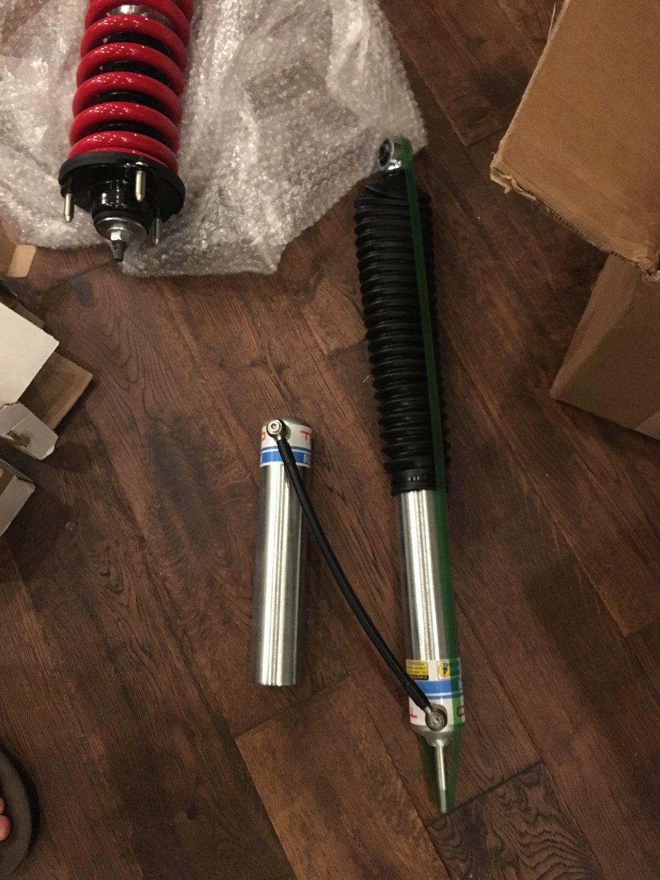

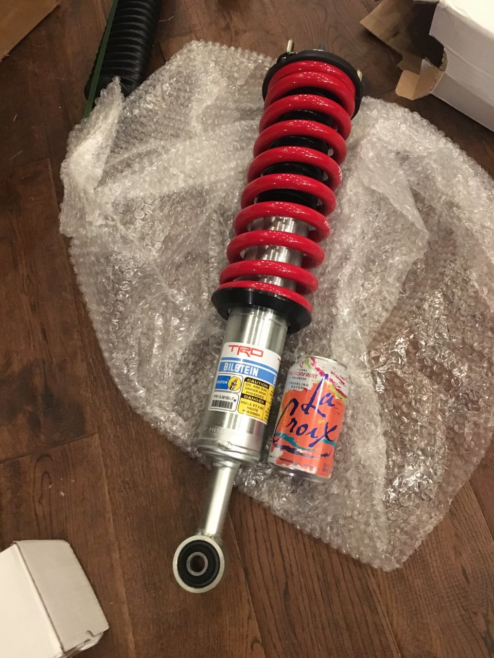

    Joined the club... will install them on the 27th
    These things are beefy! Soda can for scale.

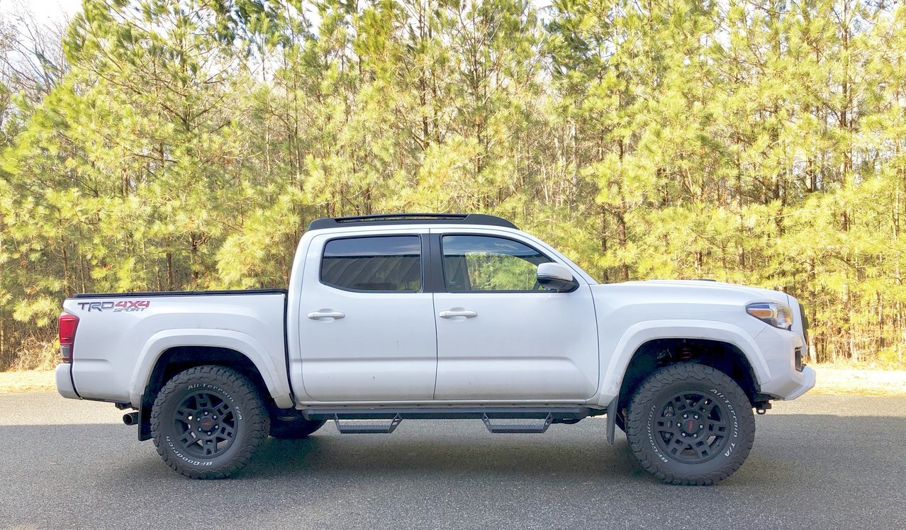

    2017 DCSB TRD SPORT
    "bro lean" and nose high are the same thing. Mine ended up 1 inch high in the front. I just got a 3 leaf add-a-leaf to fix it since I feel it looks ridiculous on my truck. Some of the others with the TRD offroad have the black fender flares so the lean/wheel gap difference is less noticeable and they can probably get away without adding any lift in the rear.
    If you mean "taco lean" (low on driver side) then yes, this lift corrected it for me. The passenger and driver wheel wells measure exactly the same height off the ground after the lift. They was pretty significant lean with the stock suspension.
