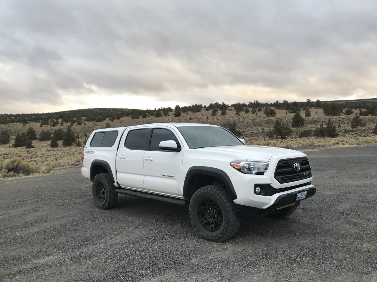

    Yep that's me just after purchase October 2015. It was a definitely at least 1-1.5" higher in the front and about 1/2" higher in the back when I had 16s. TRD Pro rears are lower. I have since: added approx 175lb Snugtop Rebel shell, and installed 2" rear blocks to lift the rear. It seems better aligned imo. Recently added 4-Runner TRD 17" wheels (add another 1" lift), 265/75/r17s. Today it sits a good 2-2.5" higher than a OEM Off Road on the dealers lot. Hope this helps.

    So would new leaves that provide 2" of lift be about right? I have the same wheels and also a cap with a full prinsu. I also usually have a bed full of gear.

    I'm not holding you to anything. It's just hard to get answers on this. 2" in the rear make yours level to some forward rake?

    2" blocks brought the rear noticeably higher than the front without the shell (too much so). With no shell I would have gone with 1"-1 1/2" blocks. With all my gear it sits level to maybe a touch higher in the rear with the 2" blocks.

    I assume you have the front set for taco lean?
