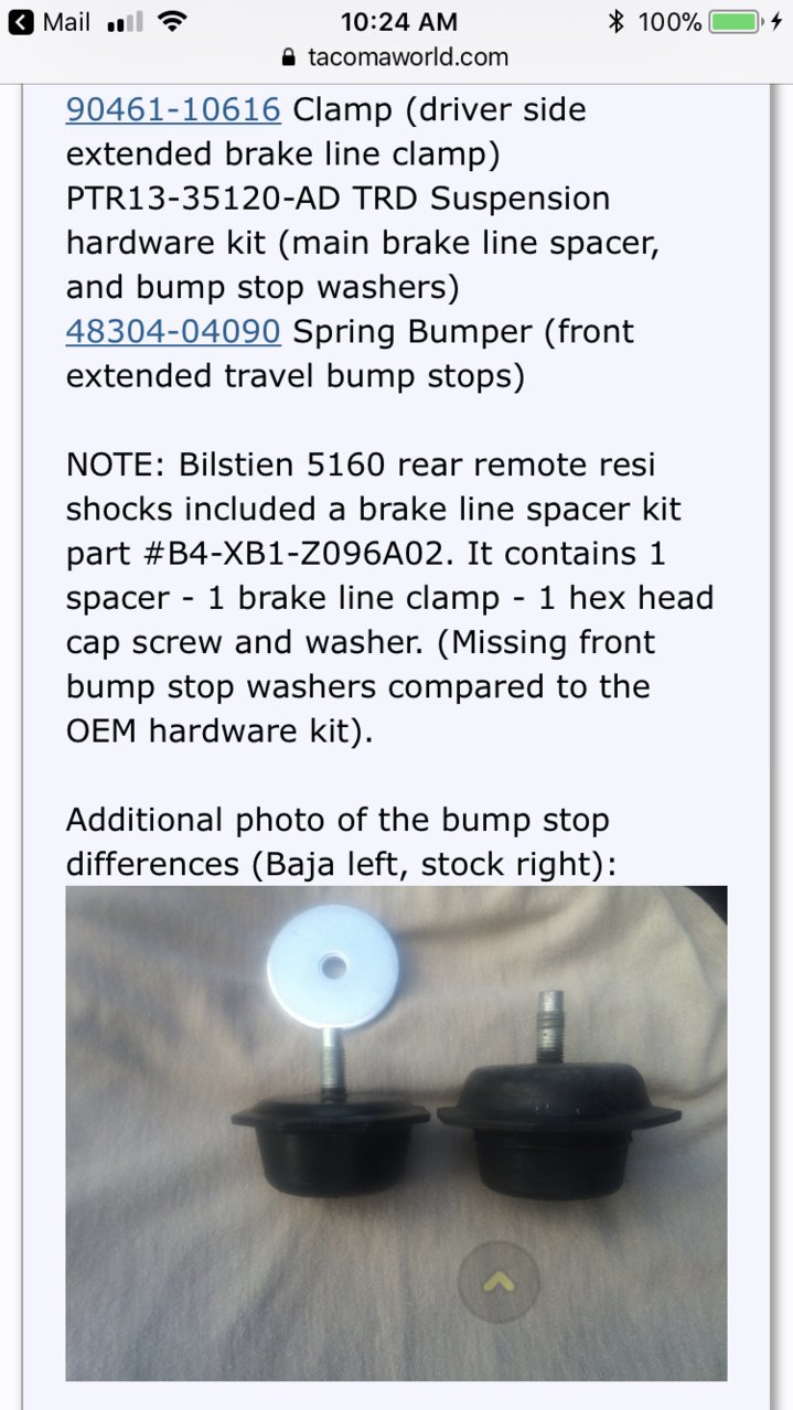

    I saw somewhere in the 2G forum that that the kit comes with new front bumpstops. Is that true?

    No it does not.

    I believe that's the Baja kit, not the pro kit.

    Correct,
    Here is the part number and size comparison for the Baja bumps if anyone wants them.
