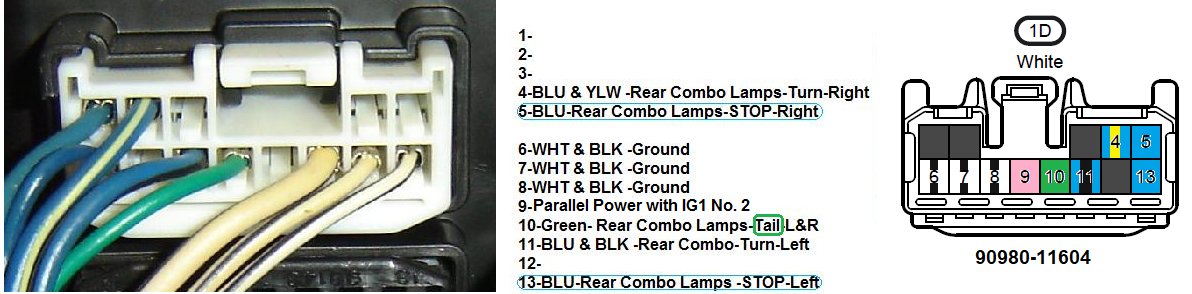

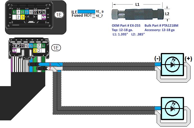

    @caribe makaira any idea which ones go to the blinkers for tapping for the turn signals in sport mirrors?
  7. Mar 22, 2023 at 4:19 PM
    caribe makaira
    caribe makaira Well-Known Member
    Feb 13, 2011
    #51121
    10,481
    Caribbean, Puerto Rico
    05 PreRunner TRD Offroad AutoTrans
    Hood Struts, My version Fogs always ON, Map & Overhead Light Mod,
    1D is above 1E.
    Same position different years.

    what is the difference between the 2 sets or is it 2 versions I may see? Do you only need to tap power and tap grounds elsewhere? These diagrams always confuse me at first.
  9. Mar 22, 2023 at 8:45 PM
    caribe makaira
    Feb 13, 2011
    #51121
    10,481
    Wire colors for different years. Ground can be at a door screw/bolt.

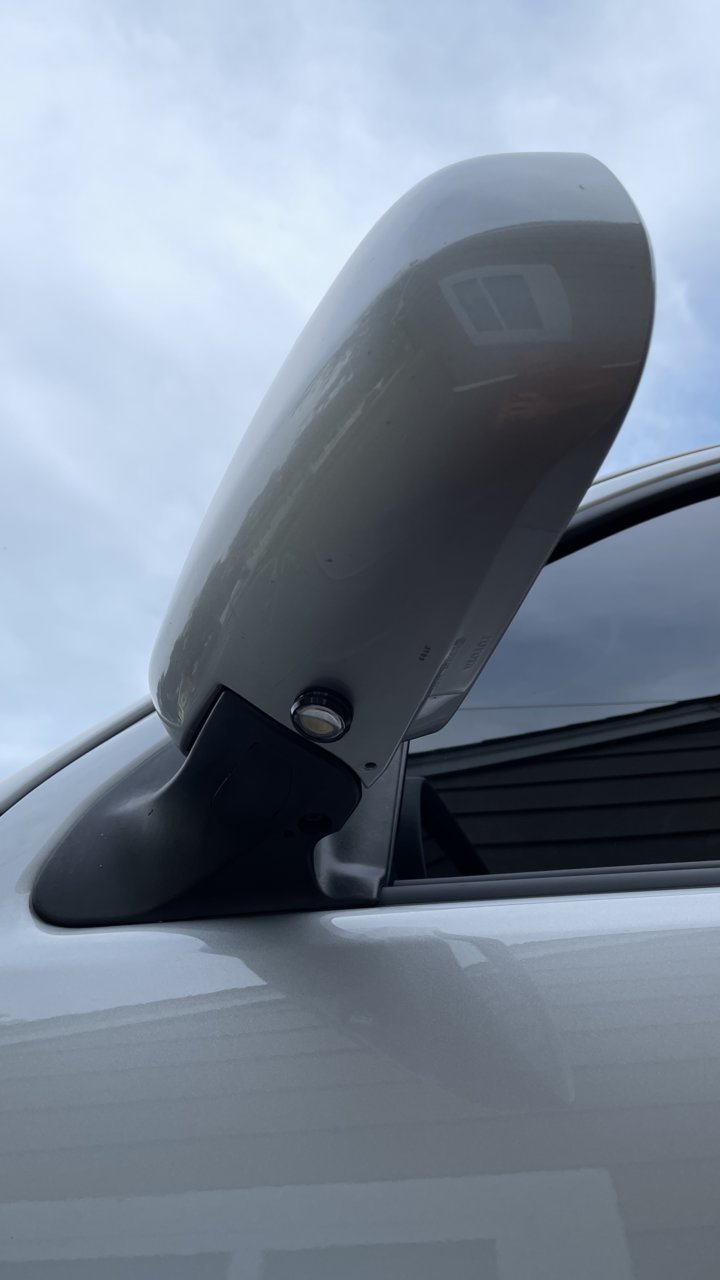

    I added my ownAE9972D7-1CB2-4F57-8985-763DB75621CA.jpg38A2AF09-FD3A-4389-9693-83CB2BEB9831.jpg
    HellsWells and Lohan808[OP] like this.

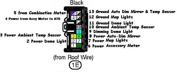

    Can you post or send me the layout image of 1D and 1E you posted before. Looks like it got removed (or I can’t see it)
  16. Apr 1, 2023 at 11:52 PM
    #16
    caribe makaira
    Feb 13, 2011
    #51121
    10,481
  17. Apr 1, 2023 at 11:57 PM
    #17
    nudavinci64
    nudavinci64 Robert @ Holy Horsepower
    Nov 14, 2013
    #116533
    9,873
    Robert
    San Mateo/Cayucos, CA
    13 S/C TRD OffRoad 4x4
    Boosted Money Pit....
    Excellent thanks!
