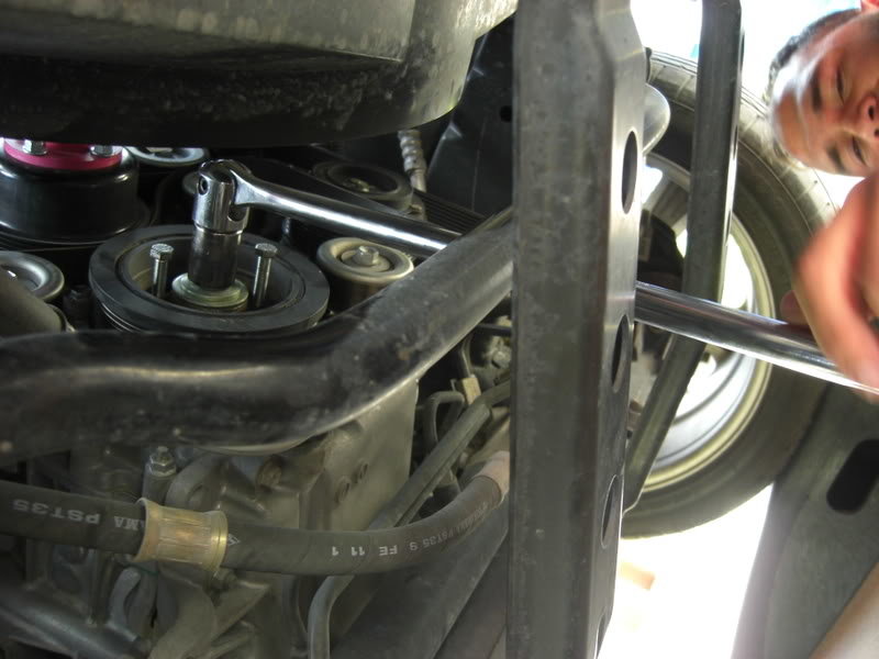

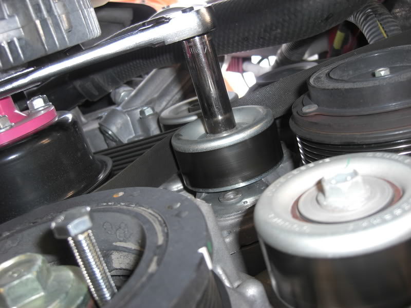

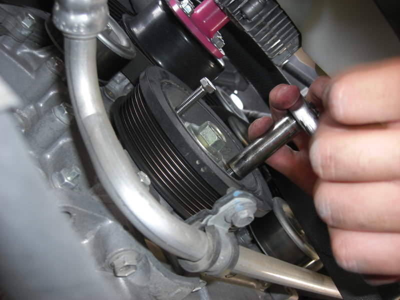

    Tools needed;
    Lift, ramps or floor jack & jack stands
    two 8mm x 1.25 bolt, 2"+ long
    3/8" drive ratchet + 14mm deep socket
    1/2" drive breaker bar +22mm socket
    1/2" drive Torque wrench capable of 200 lbs/ft.
    Wrenching buddy is recommended but not necessary
    First, front end need to be picked up as installation will be coming up from the bottom. Lift or ramps are recommended. If service jack is use, minimum of 2 jack stand are needed.
    The accessories belt has to come off. Use 14mm socket and rotate the tensioner pulley counterclockwise to relieve the tension. This is the pulley between water pump/ radiator fan and AC compressor. Belt should come right out. Pay close attention of the belt routing.
    Install two 8mm x 1.25 bolt into threaded holes on the pulley. They need to be around 2"+ long in order to work properly. Turn them all the way in, through the pulley, 'til it made contact with engine block. Then tighten them a little bit more until its snug, about 1/2 - 3/4 turn, this will serve as a pulley holder when removing the crank bolt.
    Use 22mm on 1/2" drive breaker bar, and put some muscle into it. Remember lefty loosey.
