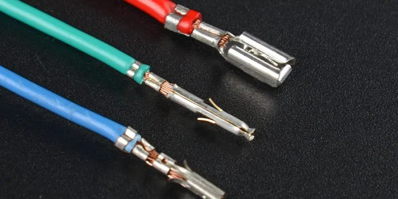

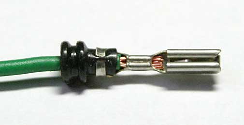

    The open barrel are designed for terminals without seals. Part crimps the wire, part crimps the insulation. Think of two “m” shapes. Sealed terminal crimpers do one “m” on the wire, and an “O” around the seal. The deutsch solid crimpers (closed barrel) put four dimples in the terminal, kind of an “X” shaped crimp. The reason closed barrel is nice is it eliminates under/over crimping (with a good tool) as well as any rolling of the terminal. Basically, if you can strip a wire to fairly exact length, and you have a good tool, you can crimp closed barrel. No real skill needed.
    Open barrel
    sealed
    closed barrel

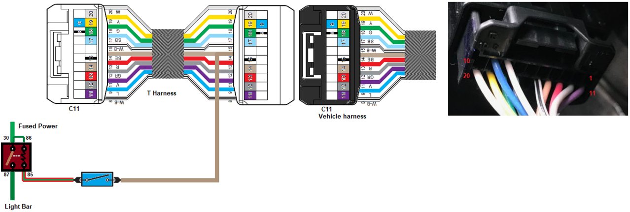

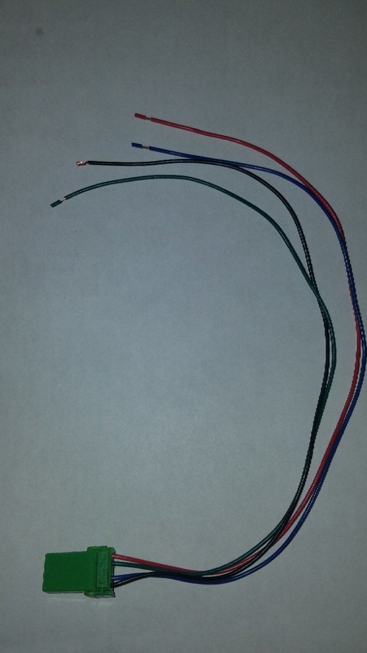

    Johnny!
    My end goal is to have my Auto High Beam button over on my Meso Shift Knob, and I'll be using a TR7 trigger switch module to latch the Auto High Beam switch.
    That leaves my Auto High Beam switch empty for something else. I have the connector plug for it, and would like to wire my 10" Rigid light bar to this switch, but I only want the switch to be hot when my High Beams are "on". So, High Beam "on" = Light Bar "on".
    Can I run a tap from the high beam hot wire - to the switch - to the relay - to my 10 Rigid light bar?

    I think ground switch it. Hot to one side of the relay coil, other side into the cab to your switch then to ground. Get the polarity right and the indicator led will work too. Easier than 2 wires, hot in, switched out. Same net effect on the relay in the engine bay.
    RyanDCLB[QUOTED] likes this.

    Nice, even cleaner, use the already grounded switched in cab high beam trigger! C11 is accessible or you need 1/2" diameter fingers? :)
    RyanDCLB likes this.

    Awesome. Thank you! So using this post, I've located C11. :thumbsup:
    Connector C11 - Taillights / Headlights
    @kmorgan3 I'm assuming I'll need an illumination harness to light up the switch?
    Edit, I'll need a new plug for the Auto Headlight switch. @kmorgan3 PM incoming...

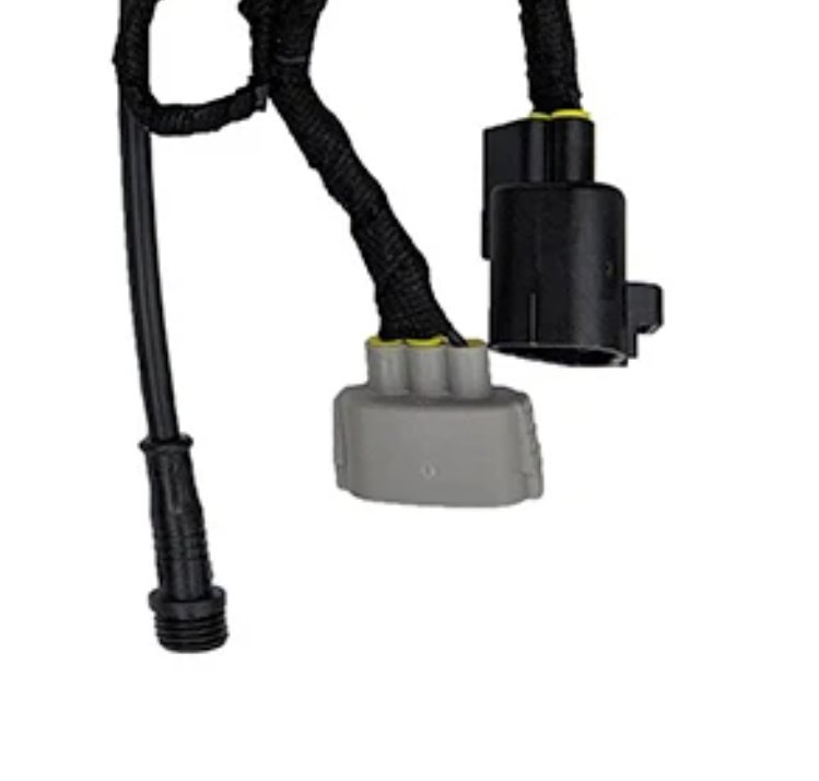

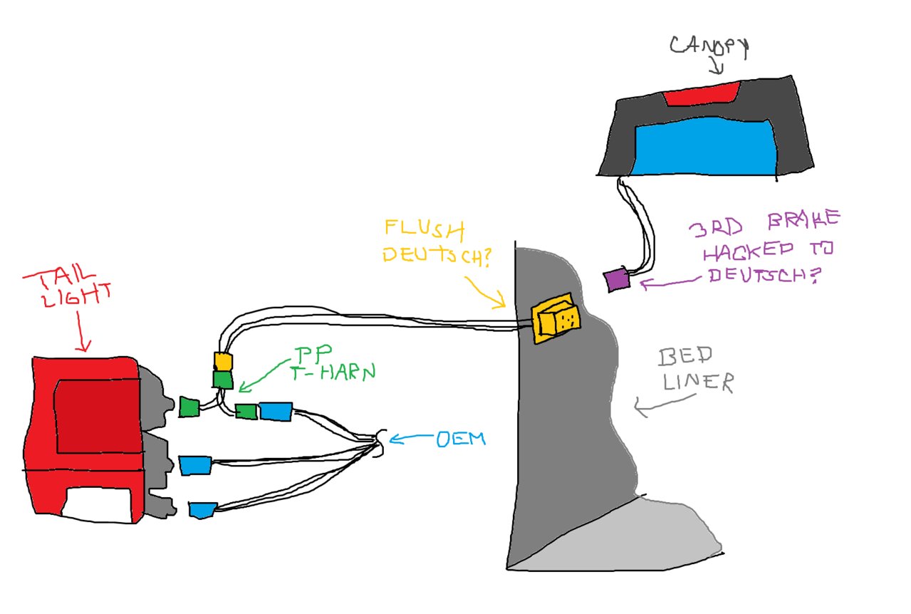

    this is for the third brake light on my cap. I’ve got the t harness, confirmed all works right. Just trying to figure out how to wire it.
    And I’m still debating what to do for a reverse light. The VLED plate mounted one is tempting me..

    Johnny
    2019 Black SR
    Sorry, late to my own hole... I see a few answers. The one Dave is suggesting that Meso uses is a good solution, but you’d be limited to a short length unless you want to solder. VLED sales those for their Teutonic bulbs, but they are only a foot long. How long do you need it? And how much amperage? I’ll dig out my Delphi GT150 stuff and see how big it is, but I’d bet it’s too big. You are probably looking at going down to a Sumitomo TS025 series? Even that might be too big. Let me dig through some stuff in the morning and see what I have and if any of it might work.
