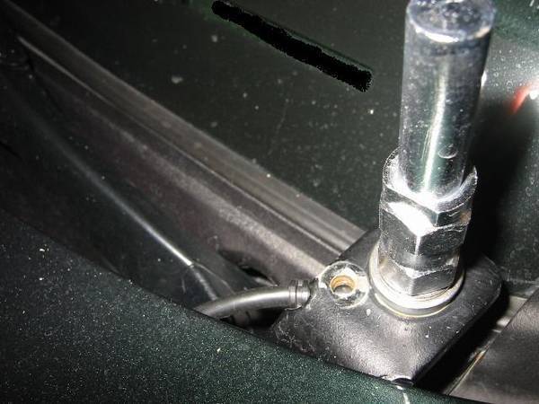

    That's the exact disconnect I used with my Relentless bracket and a 4' Wilson Flex antenna for the past couple years and it worked great. As mentioned, you'll also need a mount. There is not a lot of room for the coax under the bracket when the hood is closed so you can't go straight into the cable you've chosen. I went with a Firering coax and a stud-type mount which screws up from underneath, through the coax, then Relentless mount, and then into the bottom of the disconnect.
    Ignore the extra hole in the mount, I drilled/tapped that when I was using a different coax with an external ground.
    As to an SWR meter, I picked mine up from the nearest truck stop and it works great.

    I agree with the above about the relentless mount, it leaves very little space. Even with a right angle connector, I still had it pressing down on the windshield. I actually tried different studs, different connector setups, etc. and nothing would make it not put force on the windshield. Soon after I installed, I got a long crack in my windshield as well - I'm not sure it stemmed from the mount, but it definitely didn't help.
    I finally found the firering and put that on. I think its the only way you can use a relentless mount effectively, which is a shame because its a well made mount and they could have just made the bend a little more severe and fit everything better.
    Also, depending on where you're mounting the CB inside the cab, a right angle connector can be extremely helpful. If you're going for the hidden center console location, you'll definitely need it.
