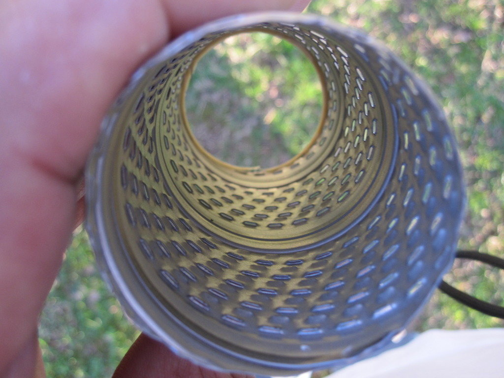

    I concur. I checked my shelf stock and had a Purolator Boss filter and inspected the louvers and they were 95% blocked. Not even opened. Dont even think of using these filters. Had one "Classic" filter and all were open albeit small openings. Also had one "Pure One" and they were all open and small but inside was full of particles. All junk. Will never buy Purolator again!

    Thank You! This is what it should look like:

    Man, what an *emotional* thread. Rightfully so, I suppose. We obviously all love our trucks and like to think we take the best care of them possible. I will, however, play devils advocate and state that I'm waiting for someone with some professional experience to chime in. Professional experience meaning someone who's had a hand in engineering and lubrication systems of automobiles. Sorry, even an opinionated pro wrench with years of experience is just that...opinionated. I want to see actual hard data, not just "I took it apart, this is what it looks like to me and you're an idiot if you don't see it the same way." I realize that the obvious flaw in producing such data is that it would be a multi million dollar study by the time man hours, materials and equipment are factored in; not likely to happen in this lifetime.
    I guess the thing thats the most puzzling to me is the disparity between the common belief that Toyota is reckless when it comes to the recommended service interval for the ATF change yet at the same time they are super on point with their oil filter technology. I mean, christ, can someone please explain to me the consistent logic when comparing those two? I use FRAM; do I think it's the best? No. Do I know what the best is and why? No. Do you? I'm not convinced so by a number of people cutting open used oil filters that they put 6500 miles on and calling the filter garbage. Yes, I realize that most of those folks didn't put that kind of mileage on them. It's just takes one to make me question the entire basis of logic. If you're so concerned about the wellbeing of your truck, change the fucking oil at 5000 miles(or less) before bashing the manufacturers for making a "garbage" product. You can call them a shit company and they can call you a shit owner. In the old days cars weren't supposed to go more than 3000 miles without changing the oil. Yes, the technology in oil has changed tenfold in the last 30 years, but still, even modern lubricants break down.
    I just still can't get over the belief that OEM filters are heads above the rest based on a bunch of people cutting open new and used filters. On the one hand "Toyota doesn't care if your transmission fails" because of a variety of stated claims that I won't go into but at the same time their oil filters were secretly designed and built by NASA...and sold for a couple bucks when you buy 10. Look at how many recalls they have had because of common sense shit that shouldnt have been overlooked(frame rust, just to name one). They have ZERO issues with quality control and engineering oversights, right? The logic just doesn't jive to me.
    Don't get me started on the Royal Purple diehards. I'll just say this: look at what you spend on oil changes on even the low end life expectancy of the motor. Now crunch the numbers for doing the same but using wally world or reconditioned oil. That dollar figure is about enough to build a 500+HP NA motor AND rent a truck to drive while you build it. I just don't get it. Lose sleep at night over the thought of your truck locking up because you didn't use RP oil? Fine. RP loves you and they're so happy that some people are still investing in a reputation that was built in an era when a fuel injected vehicle was considered newfangled.

    I did some searching and it looks like the only "tests" that claim that the OEM filters are the best are coming from a single post...one that is on a 4runner forum and has been reposted here. There are lots of online articles and other forum threads on the topic, but none of them claim the OEM filter is best...just that it's well made with good flow. A test done by Amsoil (biased I'm sure, but probably not complete rubbish either) shows pretty bad efficiency. It sure has a lot of filter media, and most people are claiming it's a "flow over effciency" design. Lots of people are saying it's made by Denso too. I don't think the OEM filter is bad, but I think there is some validity to the argument that cutting the filters open to see inside doesn't show how well they filter, just how well they are constructed and how much media they have in them. Maybe efficiency doesn't matter because really tiny particles don't hurt your engine? I don't know. I do know that I would never use any of the tiny filters that are listed for the 1GRFE at parts stores though.

    I think cutting it apart just shows the construction of the filter with design and parts used. In the end, use whatever you like, its your truck.
