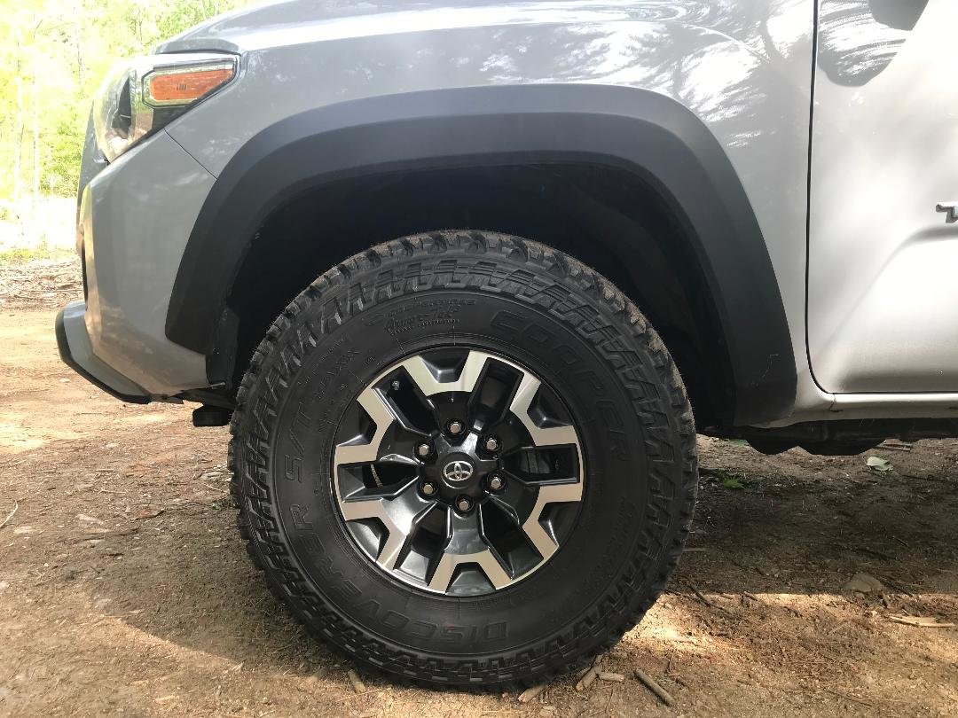

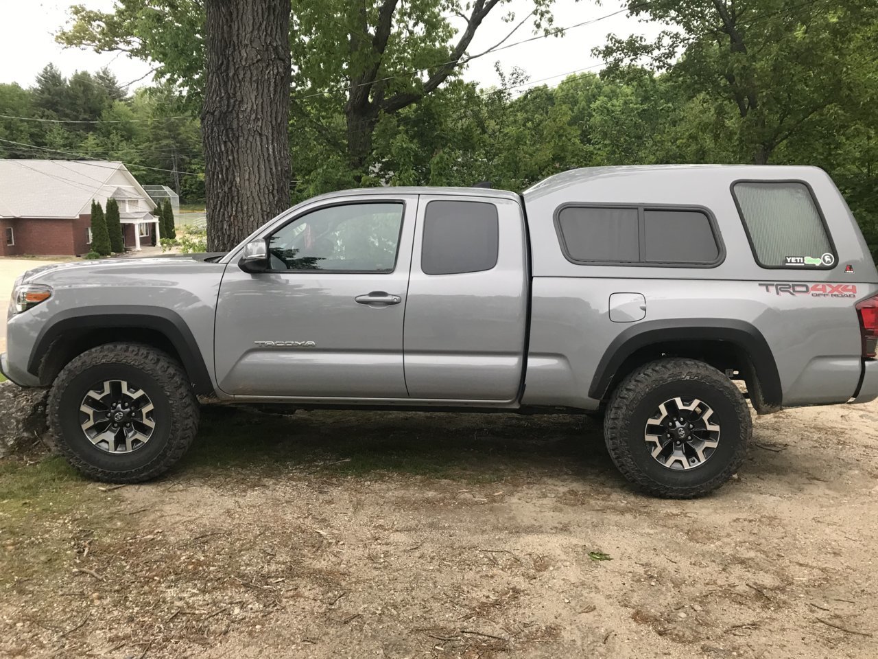

    ST MAXX 255/85-16
    no one will ever be able convince me that these tires shouldn't have come stock on these trucks...only had them put on this morning but put a few miles on them today and took them up one of the more sketchy trails I know of in the area, a long rocky rutted trail with a few sketchy spots, and I definitely made the right choice these things are awesome!!!
    EDIT: zero rubbing, no gear hunting on the highway, barely notice the acceleration/deceleration difference ( I also drive like a grandpa so there's that) oh and just for shits and grins I pulled my sway bar and am liking that to

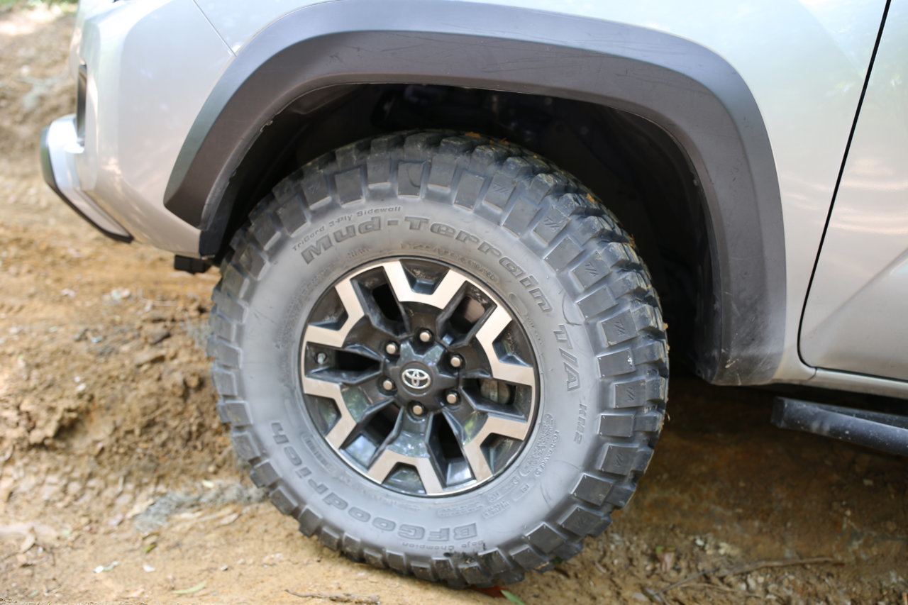

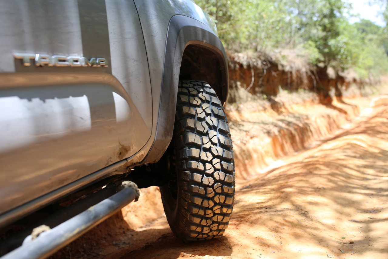

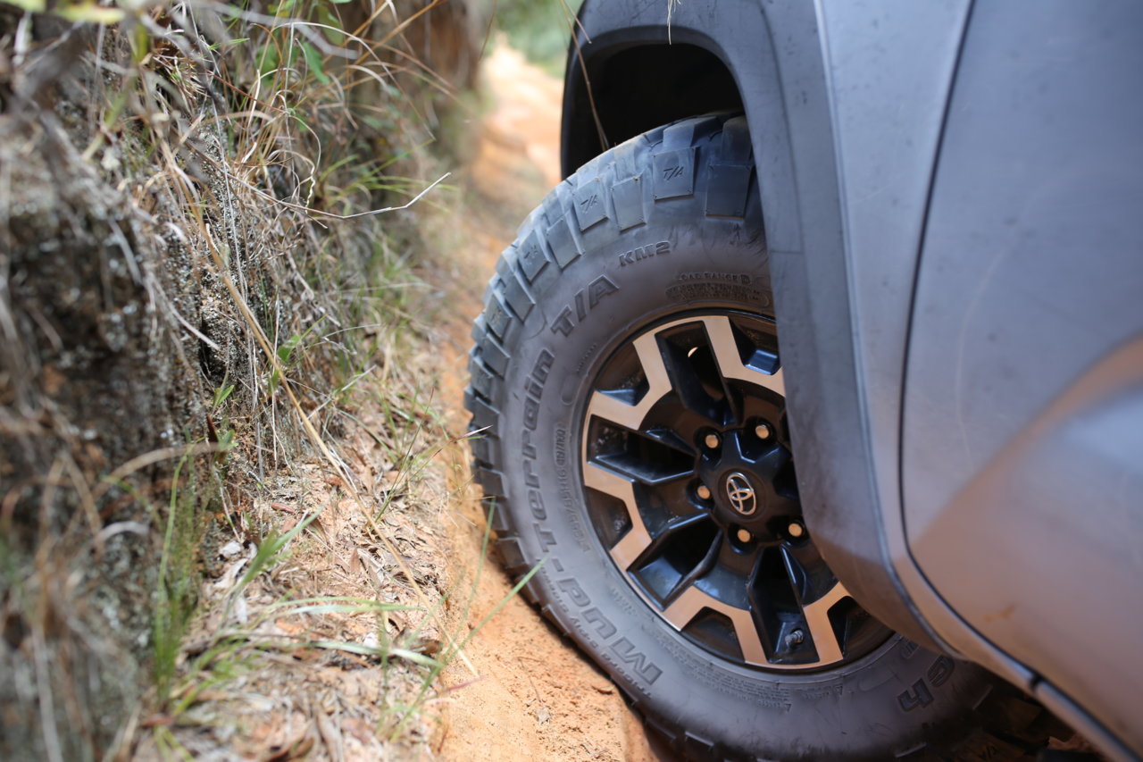

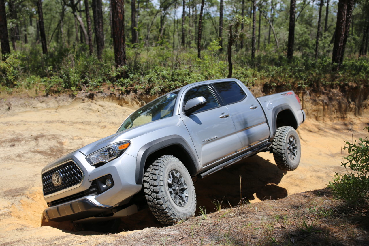

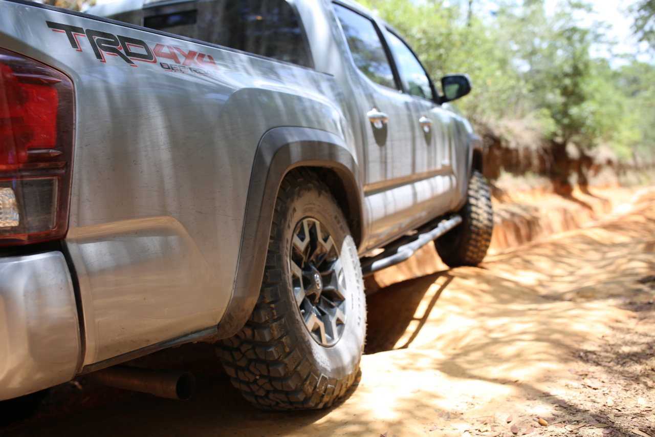

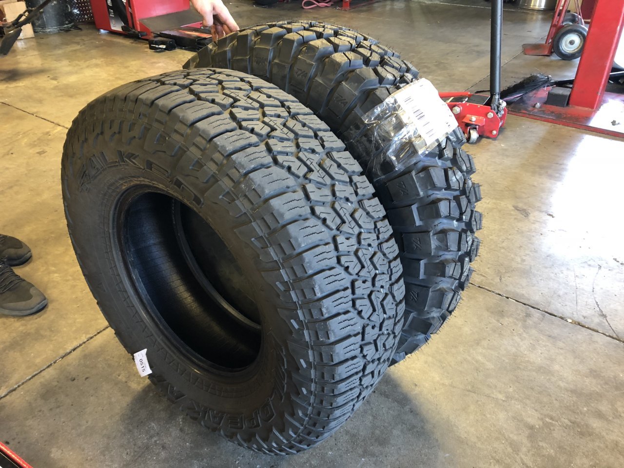

    Here’s my 255/85/16 journey in a big pic dump. Spoiler: no rub at the front or rear of wheel wells. Stock TRD OR suspension and wheels.
    Delivered:
    265/75/16 wildpeak vs 255/85/16 km2

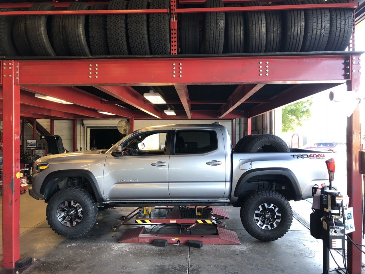

    Discount tire had no trouble balancing them AB6F29D1-9245-4F1D-B42B-DEF78208875A.jpg
    Clearance at mild turn
    7606635E-EECE-4C37-8E1B-991CCC95573D.jpg 038B7D3D-4A73-41DF-91A3-60C1071549CC.jpg

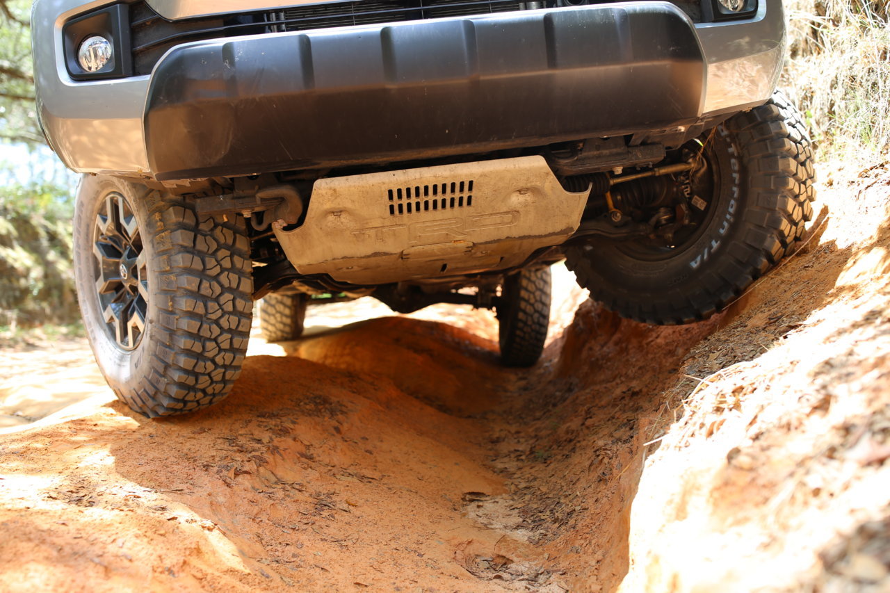

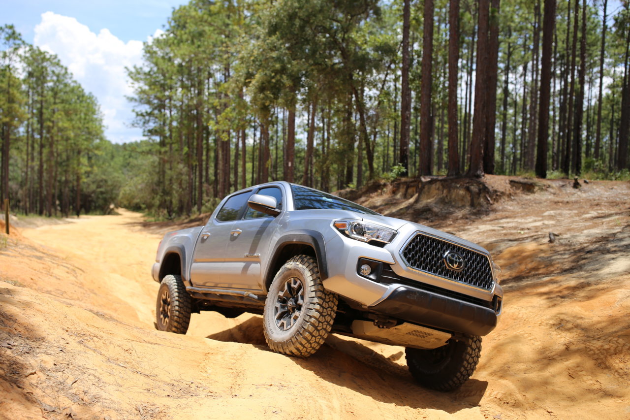

    Testing offroad
    56FB1846-ACC2-489E-9FFB-7B043568E5A6.jpg 74BF1FD2-0035-4FD1-859D-DB6AD2A26A03.jpg A73EEBBC-CD6D-4629-8EF1-FF4ED4242942.jpg E7FA314D-E8F2-4126-B90B-E13DC6BDB421.jpg A7739B71-5D66-434D-8BCE-BEBF5B2B3204.jpg 8546E4B7-C4E3-49A4-9745-CC38E24687F4.jpg FC6F3373-FB9D-49C4-BA8F-69686AC1958C.jpg
    The ONLY place the tires rub is actually inside the top of the fender liner (lol). You only achieve that by hitting hidden whoops going a tad quicker than the suspension can react. No rubbing in front or rear of wheel well. Not even in reverse and turning for me.

    They look great!
    Did you consider the km3's?
    ...the 3's look a little less aggressive and better rain.
    Did you buy them from discount tire & what did the cost?
    ...I've been wanting to do this, your pix are inspiring, as long as I can sell the wranglers for something!

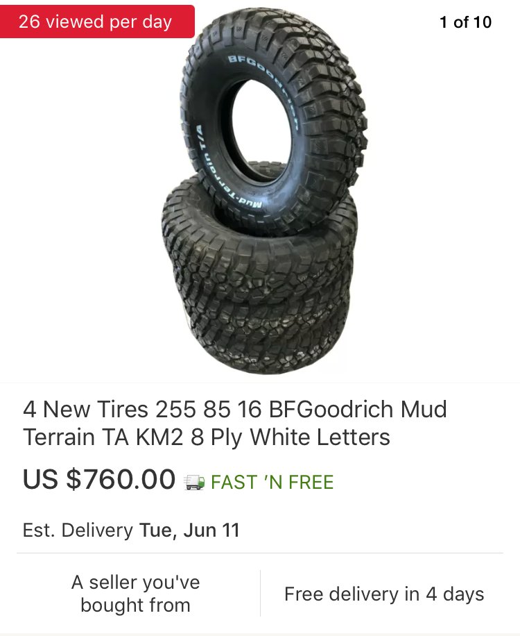

    I didn’t consider them because I got the KM2s for 175 a piece OTD on eBay. It was the cheapest way to get into this size. I did some reading and it looks like they improved a whole lot on the KM3s, but next set of tires will probably be more along the lines of an AT tire like the ST Maxx.
    I think I got $270-280 for my used Wranglers.

    eBay and occasionally Amazon usually has good deals, that deal may still be there.
    I just take the tires to discount tire, I think it was something like 20 bucks per tire mount and balance.
    They sincerely thought it wasn’t gonna fit so they mounted one tire first and did a lock to lock test. They heard the power steering hit the end point and thought it was the tire hitting the frame lol. Overall great experience, in and out under an hour, they fix nails for free if repairable, and offer an awesome road hazard warranty.

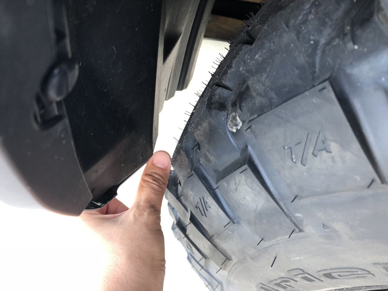

    Here’s where the minor scrub happens if you bottom the front suspension. This is looking forward into the front wheel well, just grazes the ridge.

    Looks like they’ve gone up a little in price. That same seller also sells them individually.
