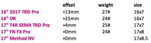

    just found it in this thread (assuming it's accurate)...
    https://www.tacomaworld.com/threads/fj-steel-tacoma-spare-comparison-question.510355/
    in my note's i've got the following:
    so that means if the 16" Steel Spare is +30mm offset then the tires will be 5mm (<1/4") closer to the inside of the truck than the stock OR tires
    so <1/4", hopefully we'l be fine?
    Can't believe I didn't think of that before getting the 255/85/16 spare.....have to update my little table now....

    Should be ok. Stocke tires are 5mm wider on each side already, although not as tall. I will look later and see if I can eyeball it.

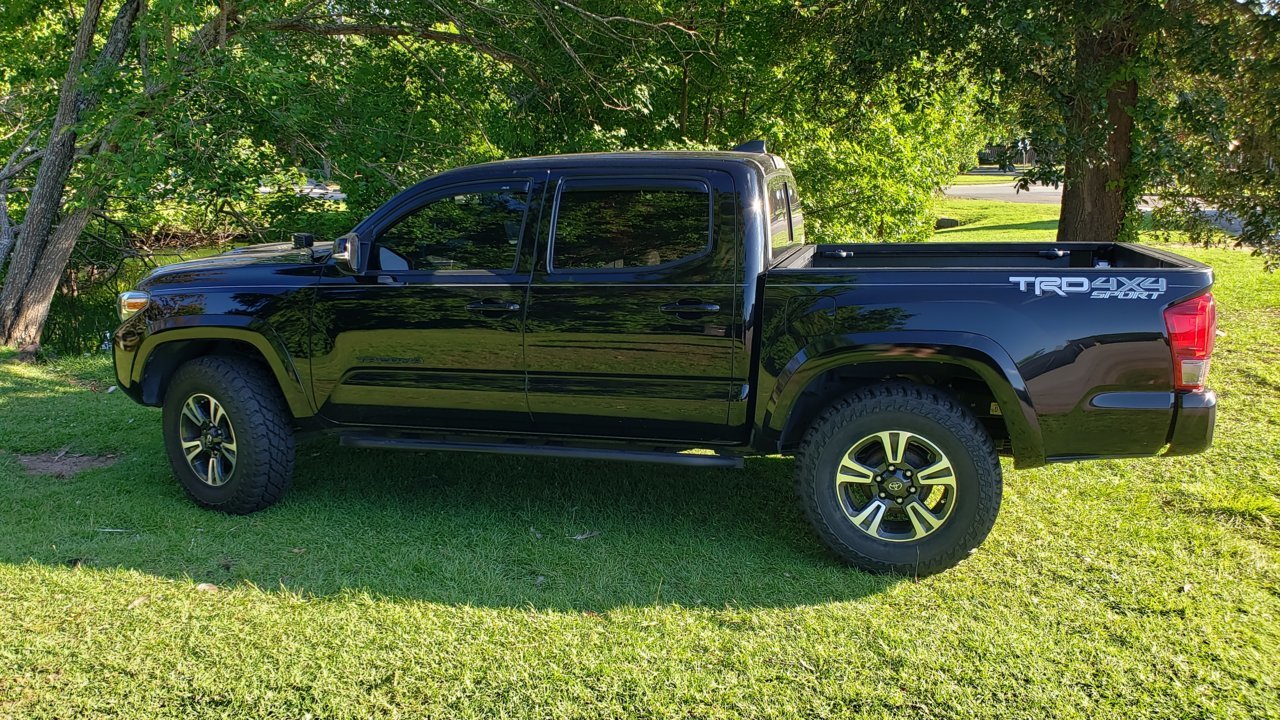

    Sport instead of OR but... Pulled the trigger last week. Thanks to everyone that shared great info on this thread! Haven't really flexed the suspension fully yet but no rubbing so far with SOS sliders and front/mid skids on stock suspension. Looks so much better than the 265/7020190628_181853.jpg
