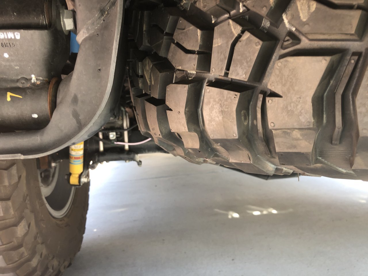

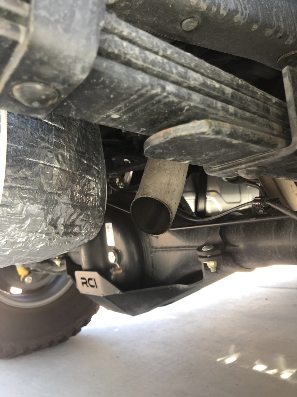

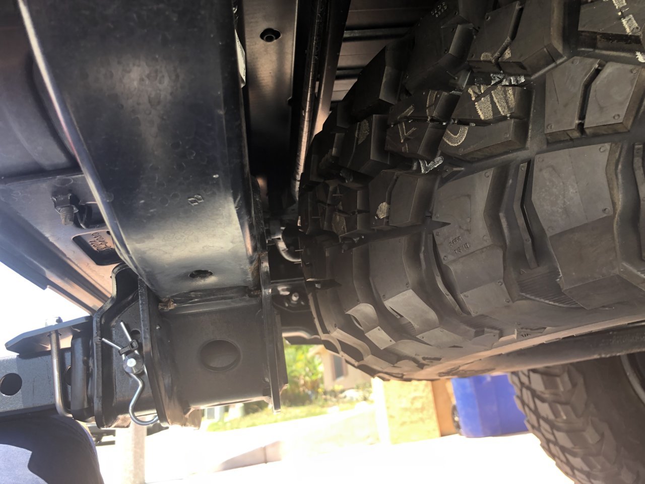

    Chopped exhaust. Made a heat shield for the spare. I don’t think its necessary I touched the shield after extended driving and it was warm at best. May still be helpful against rubber deterioration in the long term
    Relocated the tire lift mechanism here’s the clearance to the hitch
    Clearance to pumpkin
    Clearance on right side
    Clearance on left side
