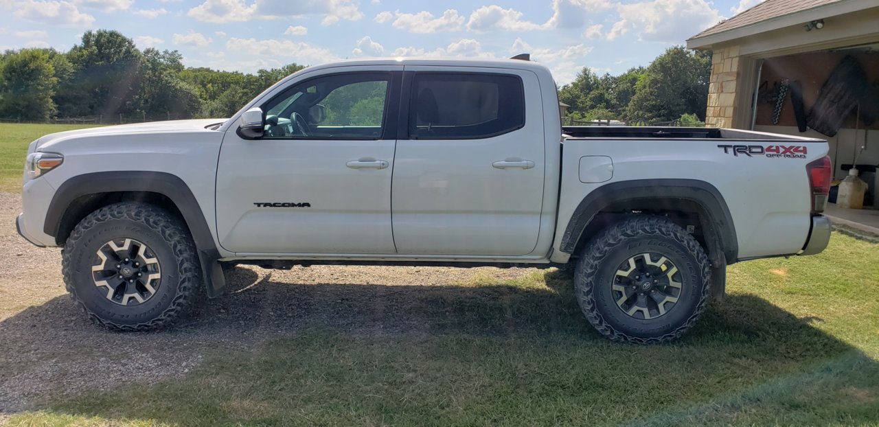

    Going to discount in a few hours to get my KM3s. Should I pull the mud flaps just in case?

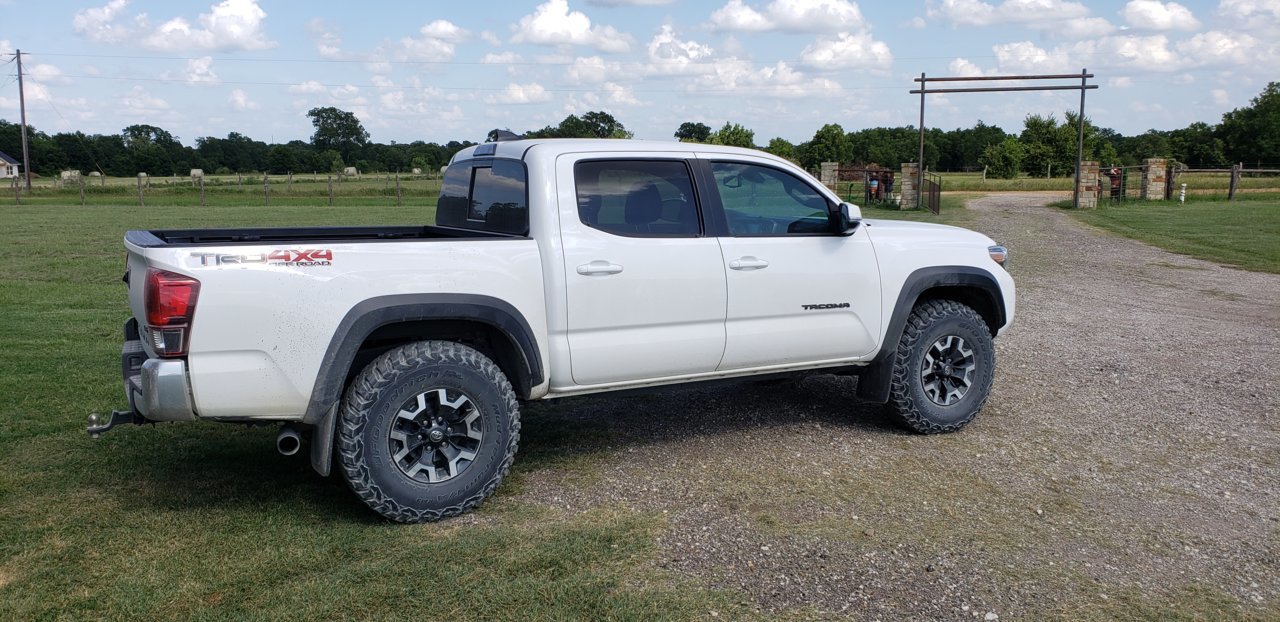

    Bryan, Tx
    '18 White DCSB OR 4wd auto
    Ignore the shitty lawn, I've been road tripping for the last two weeks. It was knee high when I got home yesterday, lol.
    KM3s, bone stock truck.

    At least you didn't have to bail the yard like your neighbor! Did I miss it? What was the tire dimensions.

    255/85r16

    KM3s look good!
