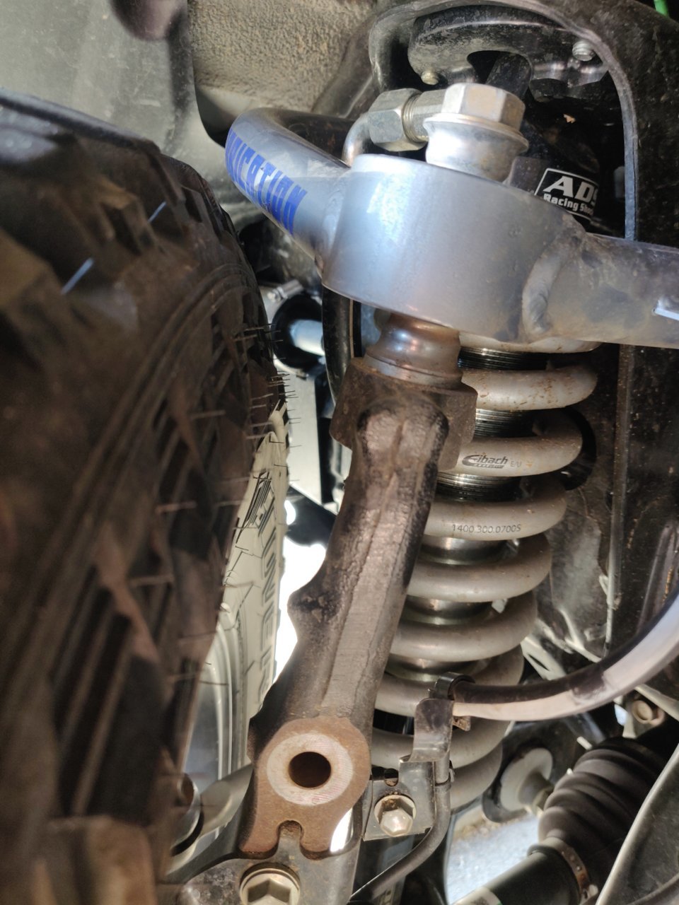

    I'm currently running Total Chaos UCAs with stock OR wheels and 255/85r16 ST Maxx's. I have not had any clearance issues.

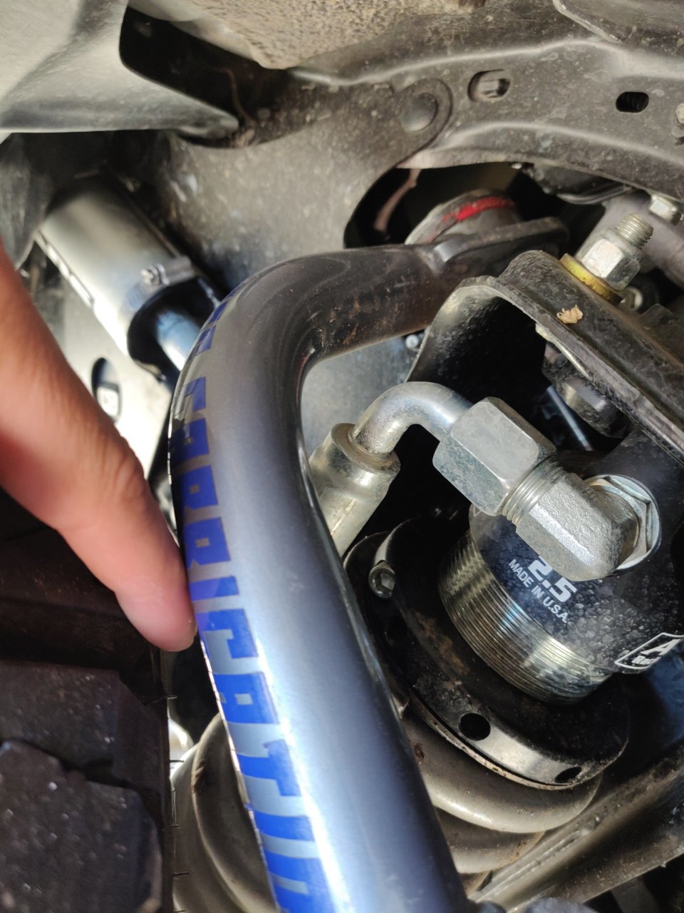

    Here are the photos. I had someone hold the steering wheel at full lock to take these. Without manually holding it, the wheels settle back to center a fair amount, so keep that in mind.
    Edit: I didn't grab photos of it turned the other way because there is a lot more clearance on the back of the UCA. This is the driver side, but both driver and passenger were similar.

    Thank you! Clearance looks good.

    Please bear in mind that JBA uppers are not designed the same as the other ucas on the market and actually stick out noticeably farther than all of them, so the TC data point isnt useful if youre still considering JBAs (which you should, because theyre awesome, greasable, and easy to replace the ball joint on later if you ever need to)

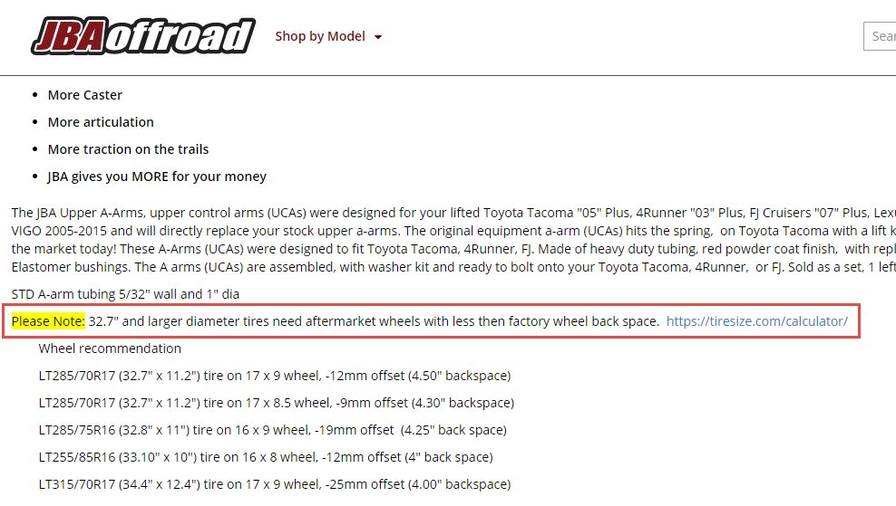

    They are indeed cheaper, but according to their product page ("Please Note: 32.7" and larger diameter tires need aftermarket wheels with less then factory wheel back space."), and talking to support, in order to run them I'd have to spend over $100 on new wheels or spacers. I've got a performance shop a mile from my house that can handle adjustables.
    Thanks man.
