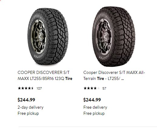

    I've pretty much landed on getting the Coopers, but which one? I'm looking online and they have two. One appears All Terrain , the other is not.
    Beretta4x4 likes this.
  20. Aug 4, 2019 at 3:52 PM
    #2160
    Beretta4x4
    Beretta4x4 What makes the green grass grow? TTC#0114
    Jan 20, 2016
    #175568
    30,285
    Josh
    Temple, TX
    6-speed death mobile
    They look completely identical, price is identical, size/load/speed source are identical. Puck the one that is more honest, better customer service rep or ships faster
