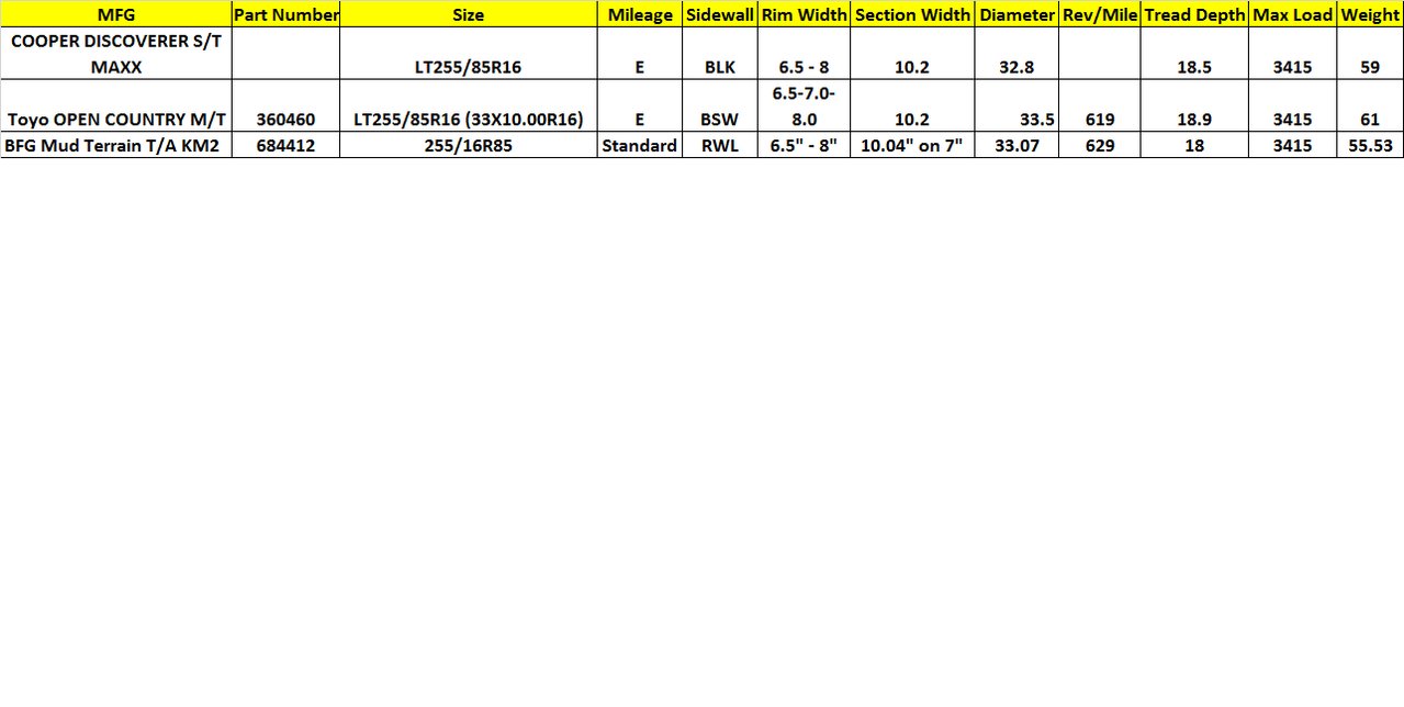

    Pulling the trigger on tires in the next week or so. Researching 255/85/16 options; I really like the Toyo M/T but afraid that the diameter of that tire will rub (33.5" vs 33"). Most likely going with the ST Maxx. If anyone has tried the Toyo M/T please chime in.

    Can you point me in the direction of the website in which you can list different manufacturers tires and their specs on one page like the picture above? I've been juggling webpages trying to compare and could use a resource like that.

    I just went to each mfg website and compiled the data into a spreadsheet.
