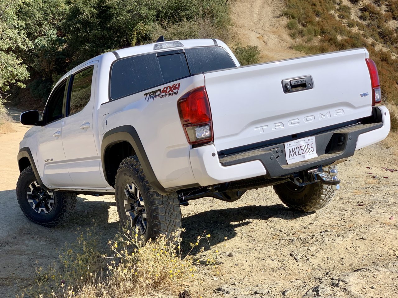

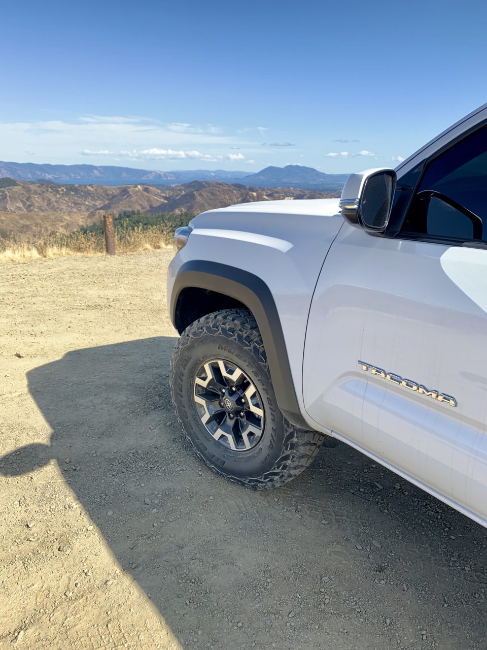

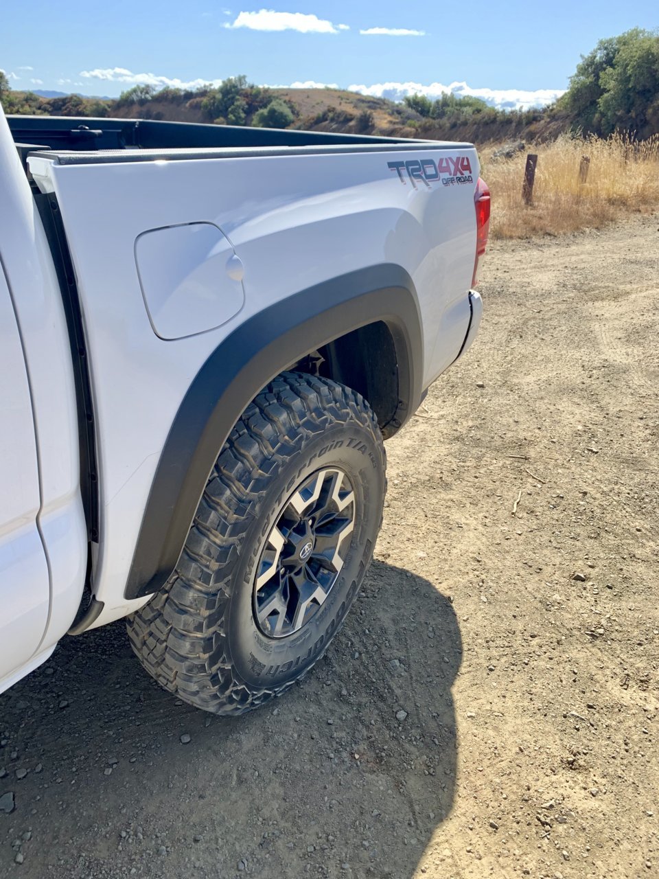

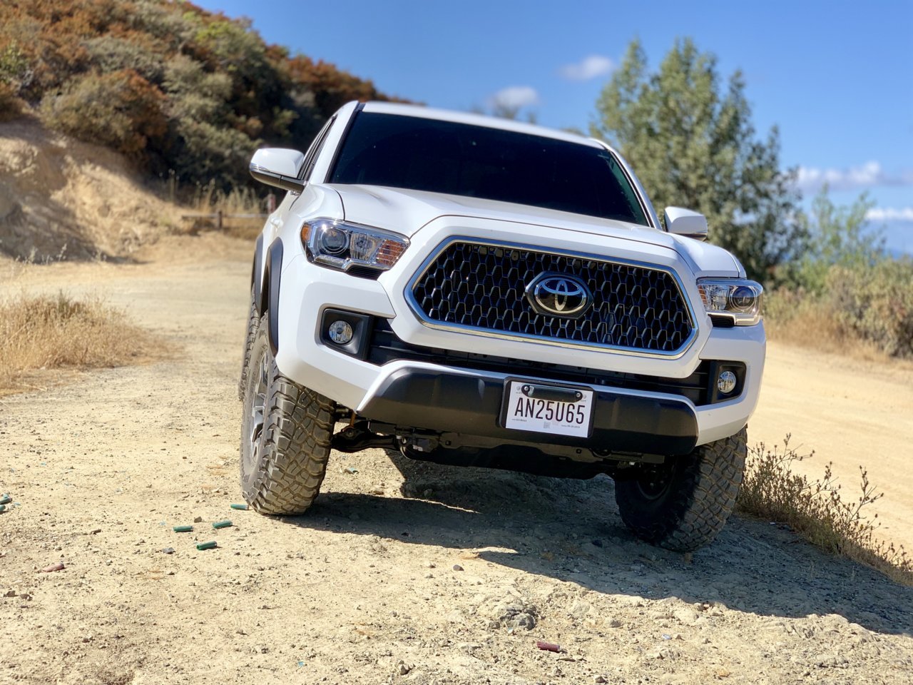

    Here’s a couple more of the km3’s from some fire roads today. Coming from a 36” Toyo MT on my last truck these definitely have some different driving characteristics.
    I left them at 35 psi because it was a short trip but they were only slightly firmer than the stock Goodyear’s. On the highway with strong winds the truck likes to move around more than stock. On rutted fire roads they do like to grab the ruts but overall I’m happy with them and I think those are characteristics of a skinny tire in general not just these.
    My only disappointment with them is how narrow the contact patch looks compared to some of the other tires in the same size. I think in reality it’s more of a looks thing than how well they will function though. That’s my .02.
    C500ADB8-35A2-4C16-B343-A779DF2F6EB1.jpg 03FA92CF-D275-48E9-BF74-1FE1100178A3.jpg 1990EF8E-4AB9-40B6-BB93-630E2E4706A9.jpg EBAB27E4-2A8B-42B9-955B-002E1B63E319.jpg 88D7B198-2DC8-4EF4-8F7D-6BF22AD9AD9E.jpg

    I've definitely noticed the wind movement

    Hey, hey! You're in my neck of the woods in these photos. Gorgeous view of Konocti!

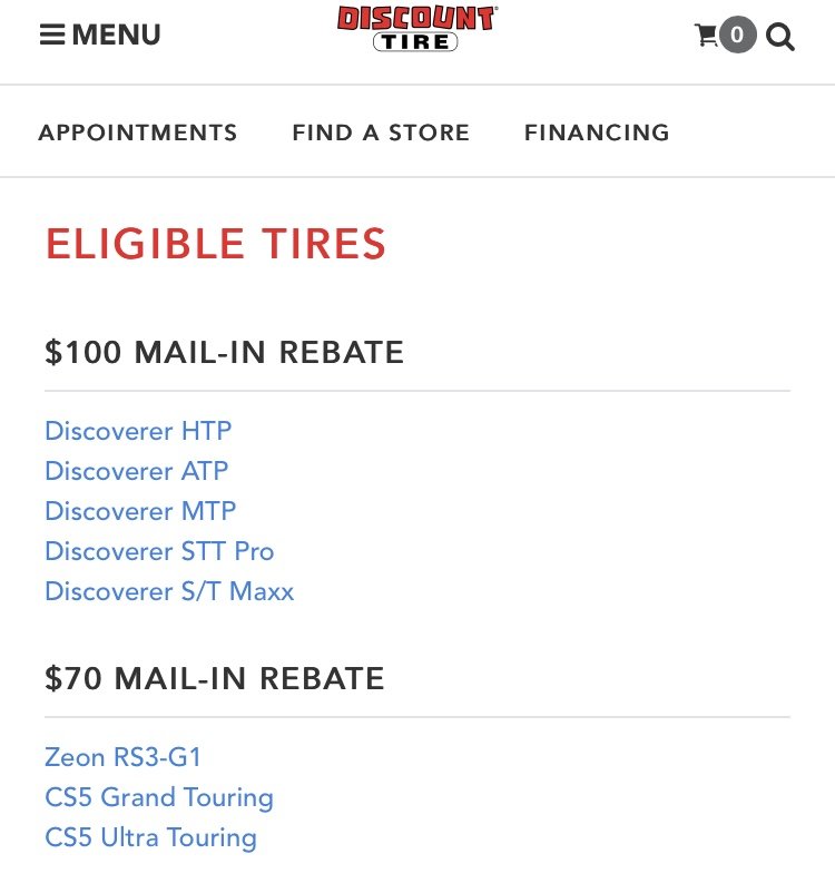

    9/15-9/28 get $100 off them 255/85 ST MAXXs

    I HATE mail in rebate. I refuse to buy anything with them.

    Why? It’s been painless for me the last couple times. I fill it out online, pop in the invoice number, and get the rebate in the mail in less than a month.

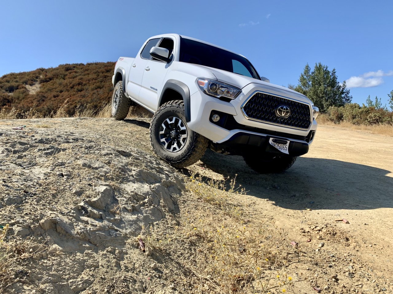

    I mean they sound like an MT. There’s no getting around the sound even with a skinny tire. They make a little less noise then the tires on my last truck but you still know they’re there. I did 5 hours of freeway driving at 75-80mph and I didn’t get annoyed. You just can’t expect them to be the stock tires.
    Here’s the Toyo MT’s I’m comparing them to. These were the opposite of tall and skinny and measured out to 36x13 on an 18” rim. 79442FE7-1233-4F74-AAFC-FA7A6FB40789.jpg
