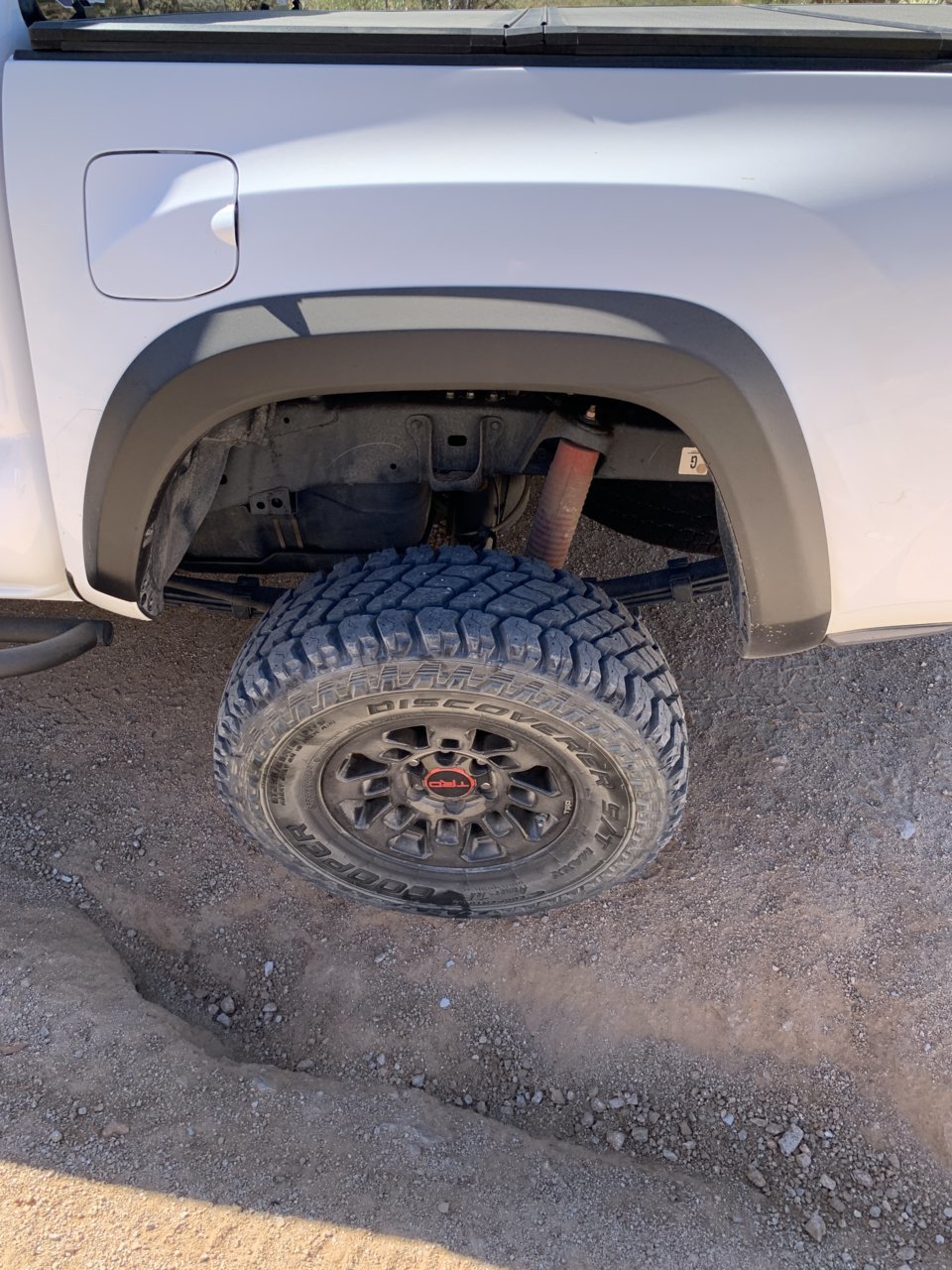

    Both of those sizes will not rub on the stock wheels and suspension. Some have had rubbing on mudflaps but I didn’t have any when I had them and 265/75/16s. Haven’t tried with the 255/85s.
    For reference, here’s clearance on stock suspension and 255/85/16 ST Maxx.

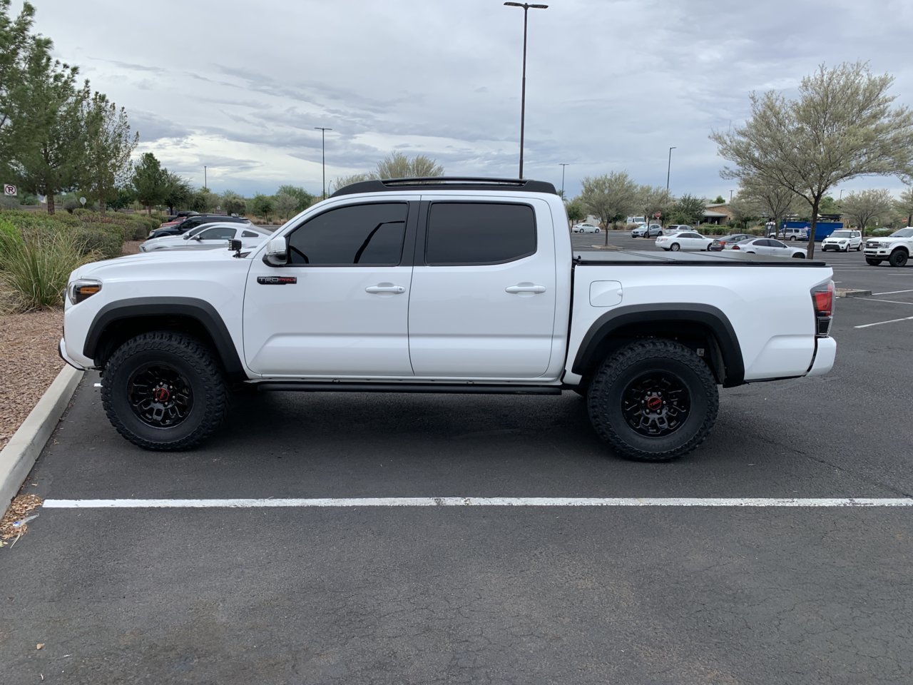

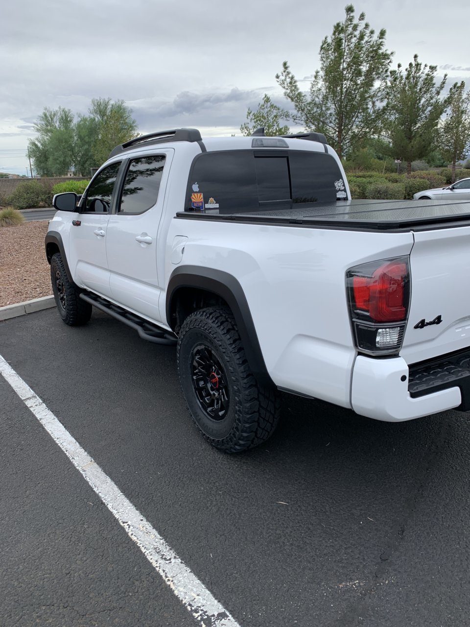

    So a few weeks ago I got a screw in the outside edge of my tire. I was at 5/32nd and just didn't want to spend $1000 on tires so I plugged it myself and got a couple more weeks out of it till I said whatever and bought tires. Decided to go with the tall skinny and after a few days I've got to say I'm happy as happy can be. Gonna take it out this weekend and find some rocks to see how they handle themselves....
    So with the coopers what are ya'll finding to be the best tire pressure to run them at?

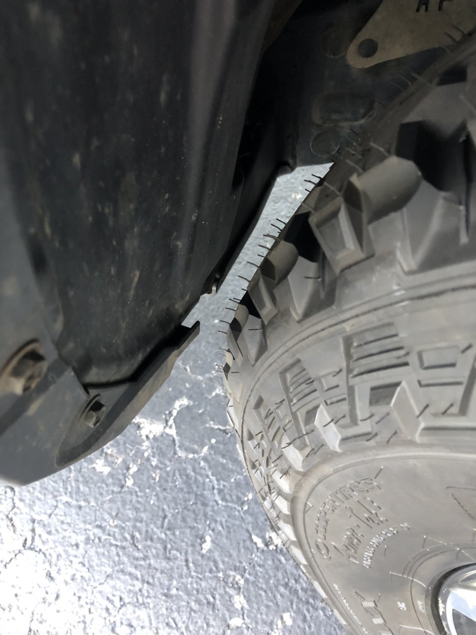

    It’s a little hard to see. Sun was going down by the time I got my truck back. I went with km3, 255/85r16. The tire tech removed the front mudflaps and out em in the bed because of a chance of rub. I plan to put em back in and test this out myself. Otherwise no rubbing.

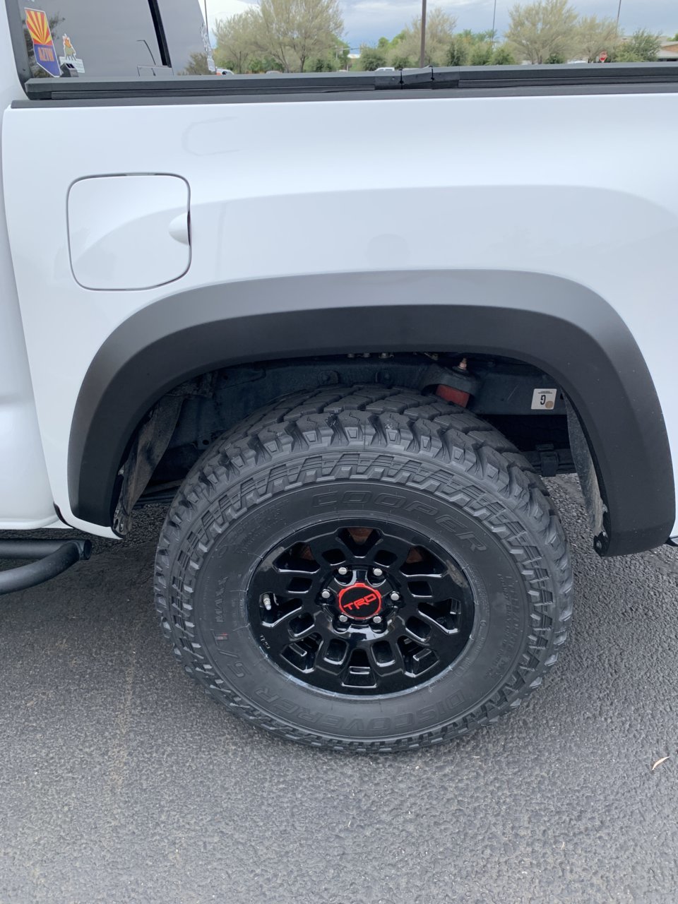

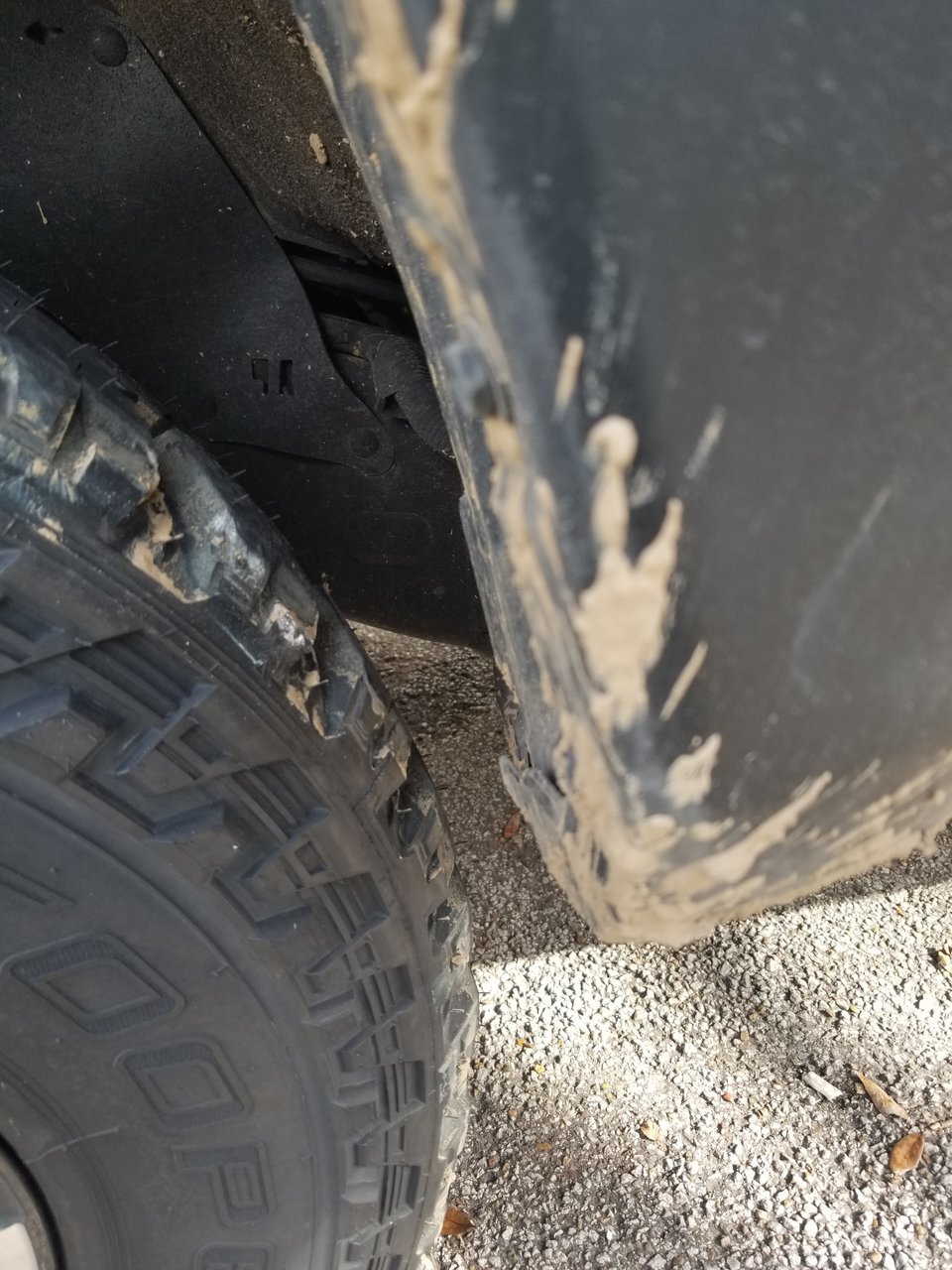

    So I went out this weekend and had to test out the new tires.
    No noticeable rubbing anywhere. Slightly disappointed that I got some small chunks taken out, but thats what the tires are for....
    Pics show the space I had with them.
    And I probably had 150ish pounds of gear and crap in the back...

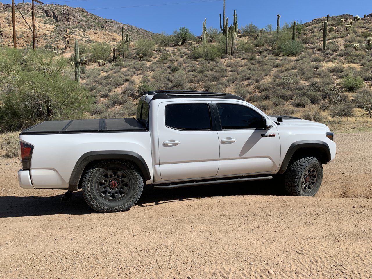

    This an at Maxx on the stock or rims?! I have the same set up with me where near that clearance!

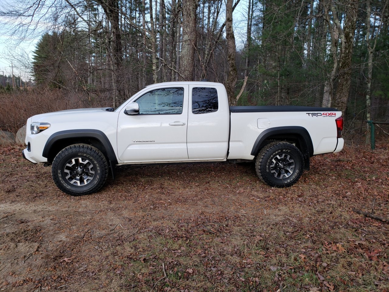

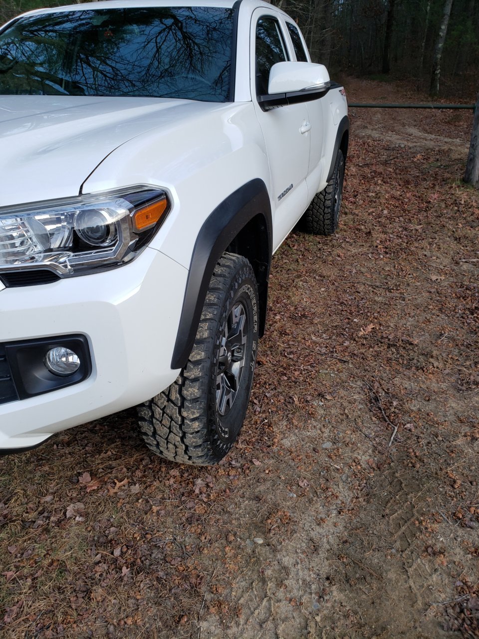

    Pulled the trigger this week on the Cooper S/T Maxx 265x75x16 tires. I do not have any rubbing, fills the wheel well nicely, not noisy, mpg about the same considering 30.6" to 32.1" (5% error) Will post some pictures later.
