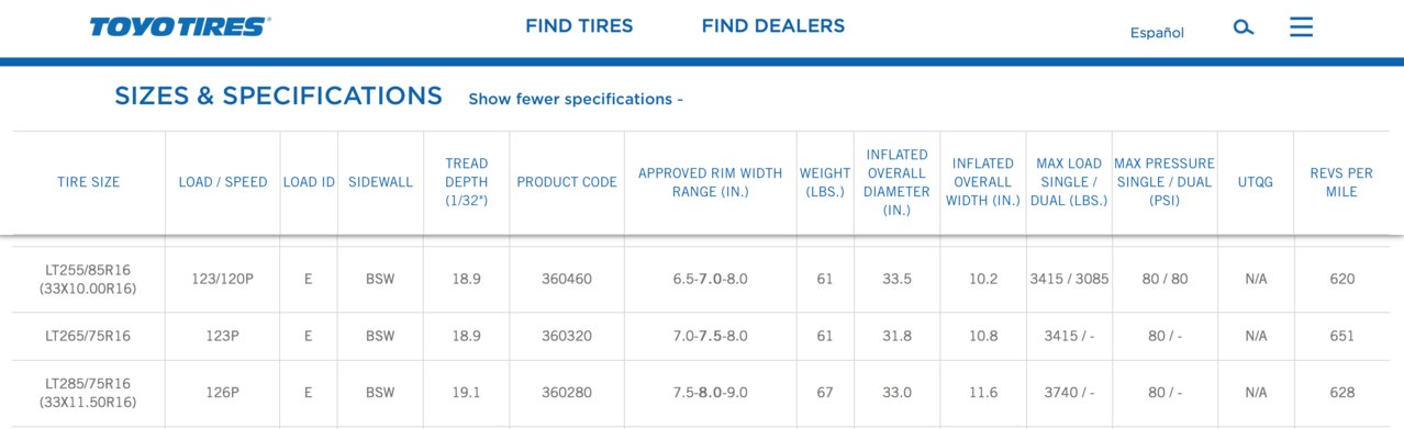

    Hopefully the 2nd gen has the same room as the third.
    Also the toyo he put on is even larger than the km3, the specs say it's 33.5" tall.

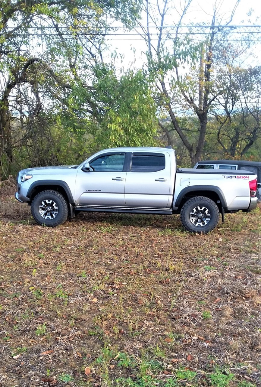

    my 255/85/16s love themtruck hunting (2).jpg
    superdenk and MattCowsmasher like this.
